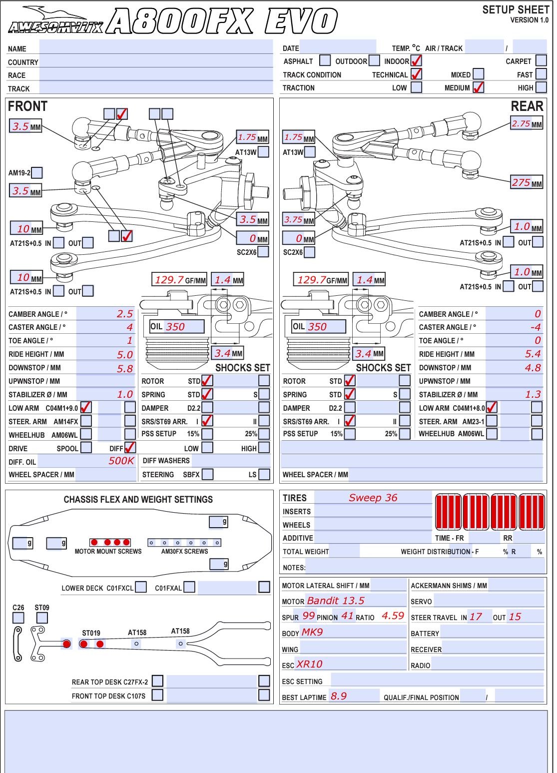

Hello how may I achieve static camber or caster
what should be the first changes to achieve more steering my rear is to planted thanks

Hello,
Please show us your actual setup which you have in your car. Use the editable setup sheet for this and share it with us here.
Otherwise its pretty much impossible to give any recommendation about changes.

Thanks
t
the rest is standard from EVO manual thanks
13,5 blinky can change final ratio, 8m run, 4600 shorty pack
tires not glued

Front and rear same damper/spring setting is not a great idea IMO.
Try softer rear settings for more steering. Also try softer swaybar in rear! The 1,3mm doesn't fit into the AT142 without modification of the part.
Also more rear bumpsteer shims can help to generate more rotation/steering

Front and rear damper/spring setting rear softer
swaybar changed to 1,1mm
rear bumpsteer added 1mm shims
servo horn added 3mm
added C26
With all about changes feeling the car did turn more but lap time improved only 0.05 to achieve 8.92 lap time with 3racing civic body
Then changed to Bittydesign MK9 body lap time 8.68
the car is still stable feels that the rear wheel base is to wide
Want should I test to gain more rotation how should I play with the upper links shins or lower arms shins or what to test, Thanks

  • shift/add your weight ballast more forward (flip battery plugs toward rear of car, if not already)
  • softer oil in diff
  • alternate camber setting Fr vs Rr
