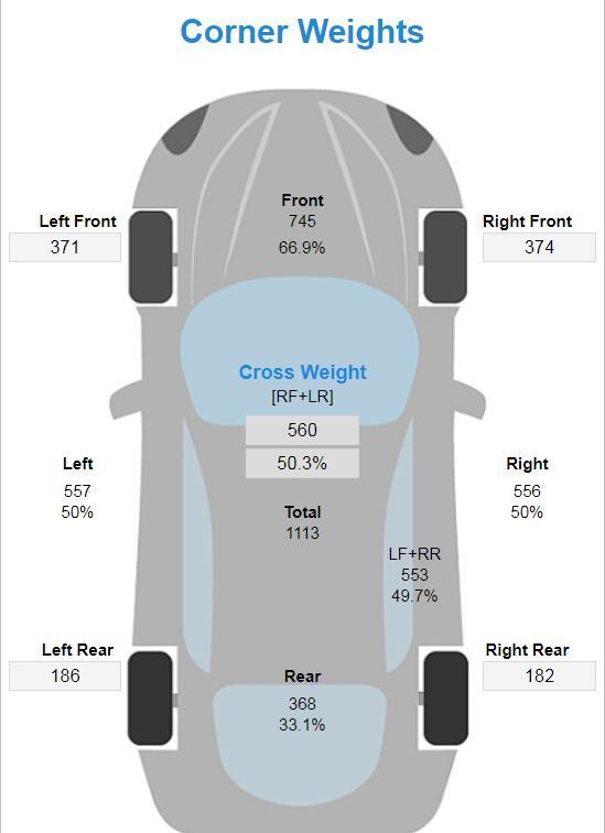

Below is the balance of the A800FX equiped with electronics and kit weights.
As mentioned before, a FWD car need the weigth in front to work, this is not discussable.
The good working balance for any FWD car on any grip levle is between 70/30 and 60/40.
So your points about the balance and advantage during different balance is not correct and also do not match the Awesomatix.
If you would have read the comments before you already would have noticed that this car has same balance front/rear as all other FWD cars existing.
It doesn't mean, because others were not able to design something with same balance but different design, that it's impossible.
The choice of materials and other ways of designing offer different ways to get the same results.
