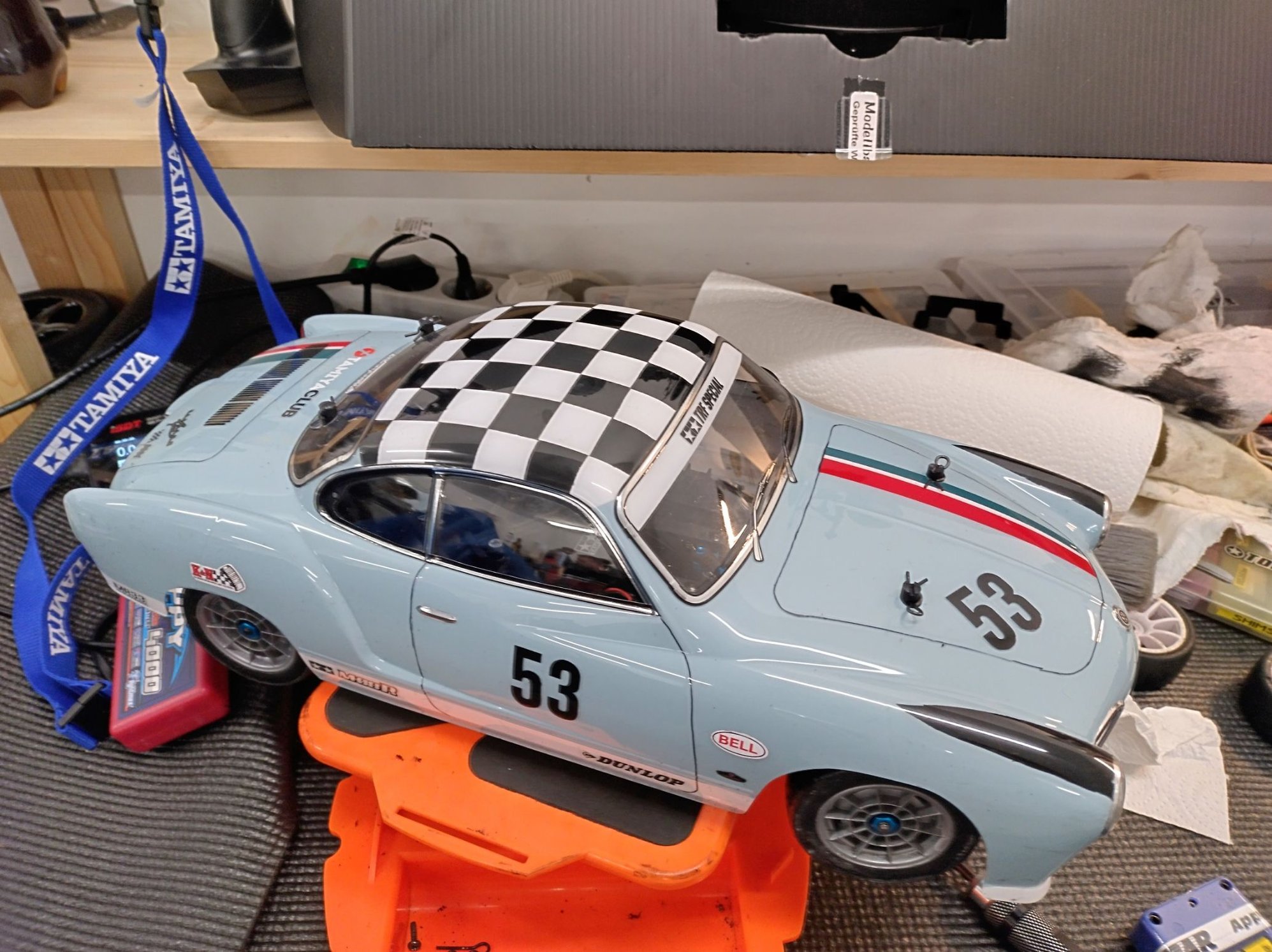

2 weeks ago I entered the second race with my M08 R. Surprisingly to me my last setup from the big indoor track worked also really well in Bad Kissingen, which is a small ETS black carpet track. Temperature of the track was really cold, due to the fact it´s a non heated hall. I could finish 4th overall in the end starting from 4th place. A friend made a small video of the second A-main, maybe you like a little impression of the race. I changed front springs to a weaker one in front for this final, but regretted it already after run in. Car was more lazy in front with more roll and in consequence started to understeer more.
https://www.youtube.com/watch?v=T9MXhS6JLHg
Hope you like it despite the quality of the vid. I run the corsa grey Karmann.
