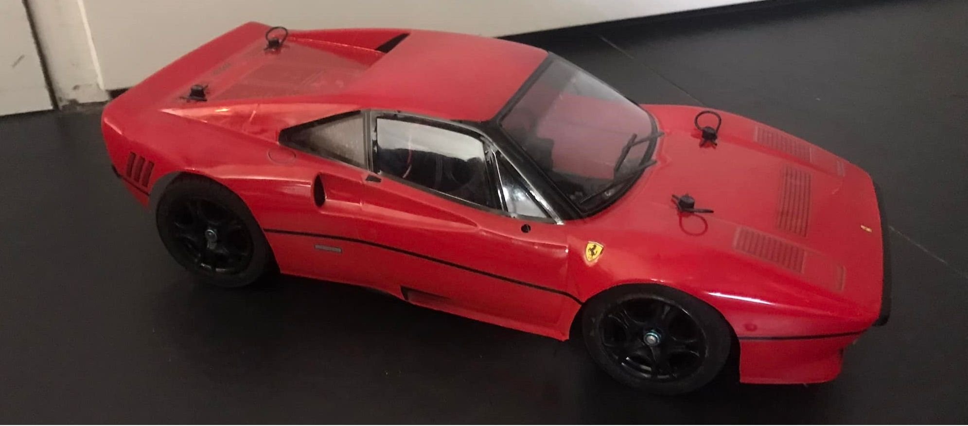

Wanted something different and the Ferrari 288 GTo was the car of my dreams in my youth. So I made it fit.
I modified the wheelbase to be as close to 204mm of the shell as possible (I think I got to about 205mm)
Had to cut the wheel arcs a little bit wider and could have done a slightly cleaner job with that. but overall I am happy with the look.
it fits well and no contact with tires anywhere.
Schs2013 and h2e like this.
Zanquis is offline

Is that they TamTech 1/12 288GTO?
