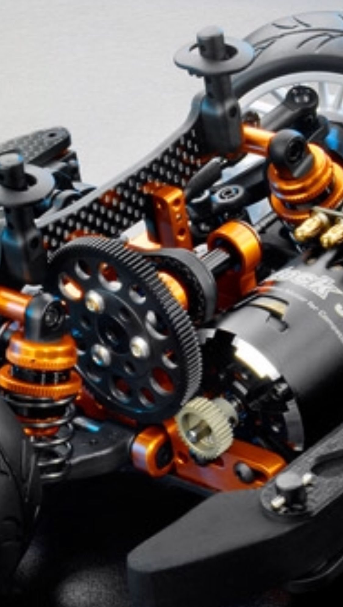

Also the Internal Ratio stated as 2.375? This will not work in 13.5 blinky as I am not sure there will be enough space for 64p gears to get to around 4.09 fdr. any ideas?
The kit comes with a 96T 64dp spur gear.In Germany we run a 5.0 ratio with 13.5 in blinky modus.Next ETS season the FWD class will be introduced.I am going to start building mine on Thursday.😊

if its going to be a 13.5 class then for a 5.0 fdr youll need like a 46t. If the class is like a 21.5 on a large carpet track im afraid to get to like a 3.8 fdr youl be outa luck. Youll need a 58T pinion.

Smallest 64P spur Xray sells is a 90T

Your outa luck for large tracks where your fdr is going to be low due to the high transmission ratio of 2.325. T4 is 1.90. At my local track we have a parking lot onroad track. 21.5 usgt runs a fdr of around 3.80. at the last race I was at it was a indoor carpet on yhe large size. ran 3.87 in 21.5 usgt.
Need to know what class these will be in and what motor will be allowed in that class. I dont see FWD being competitive in a AWD class sucjh as usgt or TC so is ROAR going to come up with a new class? It may have to be at the club level for a while. But dont see this car getting a class for a while.
I may be wrong. Im going to hold out for a bit.
you donít have to use Xray spur. There are many 80s and even 70s spurs.

Non xray spurs in a 70T?
Are they offset? do they fit the xray shaft? are they 64 pitch? I dont run 48 except for my buggies.Most onroad people run 64pitch spurs.

Donít tell me you only use Xray spur on your Xray cars. Who said it has to be off set? 64-pitch of course.

who cares if its offset or not, if it fits it fits. All spur gears available now is pretty much universal, theres absolutely nothing special about the xray spur gears beside the price.

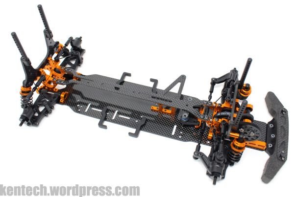

Built the T4F. If you want to see more details of the car:
https://kentech.wordpress.com/2019/0...ay-t4f-fwd-tc/

RW racing sell off set spur gears machined to fit xrayís, down to 80t at 64DP and you can buy 64dp pinions over 60t.
Shouldnít be a problem.
