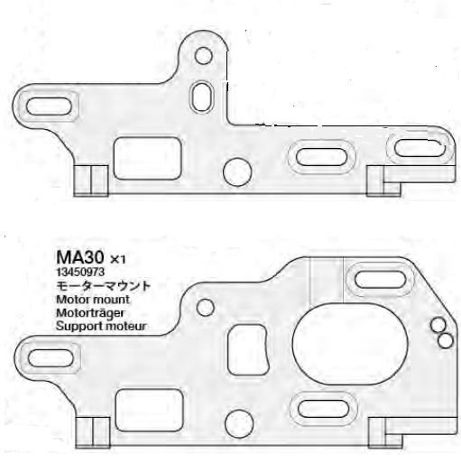

  #150
C van der Hagen's Avatar
Join Date: Oct 2004
Location: The Netherlands
Posts: 267
LCG TA07MS motormount (top) vs original motormount
elbicho likes this.
