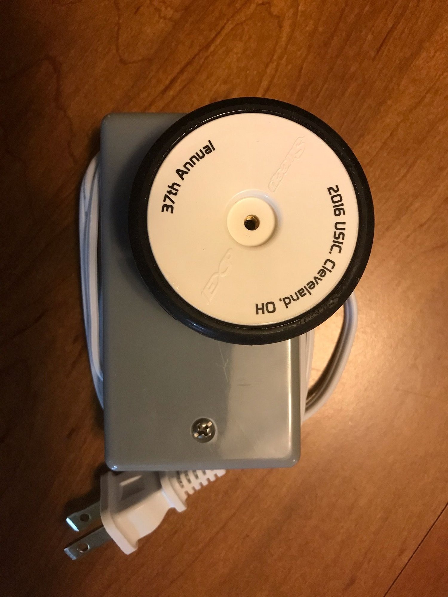

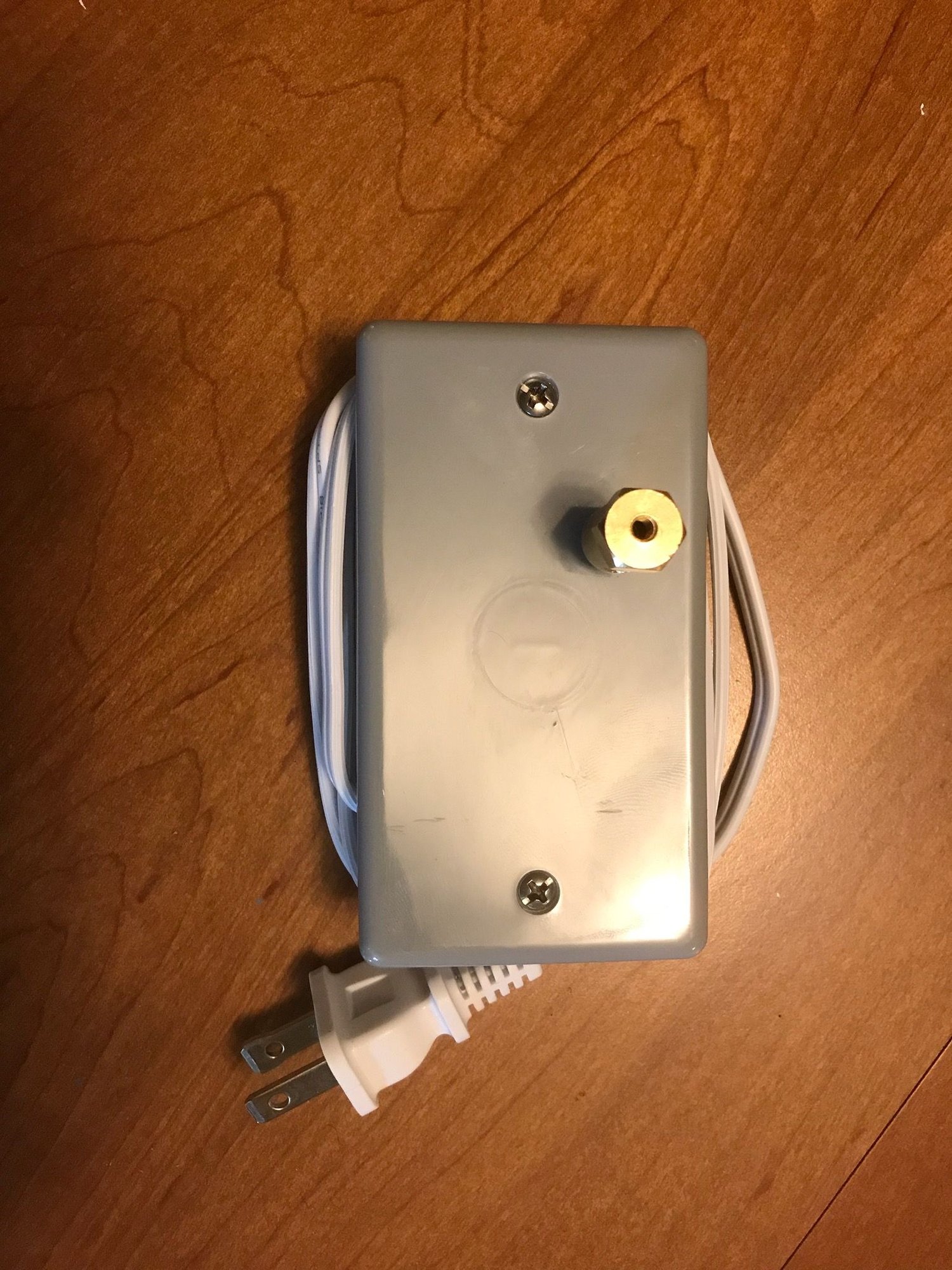

Here is my jig. Total price - $12.89 (plus tax).
Amazon Amazon
(Motor)
https://www.menards.com/main/lightin...roduct=3702122 (Cord)
https://www.menards.com/main/electri...roduct=3611399 (Box)
https://www.menards.com/main/electri...roduct=3614671 (Lid)
Marcos.J likes this.

How do you feel about the RPMs on that setup? I was chatting with a friend who has a box made by Kyle Klingforth, and we were thinking more like 15-20rpm (3-4 seconds per revolution) would be better.
I was also thinking I'd rather have something 12VDC to plug into the power supply, instead of needing an A/C outlet. I've done some looking, and there's some options for 15-30rpm 12VDC motors at closer to a $12-15 price point on amazon. But I haven't pulled the trigger, because it's easier to just let my friend glue my tires for me. xD

RPM's are fine for me. (You could also use a dimmer switch and control the RPM's if you wanted)
I'm sure someone could come up with a solution for a 12V version. I'd rather plug it in and not have to worry about getting to to track and finding out my batteries are dead though.
