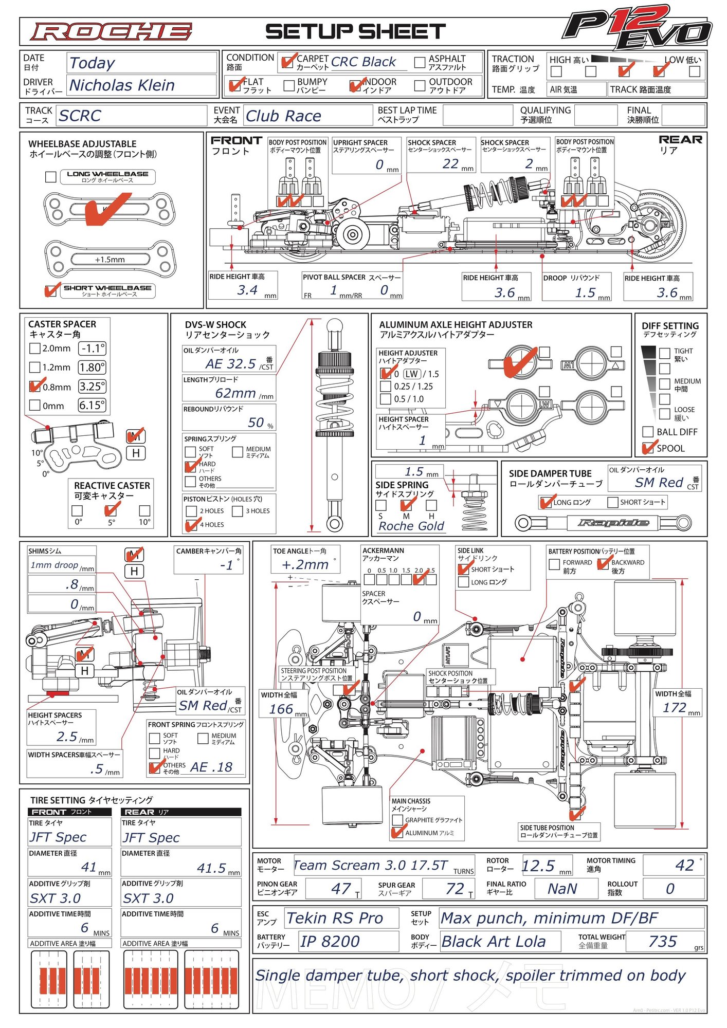

Drop a 22mm post in that vacant hole between the cube and the battery retainer. Remove the extender from the shock. Reduce your droop from 2mm to 1.25 if you're on a smooth track. Move your ackerman to 1.0 or 1.5. Try either Roche white front springs or AE 18 as the Xenon's are a short throw spring. Make your front droop 1.0mm. CRC 45 sides are waaayyy toooo soft, go to Roche White or yellow "touching" if your grip will allow it. Switch to long rear wheelbase, rotates more. When you do all that, you may find you do not want that camber gain for stock. You may want no shims above the steering block and all on top of the eyelet. Yes, you can get the car to carve hard, but you'll scrub the speed at entry too much with a spool. I don't know what SM Red is for tube lube, but if it's close to 15-20k, you should be in the ball park. Keep going stiffer on tube lube until it starts lifting the inside tire, then back down some.

Track is very smooth with medium grip on most days. I'll switch over to the even shorter shock setup with 1.25mm of droop and long wheelbase. I have some AE.18 front springs I'll try. For side springs I have CRC .50, and Roche Gold Mediums on hand.

Thanks for the help Slapmaster6000 and sg1. Attached my starting setup for tomorrow.
