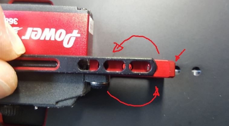

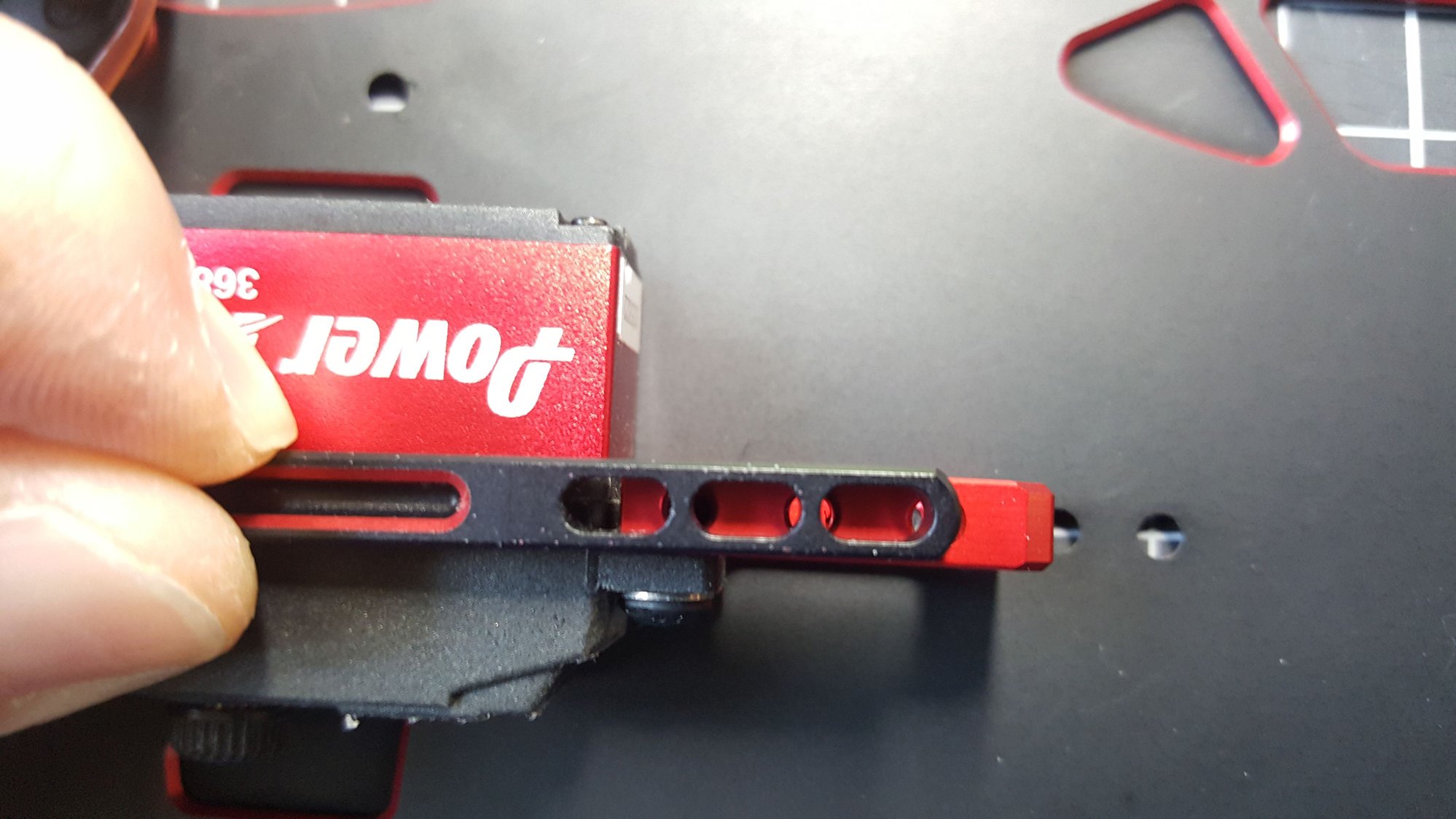

My first build with this brand. Got problem when installing the servo. Couldn't get the servo mount aligned right with the shock mount brace. Would you have some advice on this? Much thanks!

Rotate the rear servo mount brace 180deg.

Join Date: Jan 2007
Posts: 53
With the mount rotated 180, however, the bellcrank gets caught and can't be even back to its original position. May I ask what dimensions of your servos using in this pan car? It says in the manual that servo of 28 - 33mm length can be used. Mine is 35

Is there not a corresponding offset on the bellcrank mount post? Turn it around as well.
mm. May be it's the issue.
How wide is the servo? please measure w/ a caliper.

He would need to use the Servo mounts from the P12 2017 and it fits perfectly and also add a stand-off for the shock from the P12 2017 just will eliminate the evo Servo mount and shock mount

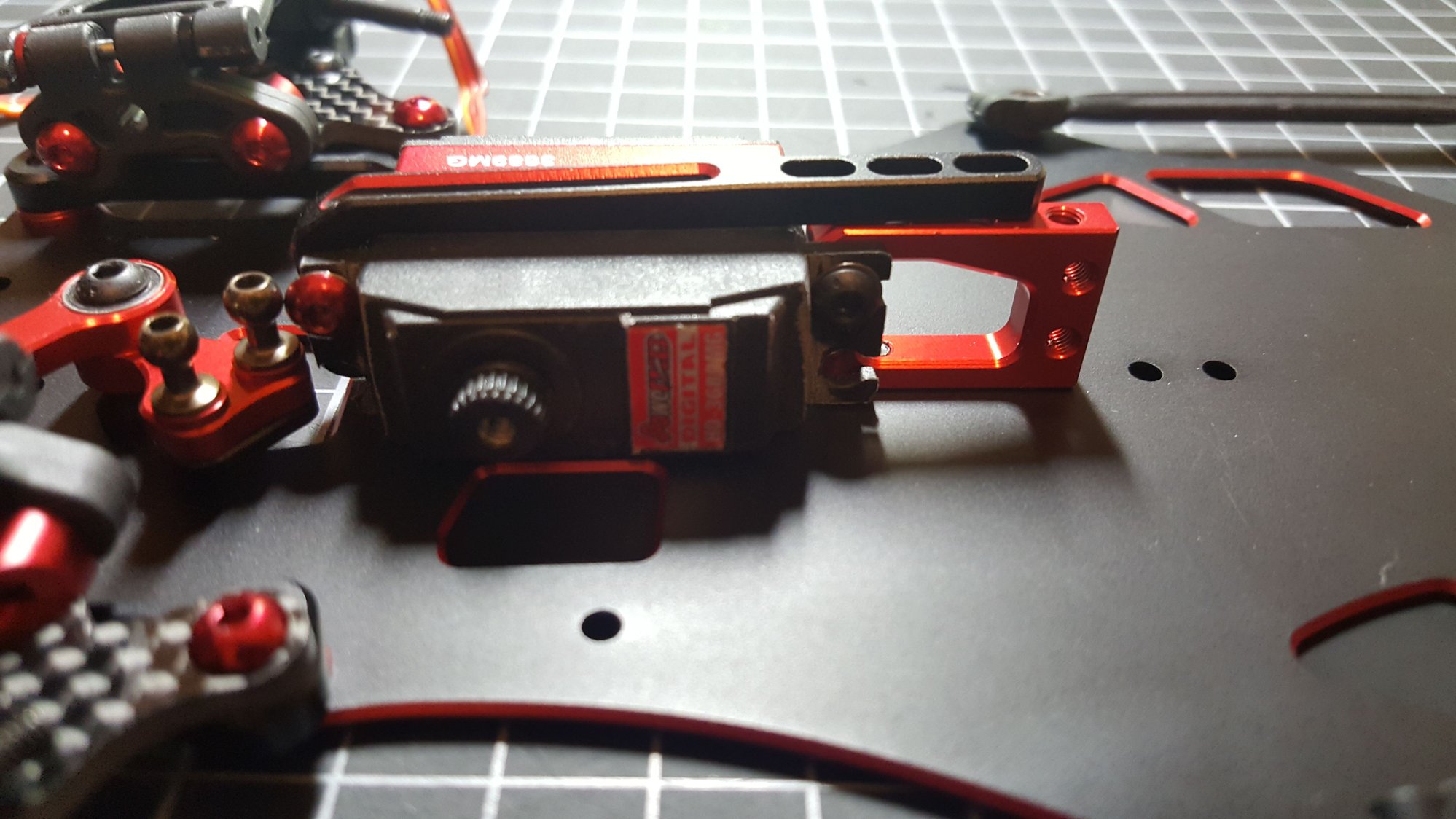

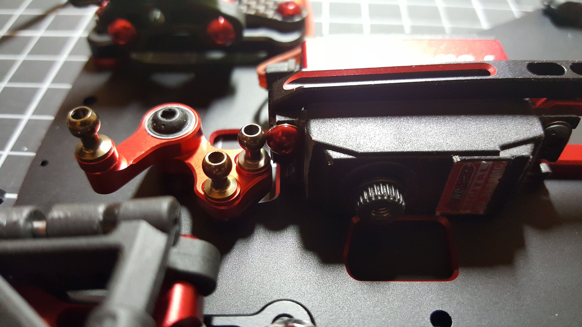

100% amazed by the quality, fit and finish of this kit. I used a xpert mm3302 had to widen the mounting holes on the servo then cut off the front servo ear flush with the mount.
