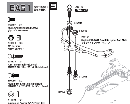

Hello,
I build my P12 evo, stock setup.
I tried to fit the battery but it is touching the shock spring retainer and the nut under the upper pod plate.
Did anyone have the same problem or I missed something?
Thanks

Originally Posted by FSimi
Hello,
Thanks
Make sure that you have the 2mm spacer under the stud on the servo mount.

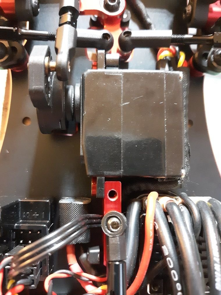

For the record, I was able to fit a Hitec HS-5245MG Digital Metal Gear Mighty Mini Servo on my chassis using a combination of the Roche large and standard servo mounts. I like the combination of specs and cost on this servo.
Price: $40!
Transit time: 0.12 sec/deg @ 6V
Torque: 76 oz/in @ 6V
Weight: 32g (1.12 oz)
Length: 32mm (1.3")
Width: 17mm (0.7")
Height: 31mm (1.2")
JC3 is offline
Hello,
Thank you, but if I put a 2mm spacer under the stud the thread is not long enough to tight the stud
and the battery still not fit under the shock.
Hello,
If you have the servo and pod built properly, the only other reason I can think of is that you have a battery that is not a standard size. I'm not even using the Aluminum Servo Mount and my battery fits with just a 2mm spacer under the ballstud. Here are the dimensions of a standard size battery that should fit: (L) 93mm x (W) 47mm x (H)18.5mm. Make sure that the battery is sitting properly in the chassis brace (see picture below.) The battery shouldn't be anywhere near "the nut under the upper pod plate."
