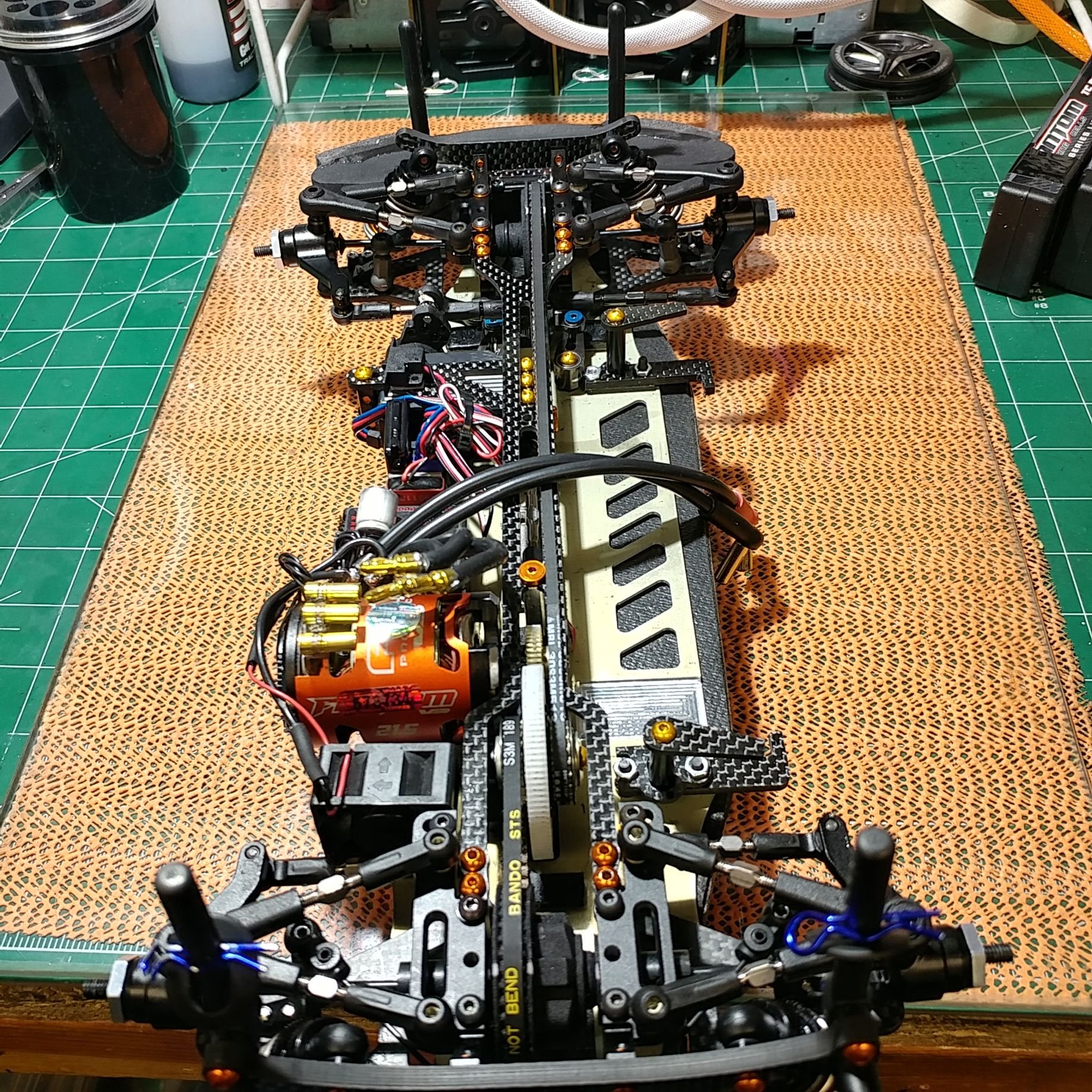

Here is what i did for my car, the long aluminum spacer will work also.
thecaptain is offline

Genesis is all rebuilt for the indoor champs! I gotta work on those reciever wires...
Wow, that belt looks worn-out already.

Your upper front links are different left to right? is that intentional?

  #74

Must be some top secret team driver stuff

whoopass's Avatar
Join Date: Dec 2004
Posts: 299
nah I doubt it lol.
Late night build I reckon....
