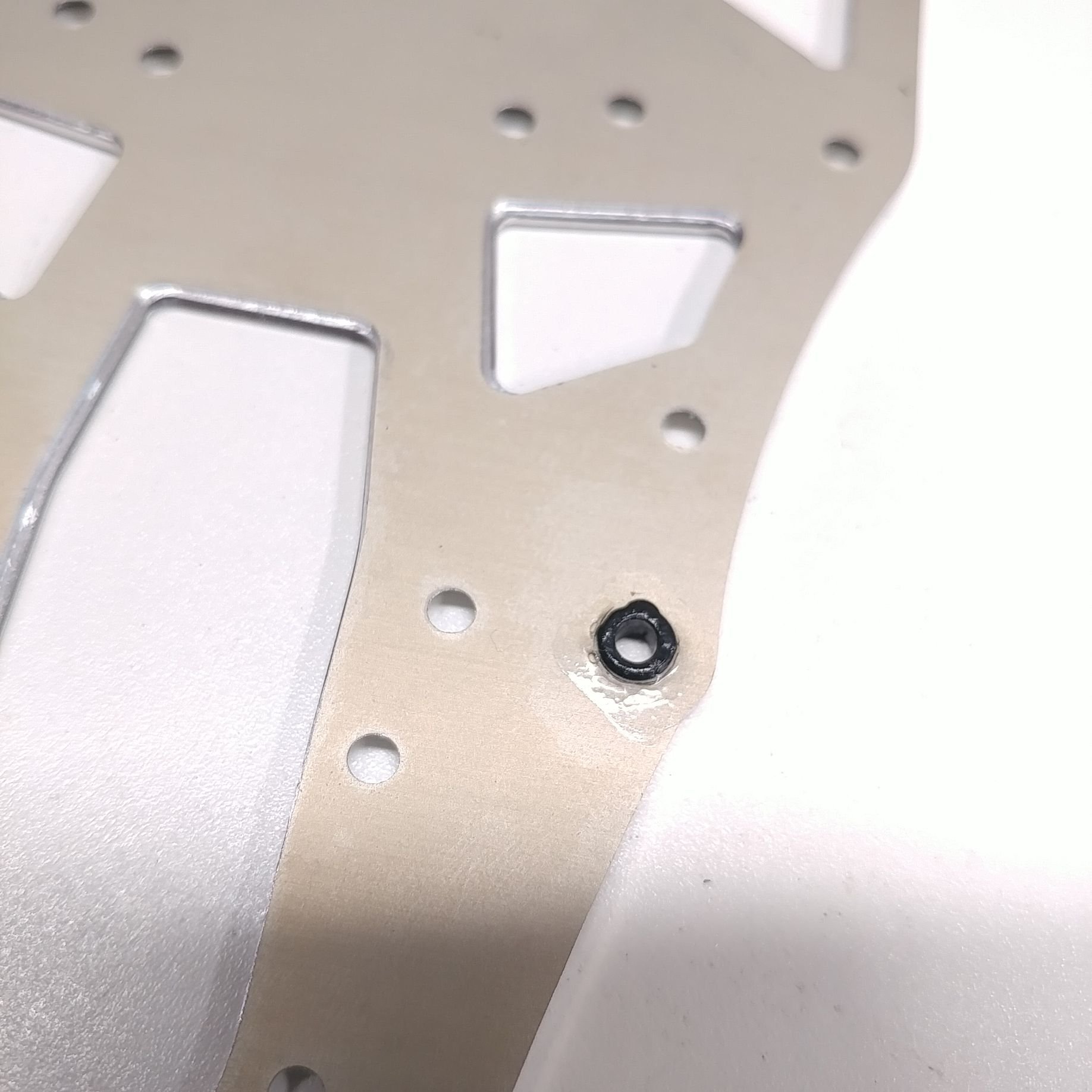

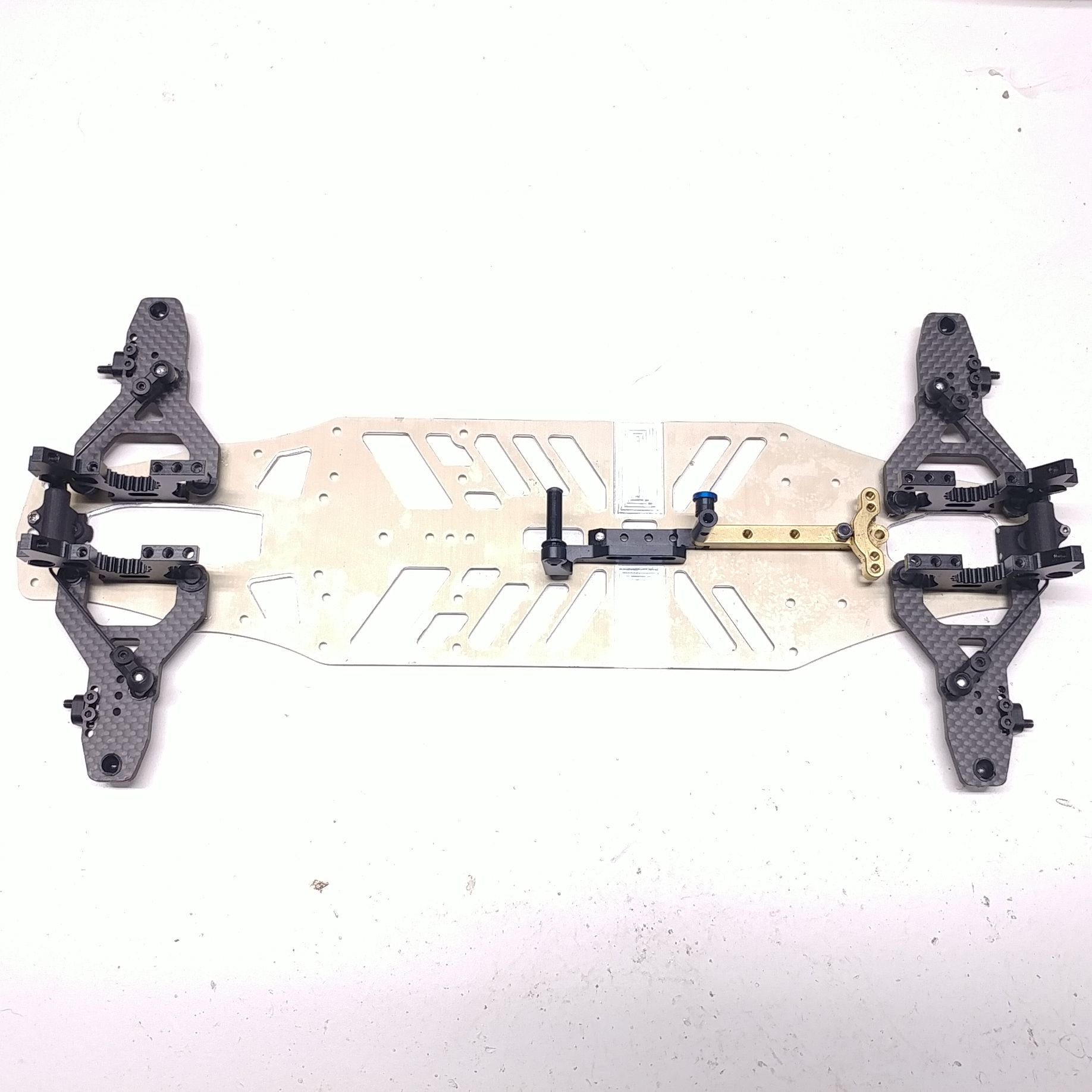

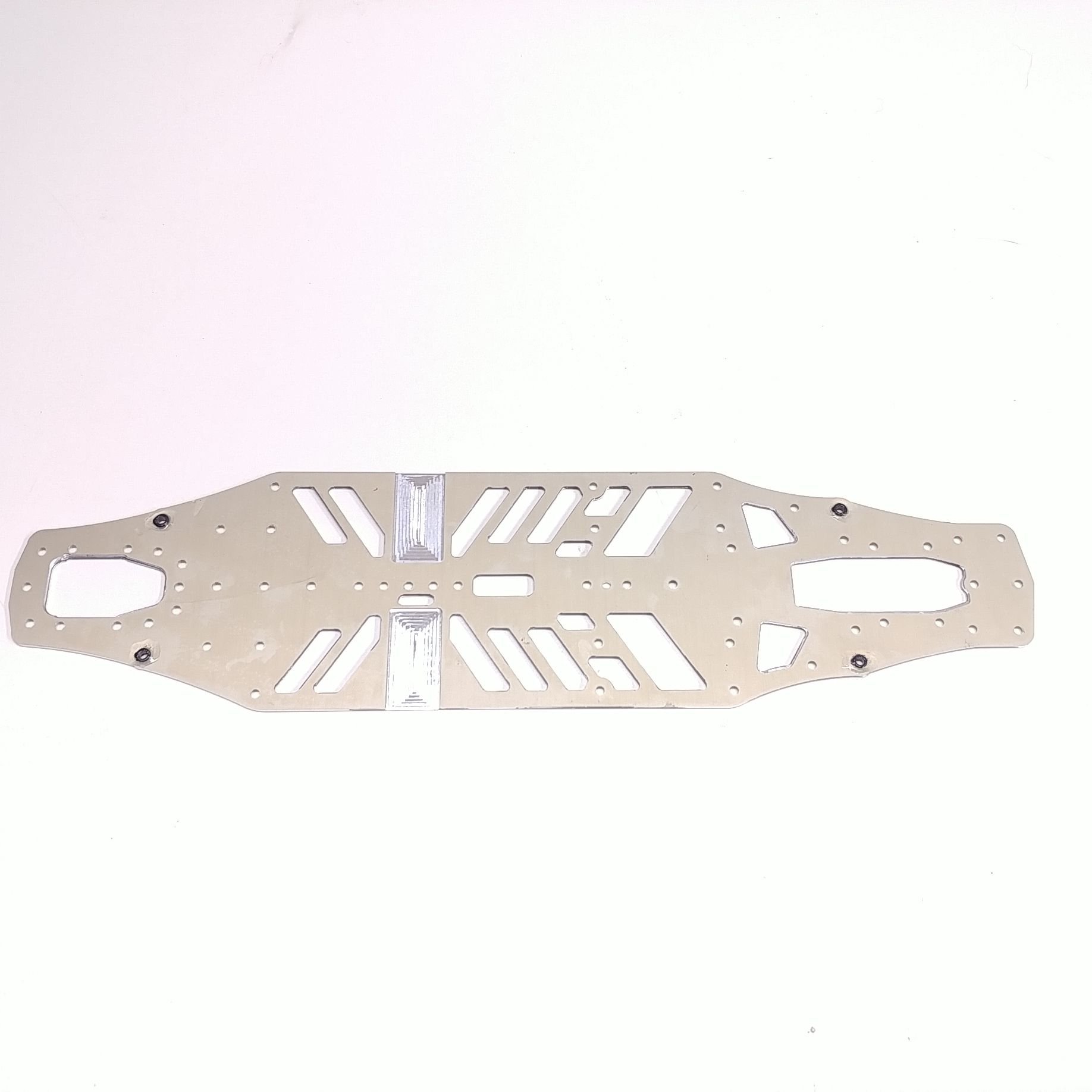

Started the building videos. I am hoping to put them up on YouTube this Sunday. Ill post a link when i get them uploaded. I will also be doing some pictures inbetween videos showing the steps I use to complete the car. Here are the pictures for now. Ill put a link to a drop box folder when im done with the build.

A by the way I am running the steel lower arm ball studs. 8 of these weigh 3.4 grams vs 1.2 grams for the aluminum, the steel also have a broached 2mm head along with the 5.5mm hex. The major difference between the 2 is the height. The steel run about 5.55mm on average and the aluminum 5.8mm on average. So about .25mm on the lower roll center could be a noticeable differences. I will be starting with the 2mm under the arms even, which will lower the roll center marginally, I may increasing it to 2.5mm because I race on such high grip tracks. More testing will need to be done, but something that I did notice thus far.

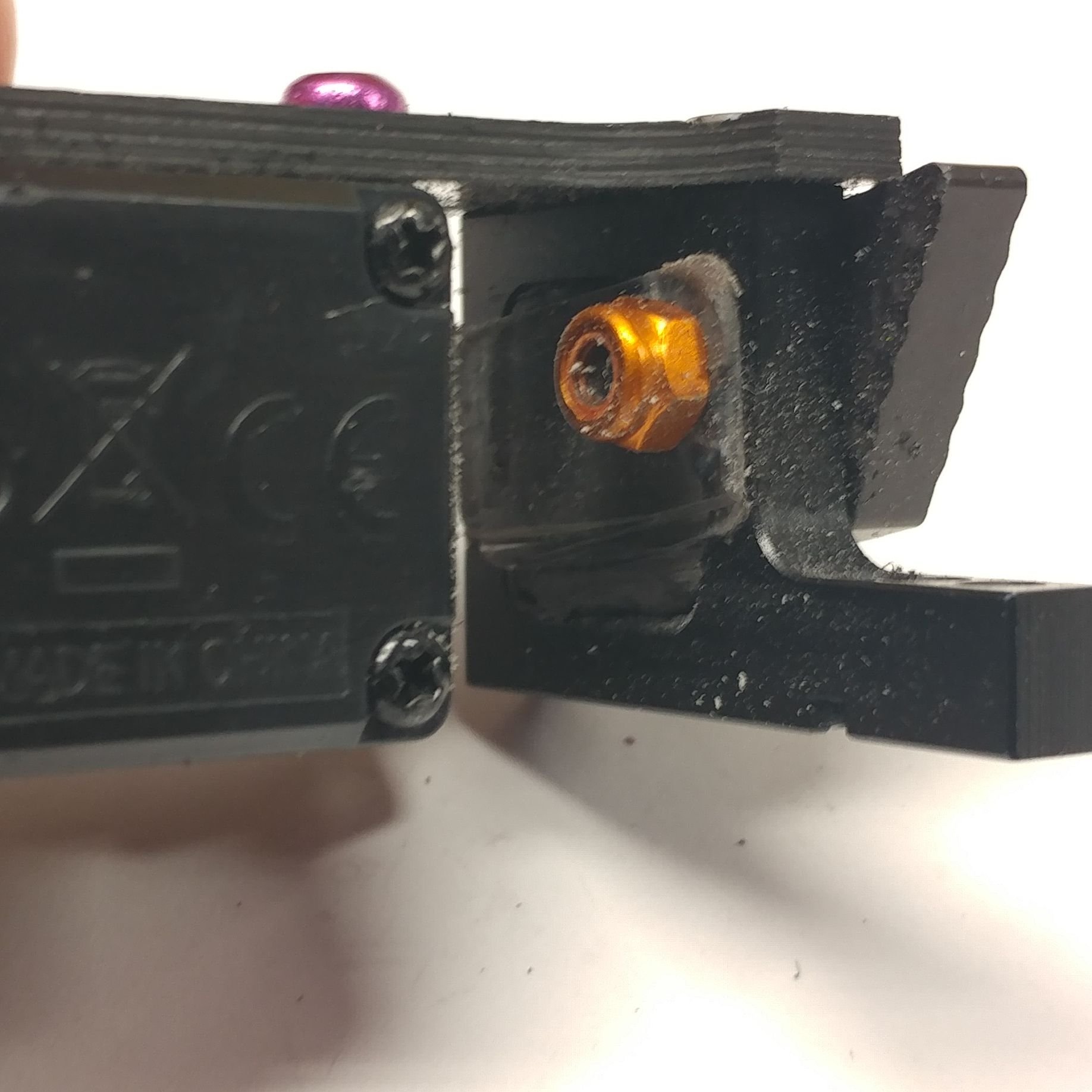

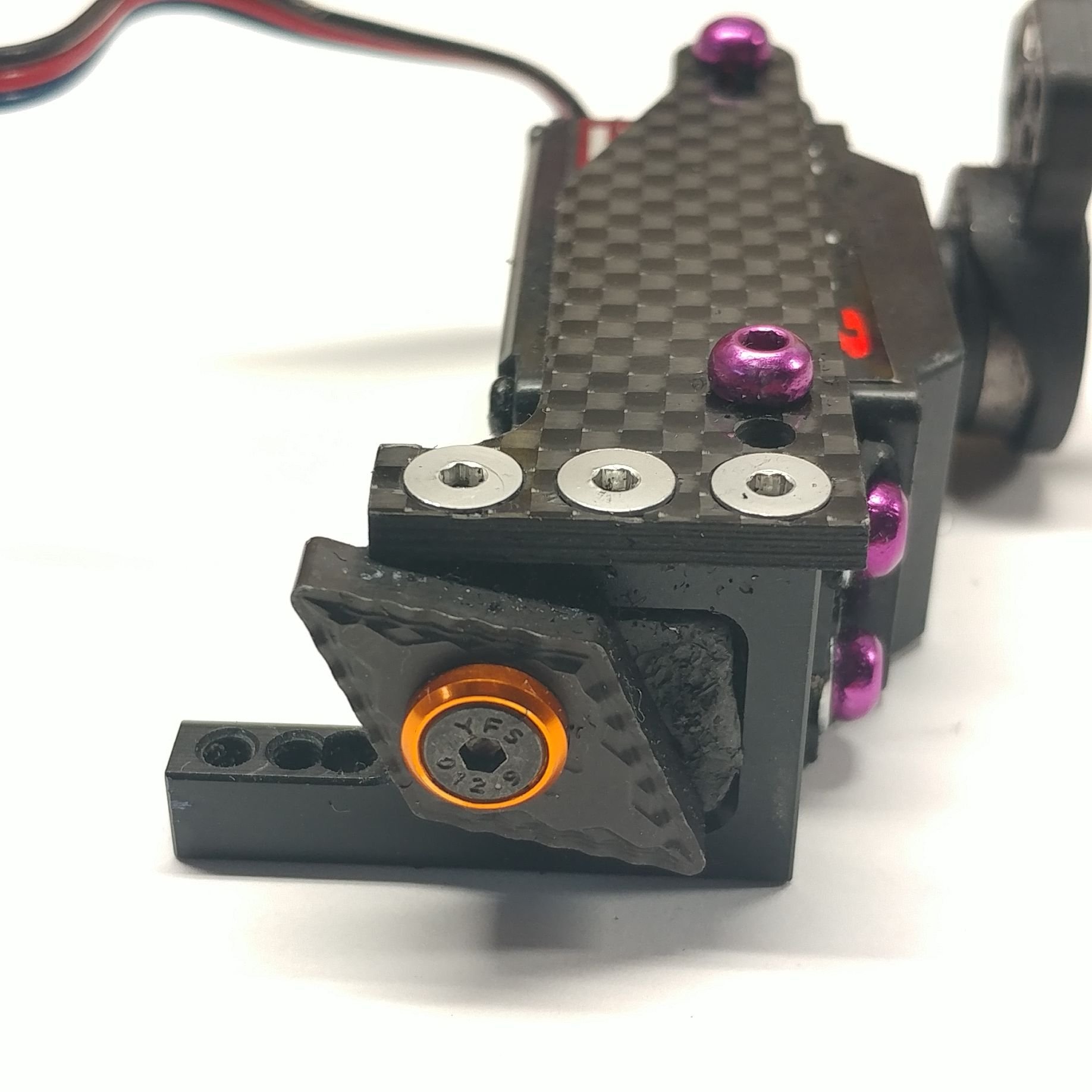

Also attached is how I did my servo. Which I found to be a nice way to add 25 grams in the "center" of the car. If you've put together a mid motor car its difficult to find places to put weight especially in the center of the car. This is a tungsten putty with a plastic shield on the back which together weigh about 11grams, and the tungsten weight on the front is about 14 grams.
I will be leaving my servo offset to help balance the car a little more, I had to add 30 grams to the electronics side last time. Plus I dont have to cut the ear off the servo to make it work.
