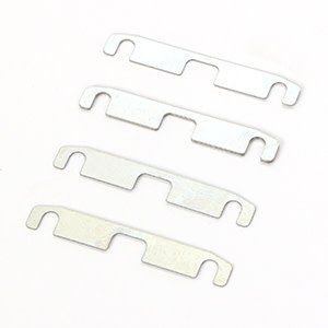

Hey Gizmo guys! I was wondering if this would be awesome to have for raising or lowering the arms? My X20 car has the same style of lower arms as the Gizmo and I had such a crazy hard time putting those tiny shims between the arm and the chassis lol. I thought this would make everyones life easier.

I agree, shims like those are awesome. I have already made some like this. Just have to add them to the gizmo site. We have them in 1.5 and 0.5mm. They make adjusting a whole lot easier and help the chassis become more durable at the same time.
i was planning on making them for the x20 as well
Awesome, I think it is awesome thank you. Let me know when you have them ready. Send me some photos and I will help you spread the word on IG and FB.

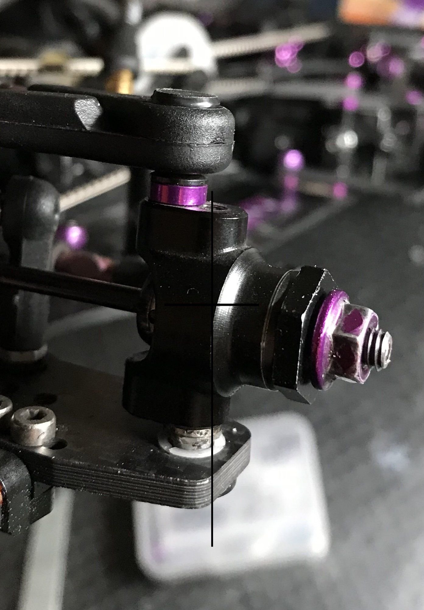

Originally Posted by Marcos.J View Post
ran these on the hubs all day yesterday and they were awesome! Even after some hard hits in the main.
Either on purpose or by accident, you are running the upper inside on the hub and lower outside on the hub. The car might be more predictable if you ran the same inside/outside holes on the hub

Old 02-22-2020, 01:46 PM
  #555
CristianTabush's Avatar
Join Date: Oct 2002
Location: Houston
Posts: 3,163
Trader Rating: 13 (100%+)
Actually, thatís the set up we have all been running since the mid car came out. KPI gives more straight line stability and the angle helps with reduced scrub for more crisp steering. We compensate for a little bit more camber loss with slightly more caster and camber gain.
