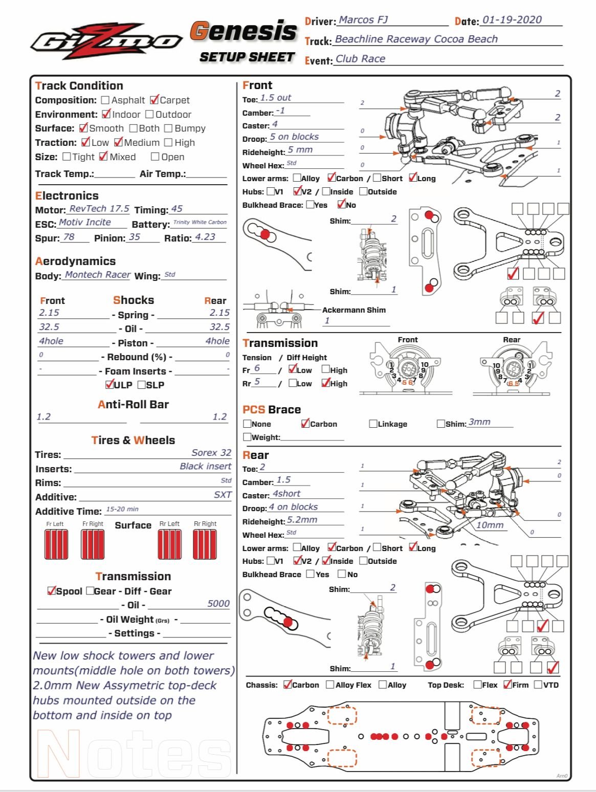

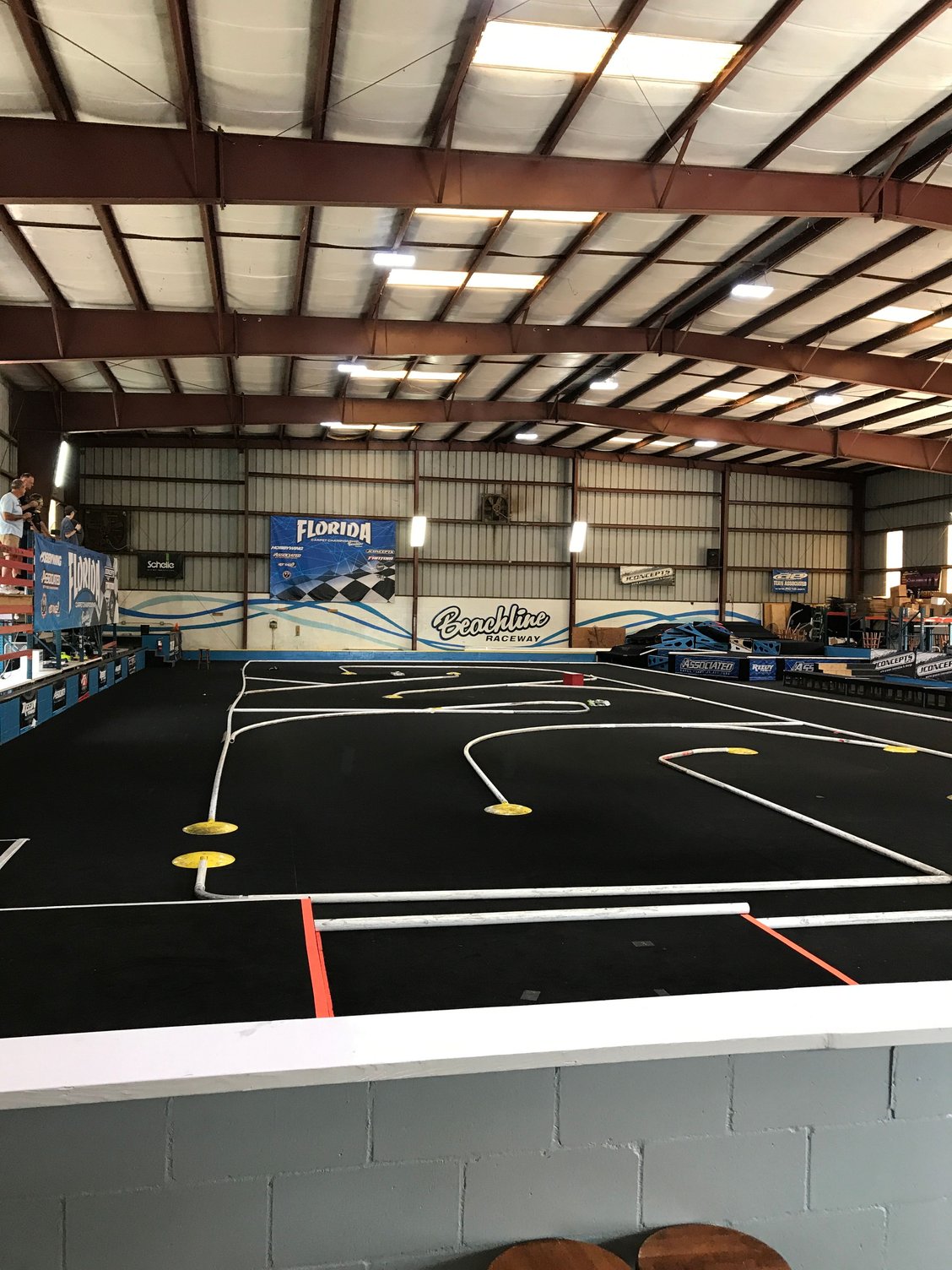

Had a pretty good test day at our indoor CRC carpet track , tried a few of the new top decks that Cristian sent me. so far in carpet the 2.0 mm was the ticket. the track is fairly new and the traction is still low/medium. So i decided to stay with the carbon chassis. The car was very consistent the whole day.ended up qualifying 5th in 17.5 and finished 3rd.

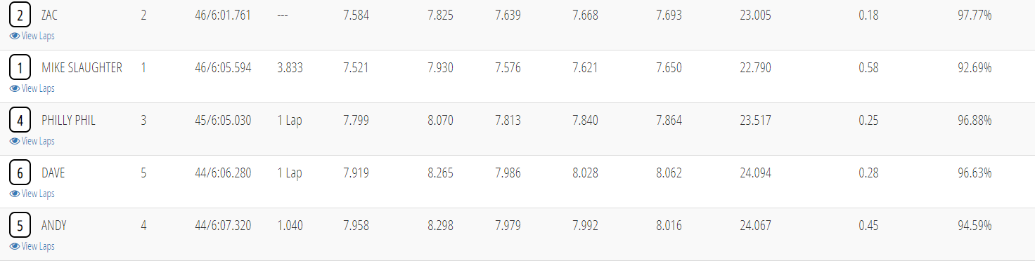

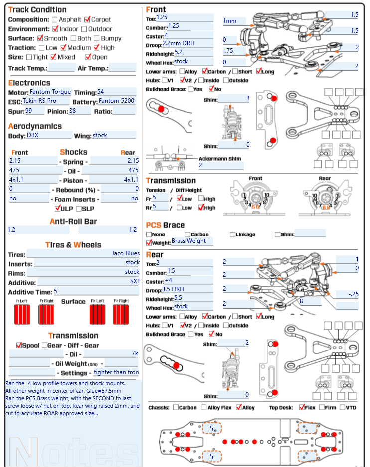

I was finally able to get to the track and run with a high roll center set up. It seems to be REALLY good.
I recently attended the 2020 King of the Road Race, at MRCR. I showed up on Friday, and ran their club program, as well as their Saturday Regional Race. This brought out many of the Local fast guys regionally that did not go to Snowbirds... The track size is 36x60, and is always a great time to race on, I really love the competition you get a smaller track. With that said, if you run on a larger track, and find the attached set up, has too much rotation. I would move the PCS screw to the furthest back position.
While I did not TQ either day, I did win the Regional Race on Saturday. It was a tough weekend of testing and tuning, to get the RIGHT set up. At the end of the weekend I do believe I had the most consistently fast car. If you guys have any questions about the set up, please feel free to ask. I think that this is the set up I am going to take down with me to the 2020 ROAR Nats, at EA's track.
