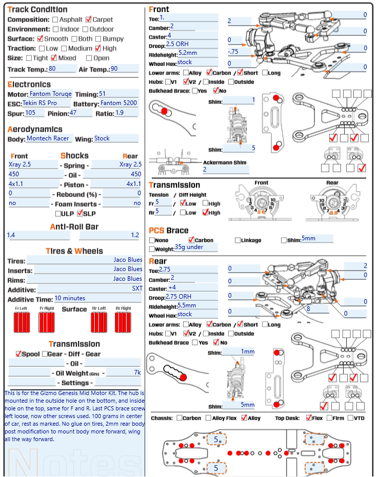

Attached is my mid motor genesis set up, for low bite black carpet. Anyone running the new car at NYGP this next weekend, with the ETS style grey carpet, this may be a great starting point. I did not glue the tires, the car was a bit "tipsy" the first couple of hot laps, especially when the pack was fully charged. After about 5-8 laps I could drive the car as hard as I wanted, and on this particular layout it was reflected in the lap times. I preferred the racer, vs the DBX in stock. However the DBX seemed better in mod, at least for me.
