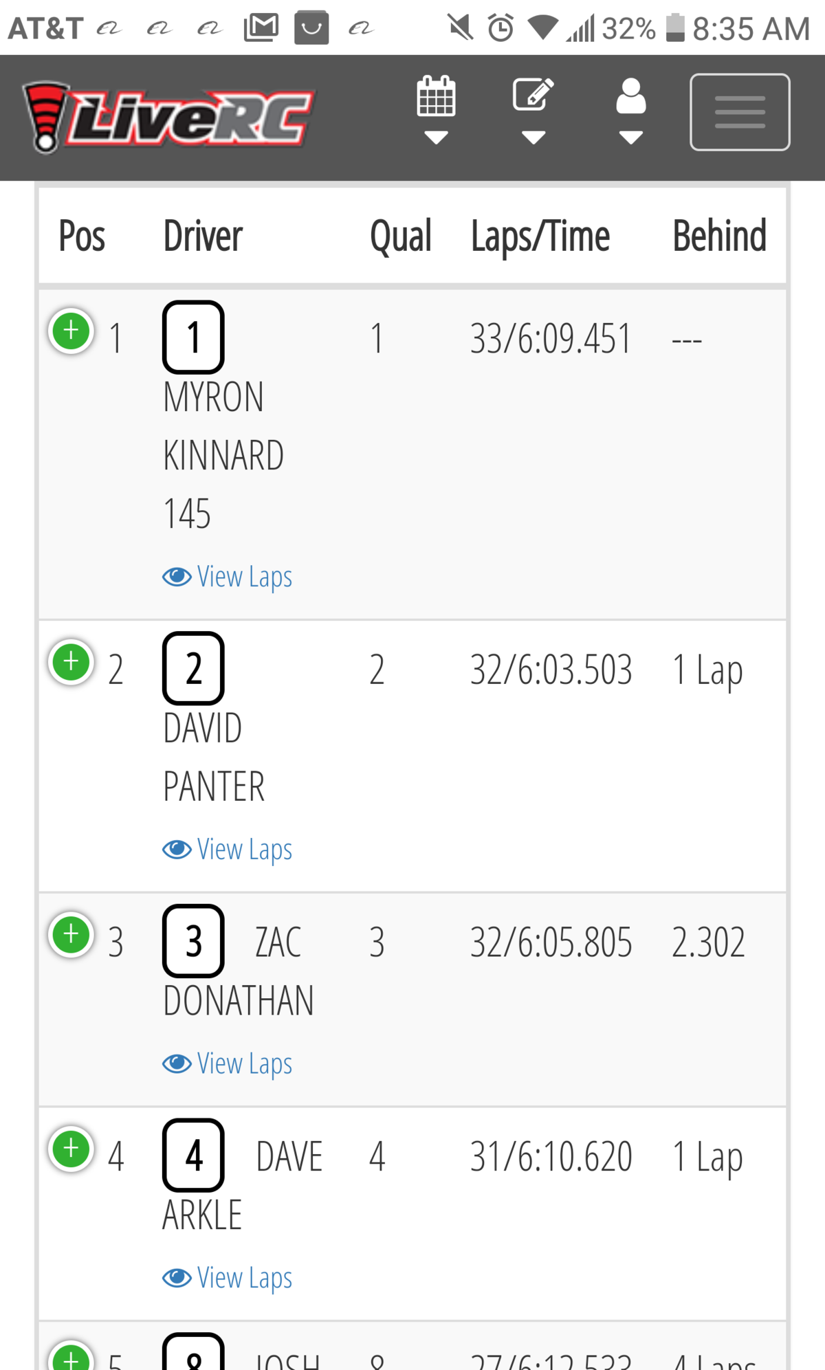

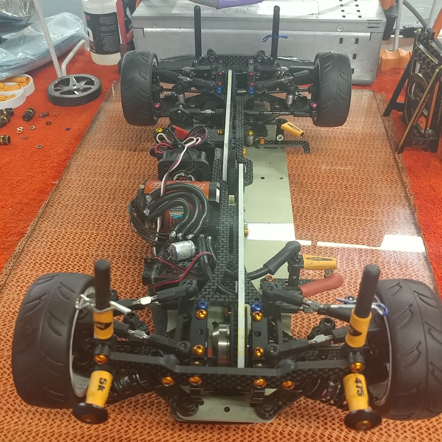

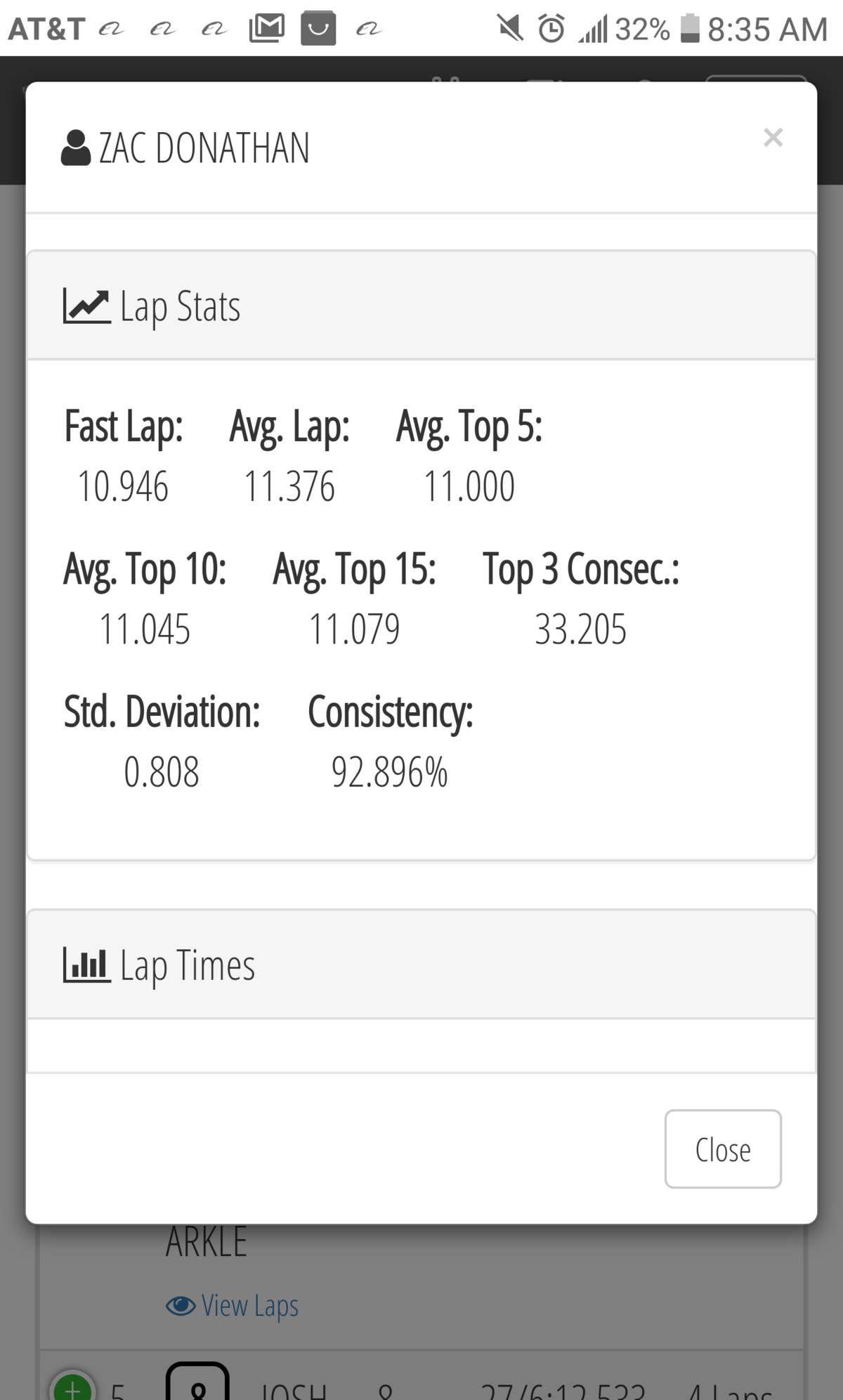

I finally got to shake down the new genesis 2020 kit this weekend, with the laydown shock conversion kit.
The car was down right killer faster yesterday setting some of the fastest laps in USGT, this was practice though. I under estimated how much the grip would come up from practice to race day. I did have some real struggles with the car on race day because od the traction coming up. The car just had too much grip built into it, I was able to take enough out for the main and still have a productive day with the car.
I got one decent qualifer in, which put me third on the grid. The car was good but not as good as it was in practice that morning or yesterday, about .2 slower on average. Only one real driving error in the main would cause me to stay in third. Myron just ran away with it, hes got that car working well!
I have a good base set up for high bite black carpet, for when i come back down in 3 weeks for the Southern Nats. I just need to make it a bit quicker without having that pesky traction rolling issue, haha. I can post the set up if anyone is running on high bite black carpet.
Attached are some pictures of my car/results. It was awesome racing with the guys down at Apex, as always a super nice facility, with tons of nice guys, and of course great competition.

Car looks great. I think with very little time xtra R&D could make for a decent FWD car similar to the Awesomatix.

Thanks. I've had some thoughts about a FWD, but I went a different direction using a GZ2 and a front mounted servo like what Kevin Kreft did on his. The layout allows more centered weight distribution. I did some drawings, but never finished the concept. Much like the other kits, just not enough resources to take upon much more than what is on my table. If we ever find someone to partner up with, that could change though. We have a new 12th scale, New Pro 10, FWD and F1 pretty close to all done, with prototypes of all the cars but a FWD fully operational.

I'm definitely dig'n the symmetrical upper deck on this car and the electrics are still well positioned. This might be the best overall mid spur layout so far.

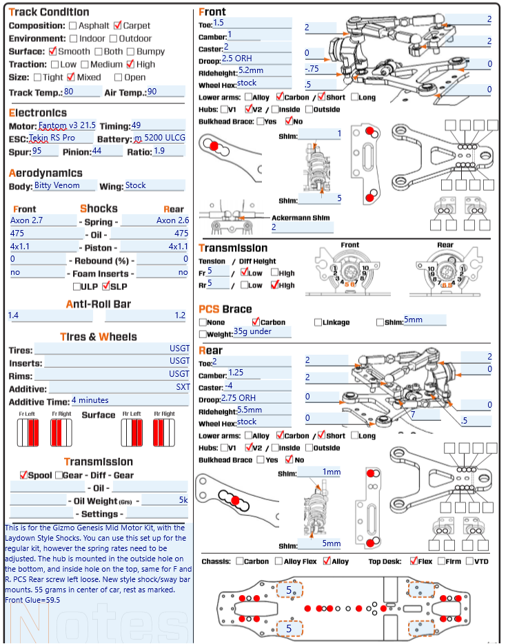

I've been asked for the set up by a few guys, that I ran at Apex. Please note that this is SUPER HIGH BITE black CRC carpet. The next time I go down there, I will be running .5mm under the arms, and 1mm under the inner camber links, and start with the rest of this set up. If youre not running on super high bite carpet I recommend running the previous set up I posted, on this thread.
