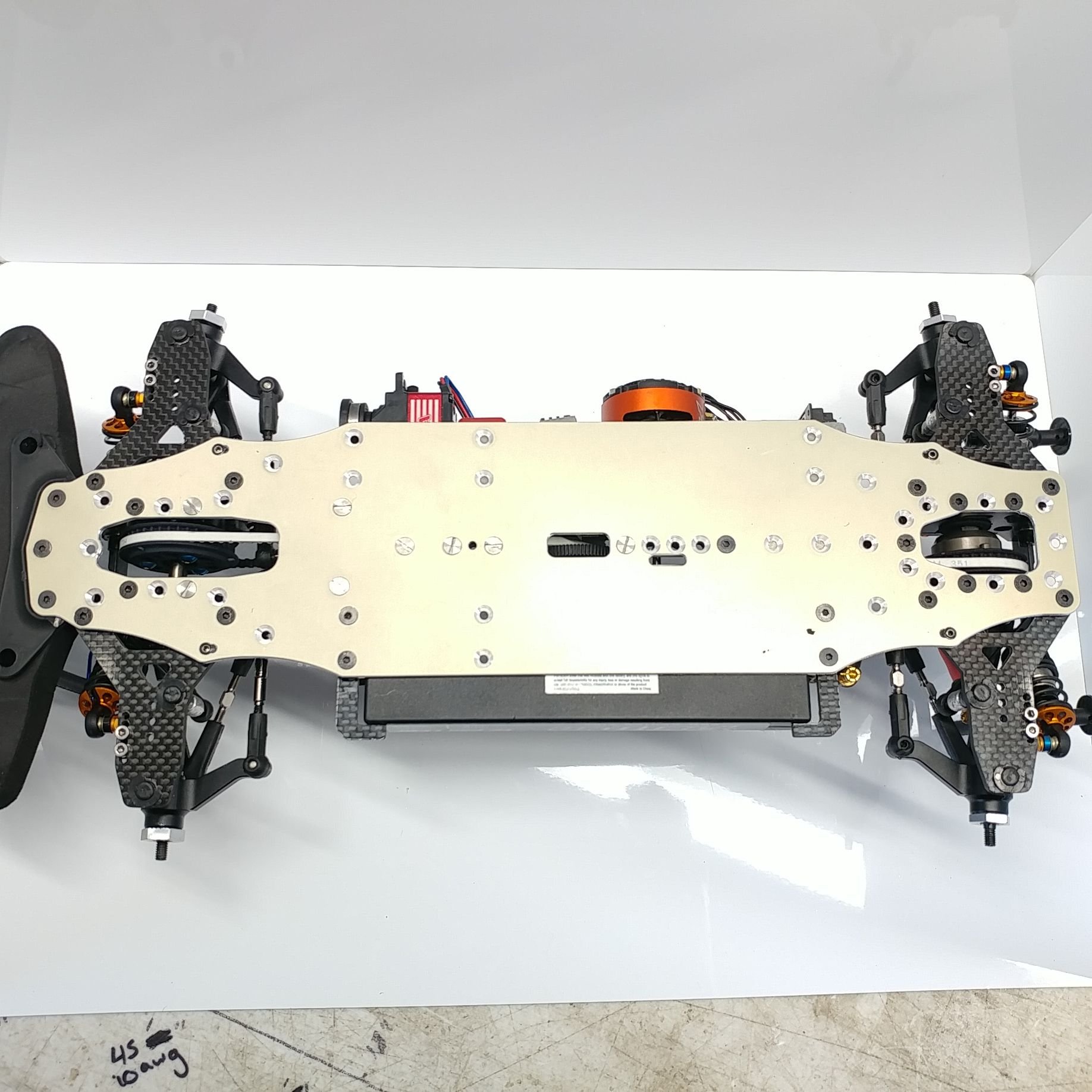

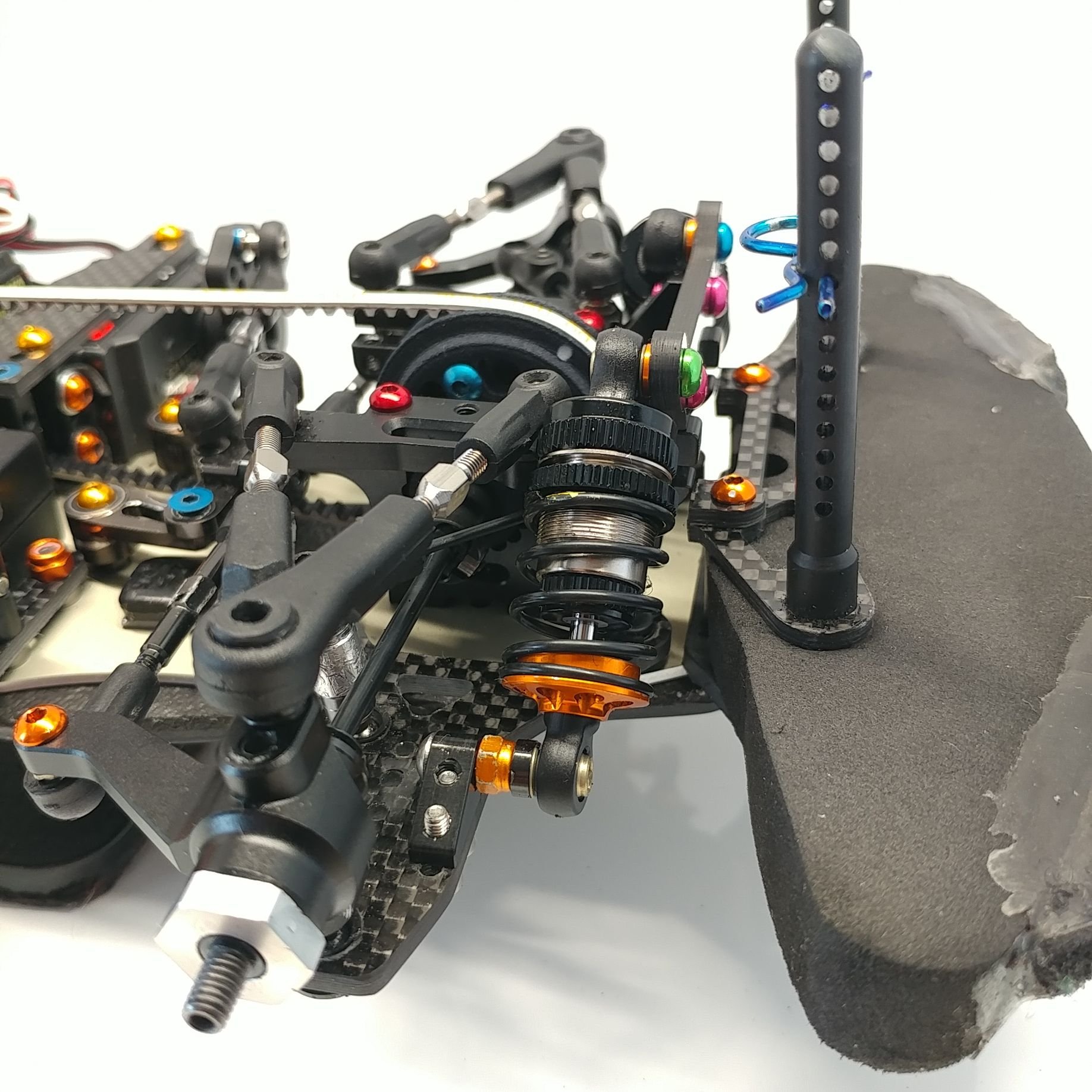

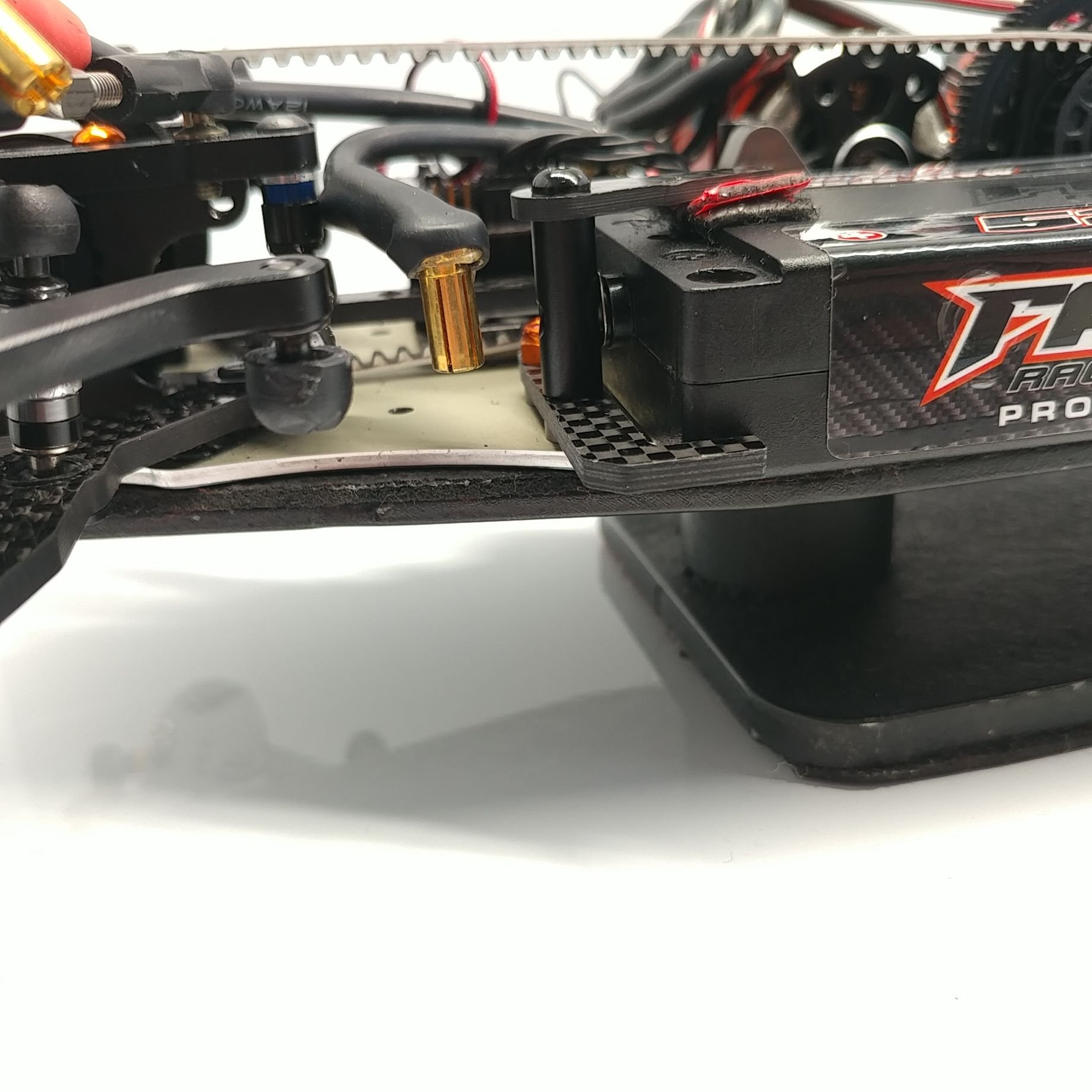

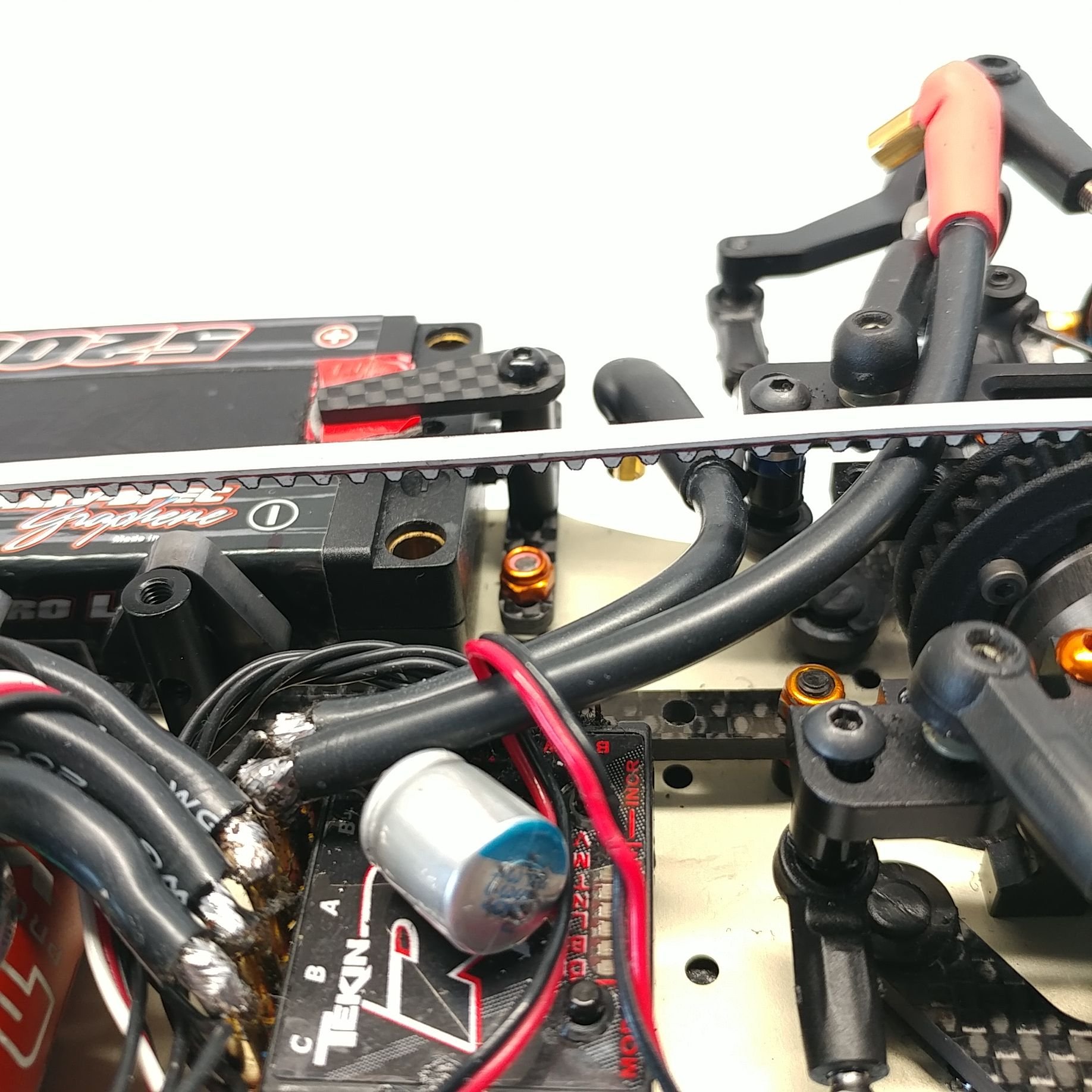

... Back to the mid motor Gizmo Genesis build.
The car went together the best out of any car I've ever built. (Once I figured out how to finagle the top deck on... haha).
The car is completely built, balanced, and has electronics installed. Just need a bit of time on the set up station to finish it up for some track time.
I did end up adding about 100 grams of weight in total, I was able to put it all town the center line, which was nice. (this is with the solid alu chassis, and alu screws on top of the chassis).
I did opt to use the new sway bar mounts, and the new laydown style shock system. Overall SUPER pleased with the build, now I just have to wait 4 weeks to get it on a track...

Originally Posted by DavidNERODease View Post
I would like to see lots of pics of your build
Ill get some pictures today, or tomorrow at the latest.

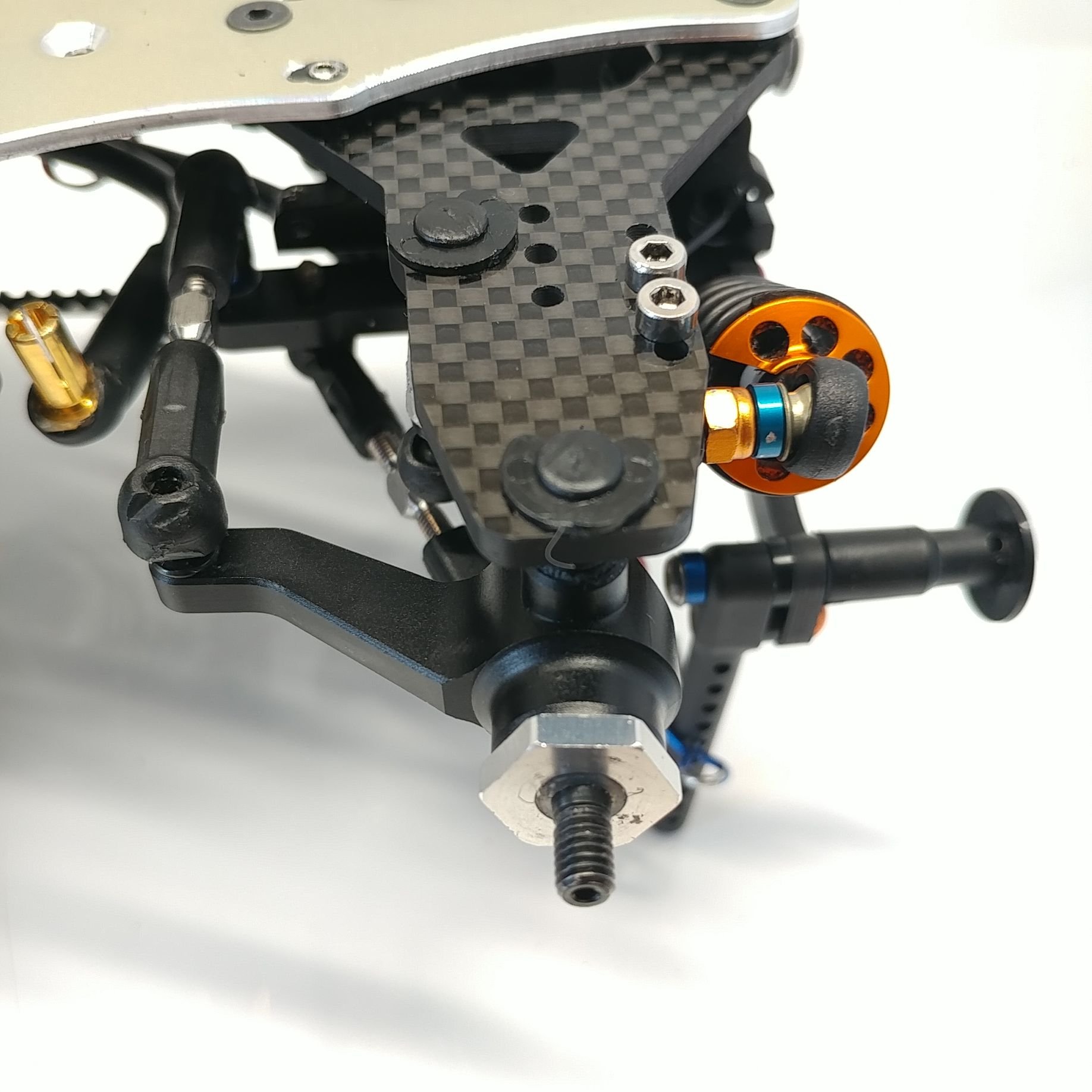

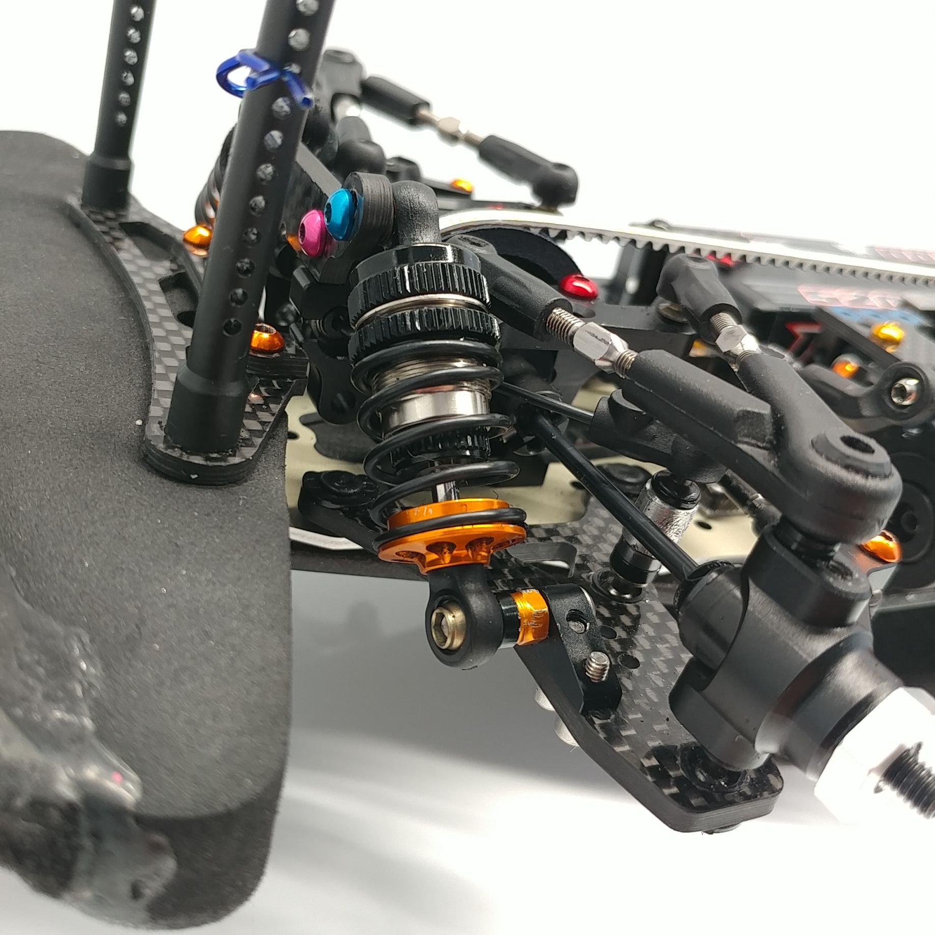

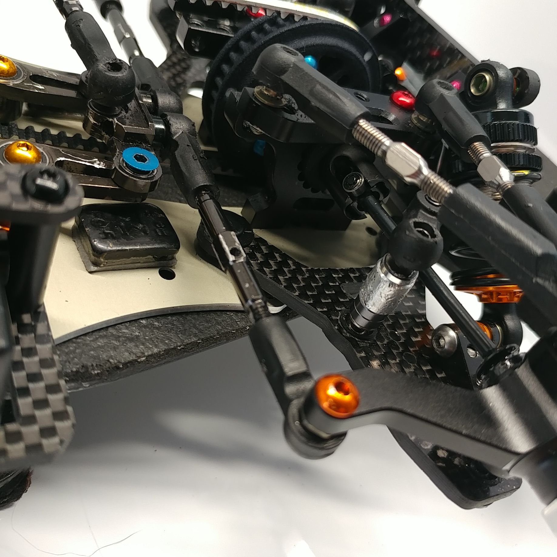

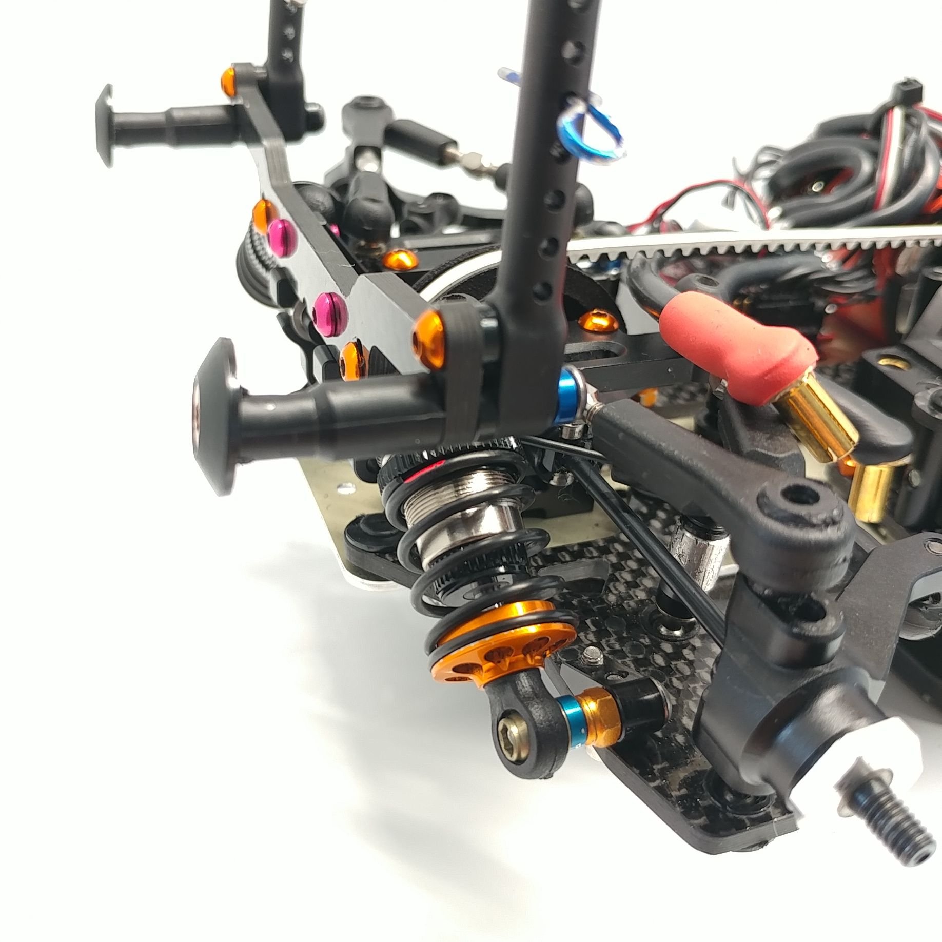

Trader Rating: 176 (100%+)
Youll have to excuse my jelly bean colored car... Ill have all the same colored screws here soon. The new sway bar stand offs will look different than mine, but will have a similar result.
Is running kingpin inclination on the front recommended?
Before with the long arms we were running the ballstuds in the outer hole on the top and bottom. With the new arms, we opted to go with the outer hole on the bottom of the hub, and the top hole on the top of the hub. This is to create a wider track width, and a shorter upper camber link.
Does that answer your question?
