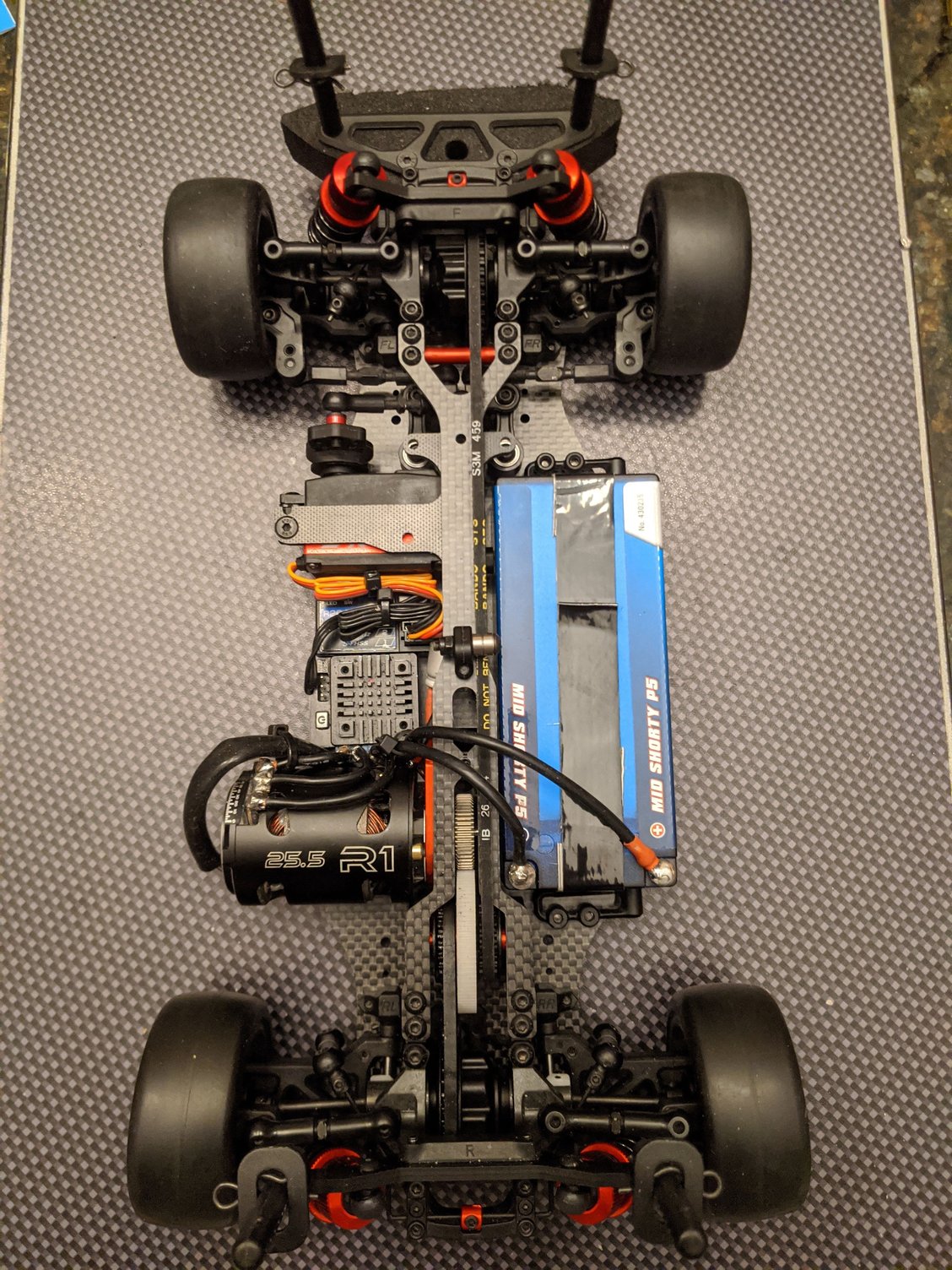

Finally finished the car a year and a half later after buying it. It only took a global pandemic for me to finish it! (225mm wheelbase and LRP mid shorty battery)
I wonder if any of the parts will work on the Top Sabre Mini...
Dan,
which car is this? it looks pretty awesome, very similar to the full size TC. how does it handle compare to the full-size TC?

Dan
iTrader: (63)
Dan's Avatar
Join Date: Oct 2001
Posts: 5,356
Trader Rating: 63 (100%+)
Originally Posted by raytay112 View Post
Dan,
The car is the title of this thread...lol
It has a Susumu 225mm wheelbase conversion. It is more twitchier to drive than full sized TC, but plenty quick on 25.5 power. They have a 239mm wheelbase conversion too that would probably be even more stable at higher power.
Dan,
Other then looking a little smaller. You would never know the difference from the M vs a standard sized TC.
ok...yeah that was pretty dumb, actually never heard of the brand before....hahah thanks for pointing it out!
