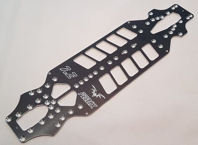

From Fenix Racing...
Flexy'n'sexy for the 7.2
