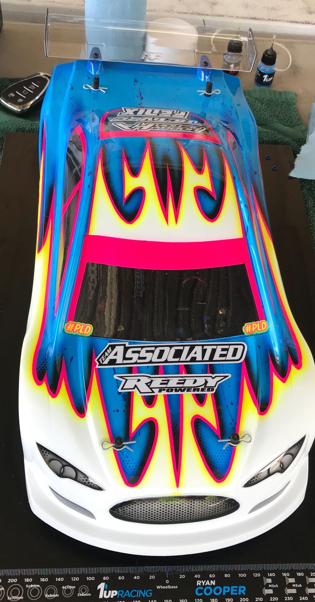

Well... took a little break because of the summer heat and finally got back out to run the 7.2. This is the first time running since reedy last May and I stepped up to the mod game. Typically I run stock, but I figured it was time to jump up at least for local races. Showed up to the track, still needed a couple corrections and a body mounted (due to my poor mechanic skills lol) but car was flawless all day, mod is definitely a different world but can’t wait to get back out there this weekend!
Sure like your "REEDY Power".
