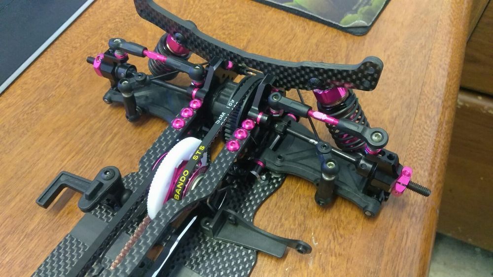

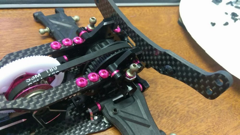

Ok, build time

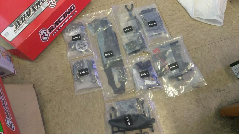

All parts come numbered in order of assembly

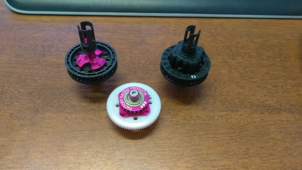

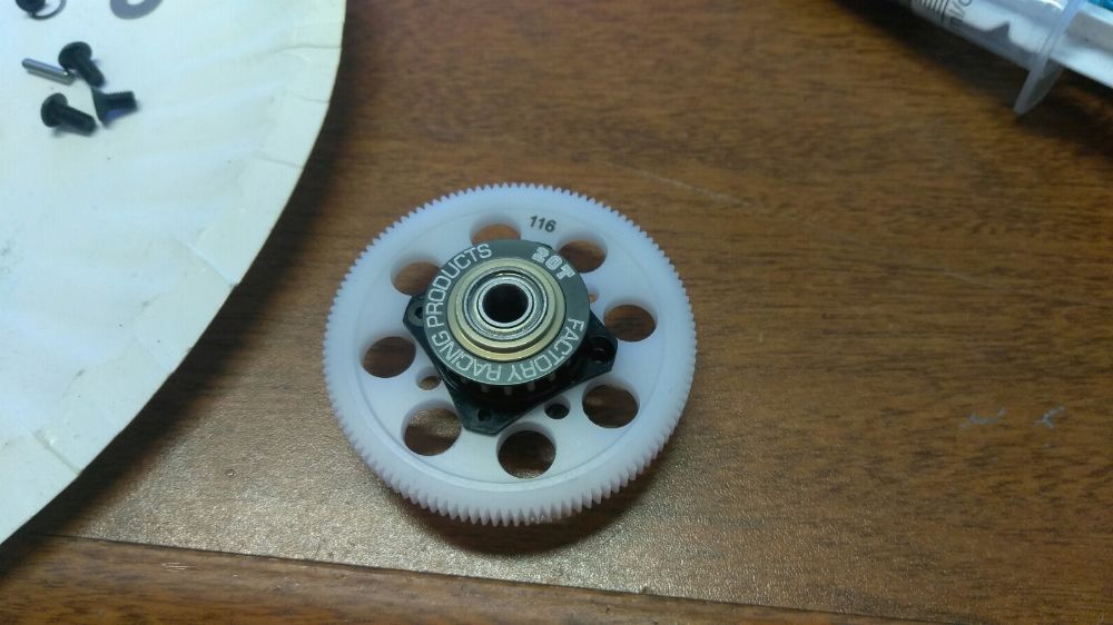

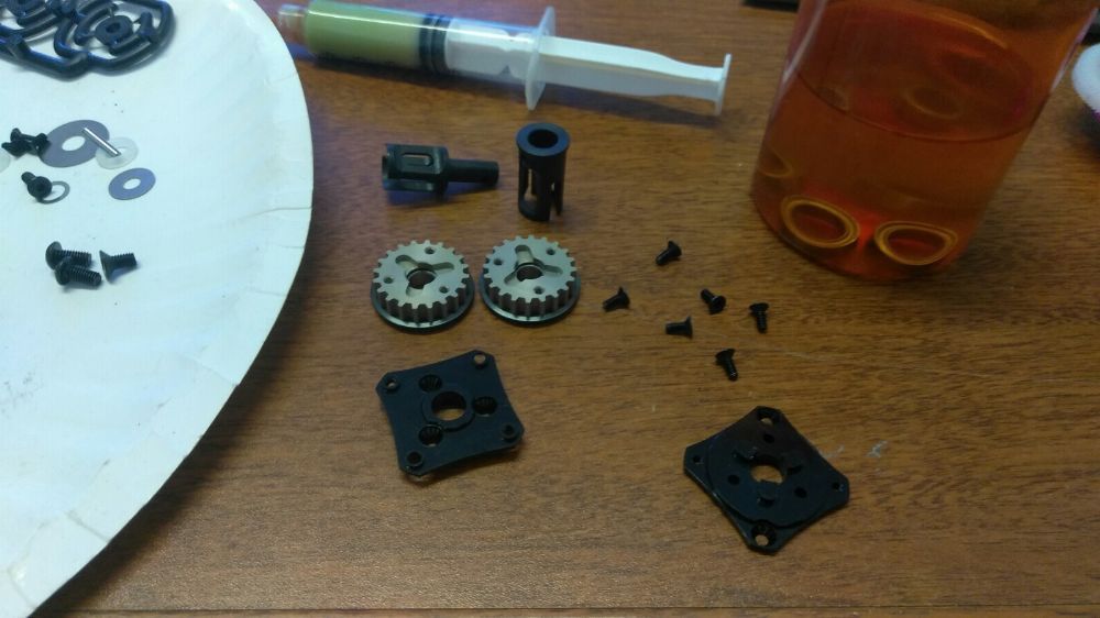

Kit includes a 116 tooth spur, way too big for stock or vta, I went with a 94t 3RAC-SG6494 64 Pitch Spur Gear 94T
Check the screws holding the pulleys together, mine were loose, you can also just remove them for some lower rotating weight. Bearings soaking in grease & wax remover.

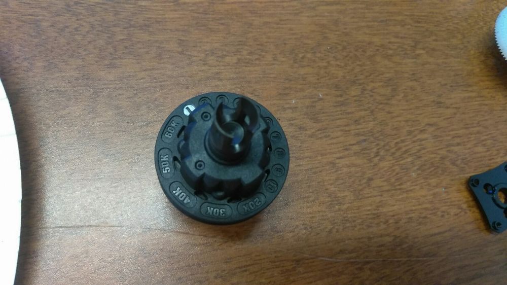

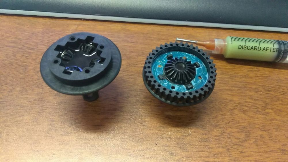

A little SF-3 on the gasket helps seal the diff, diff case has molded in oil weights, easy to remember what you put in
I'm building mine with as much pink as I can, kit comes black. Diff, spool and pulley ready to go.

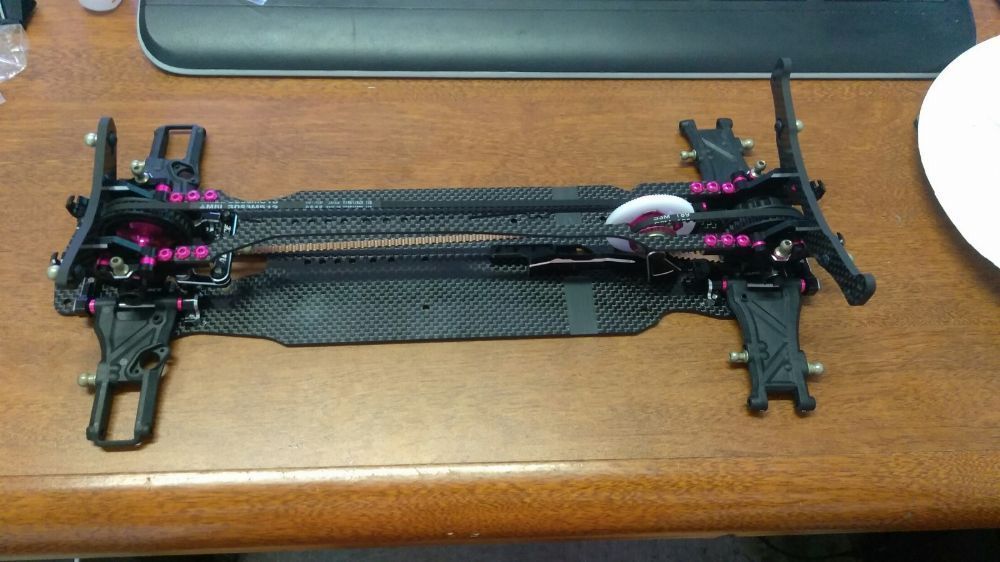

Time to start building the chassis

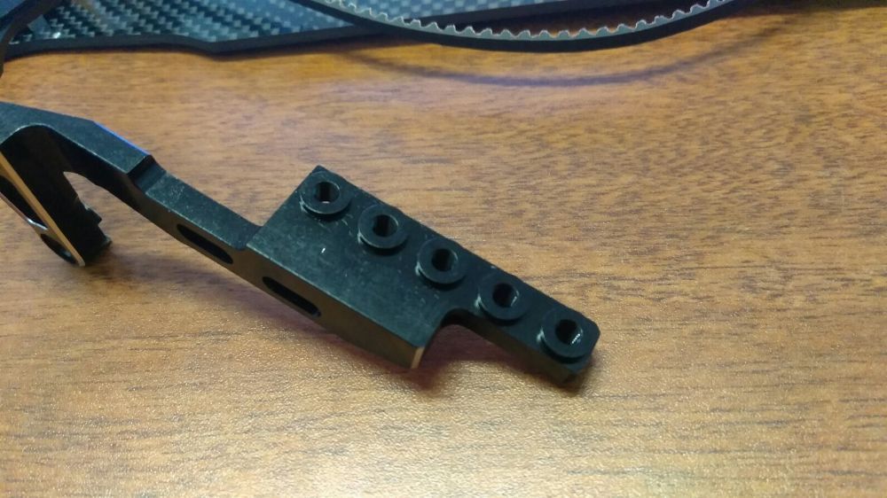

Adjusting the chassis flex is easy with multiple screw locations on the motor mount.
Done with Bag 3
Kit is everything I expected, fit and finish is perfect, even the crappy screws from older kits are better.
moparSRT is offline

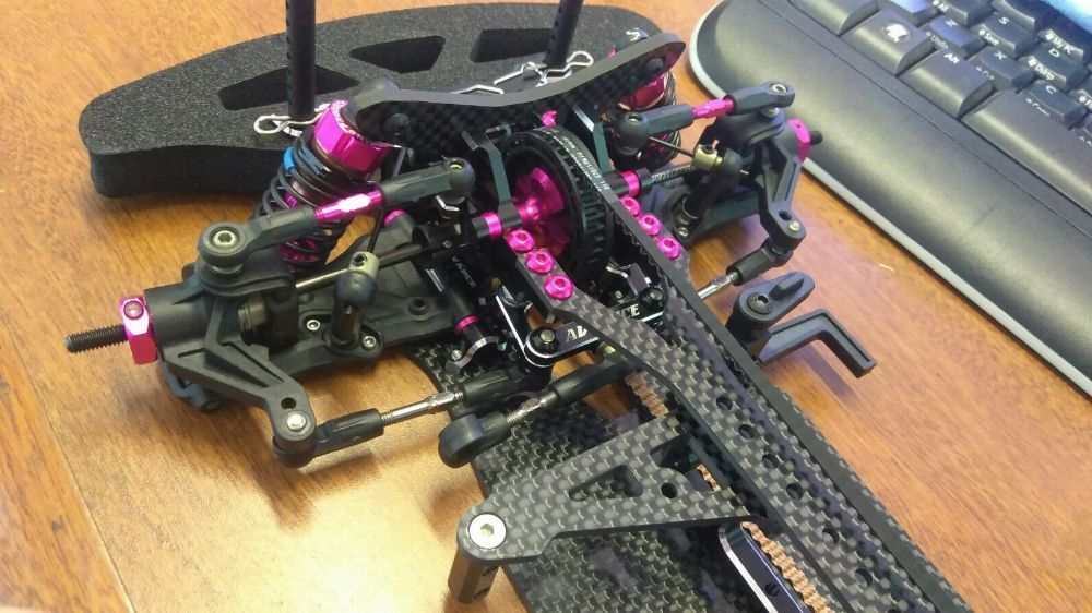

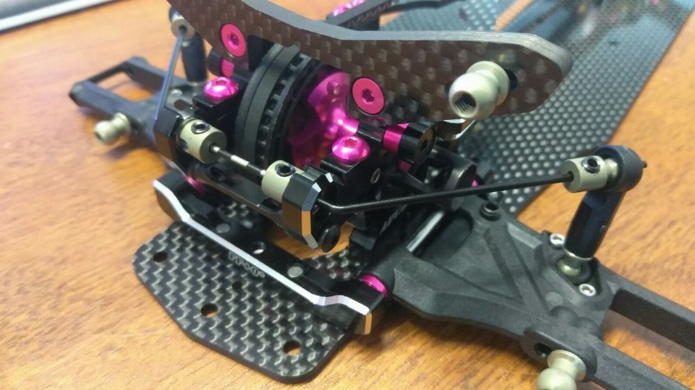

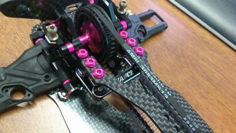

Sway bars went together nice and easy

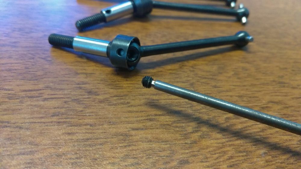

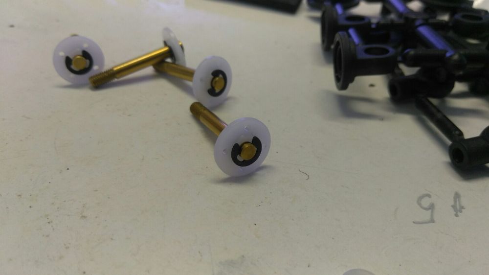

Make sure to apply some locktite on the set screw for the rear axles, they come pre-assembled but 3racing does not apply any and they will come apart over time
Careful with the e-clips, you only get 8 ... 3Racing somehow believes none will be lost so you don't get any extra

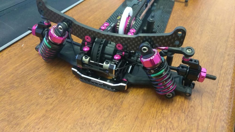

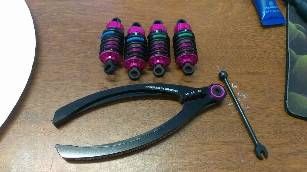

I built my shocks with 32.5 front and 30wt rear, the included springs are a mystery, they are not color coded and are a tiny bit smaller then there standard big bore springs, they rate around 10lb so around the SAK-U314/BK/650 15 x 6.50 Spring -BLACK but they are not the same ... so I went with SAK-U314/BU/700 15 x 7.0 Spring -BLUE front and SAK-U314/GR/725 15 x 7.25 Spring -GREEN rear.
ST-024 Damper shaft Gripper make building the shocks super easy

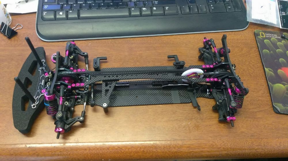

The finished product

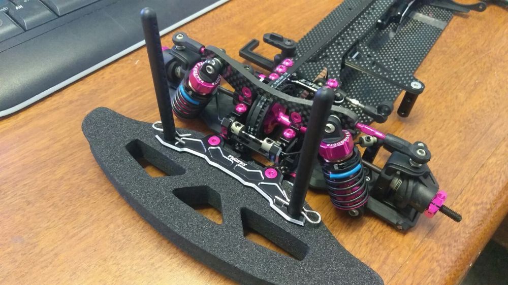

The kit went together exactly as expected, fit and finish is up there with any brand, I like the pink bling I added, imo solid black makes it look generic ... not sure why 3Racing went away with the pink, it was there brand color. I did not install the center chassis stiffener, plan on racing on asphalt so will want some flex. Also need to play around with the shims for the a-arms, they feel a little tight with the factory set.
You get what you pay for ??? No, not with this kit, you get sooooo much more. But that's only because 3Racing has seriously undersold the map price on this kit at just $233.70 or $251.70 shipped direct from 3Racing, it costs dealers in the USA just around $245 Im better off selling the 3RACING XI SPORT NU kits ...
