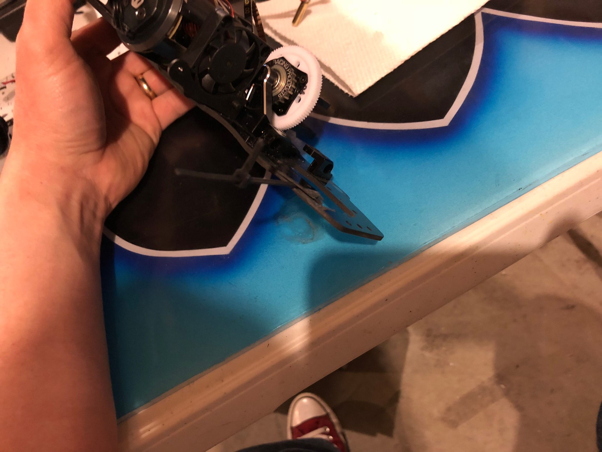

I literally just saw that on hit tonight ripped a screw straight through the chassis. I dont know what to say. Won the main like that. Kinda bummed about that for sure!
Wow that must have been some hit to the left rear! Surprised if it hasn't also bent the pins?

Yep, was getting used to the new car and clipped a dog leg corner board at full speed with the rear. Ate the dot and went all the way up to the board. OOPS.

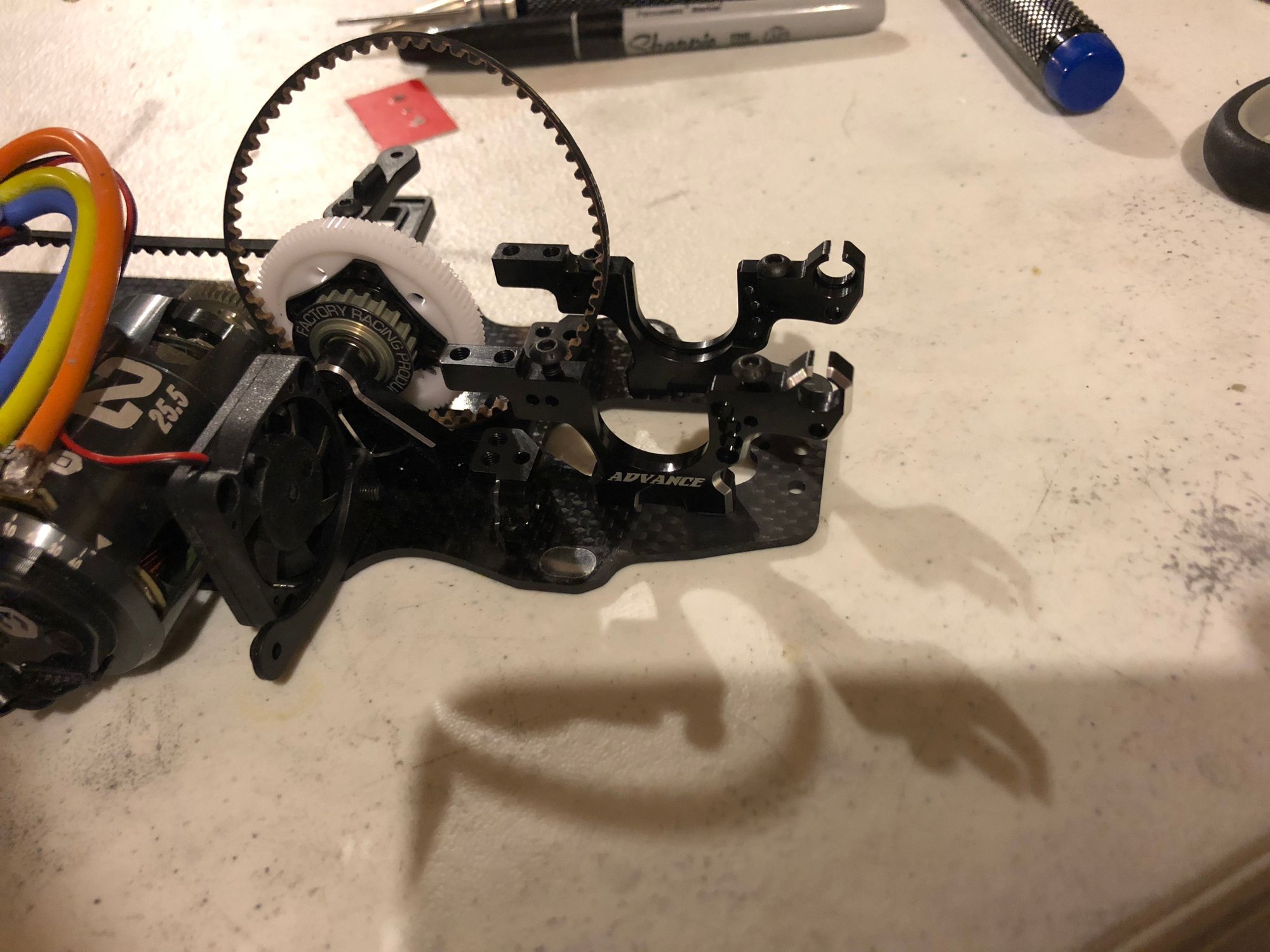

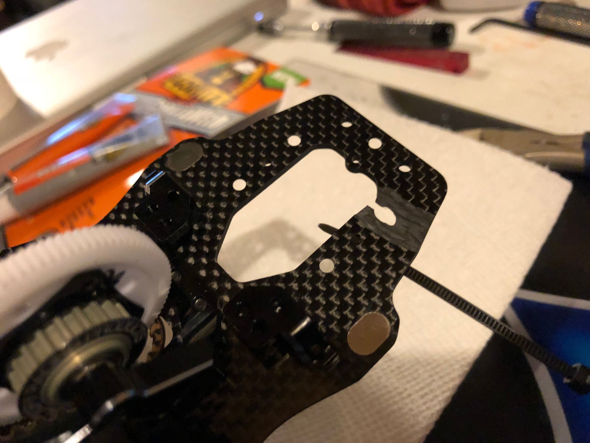

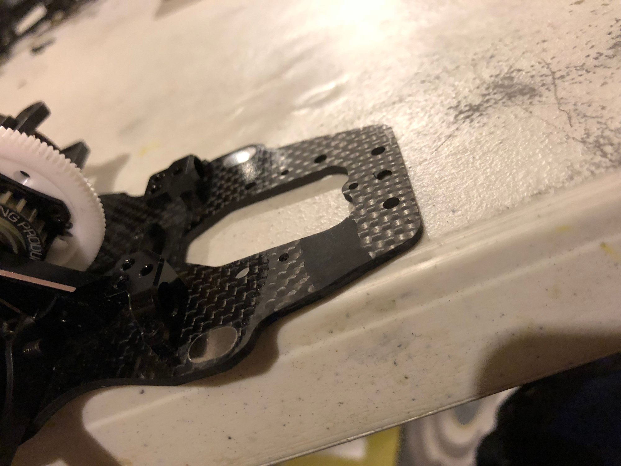

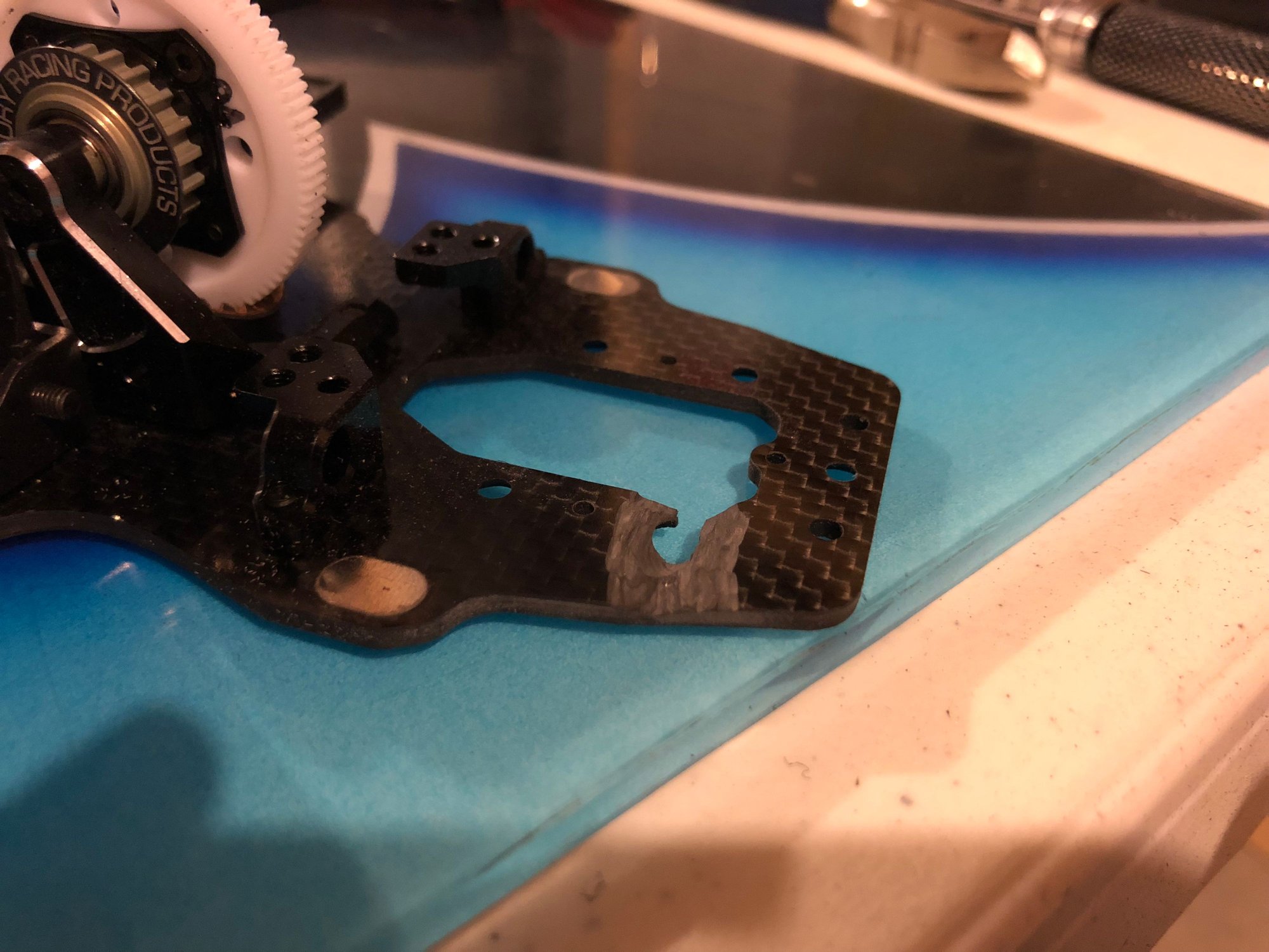

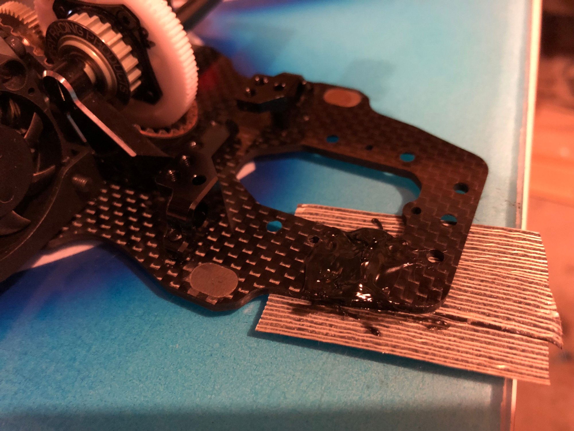

Pics of the repair progress. Smelled a little like solvent hadn't totally cured, so holding off a day more before drilling and countersinking the hole. New chassis is on the way from HK but if i wanna race this weekend, this repair and some cut down tc5 hinge pins are my only way!
Ground out all Frays
Propped open the split and ca glued back up and ripped out the zip tie
Filled with steel reinforced epoxy
Block sanded down

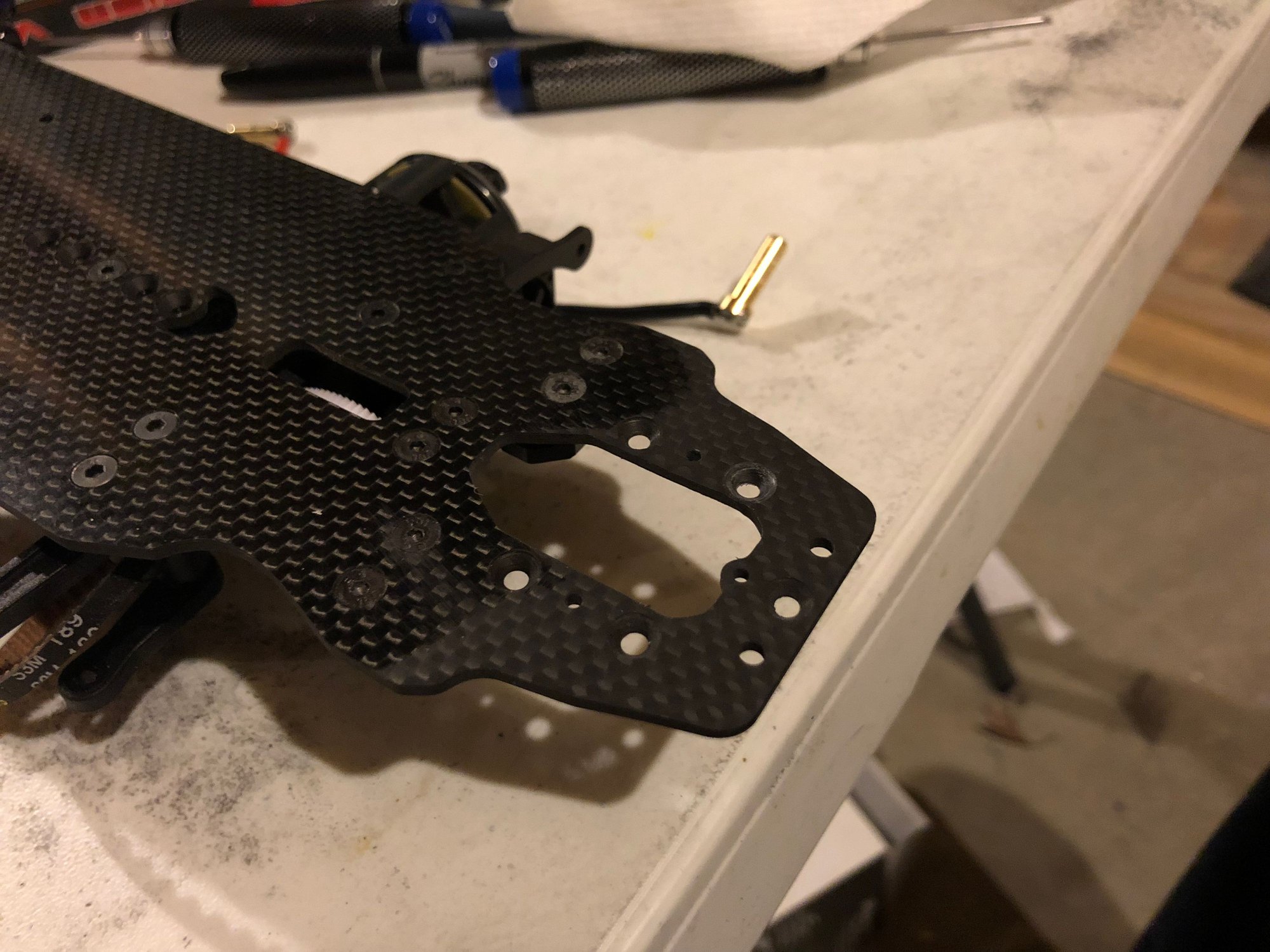

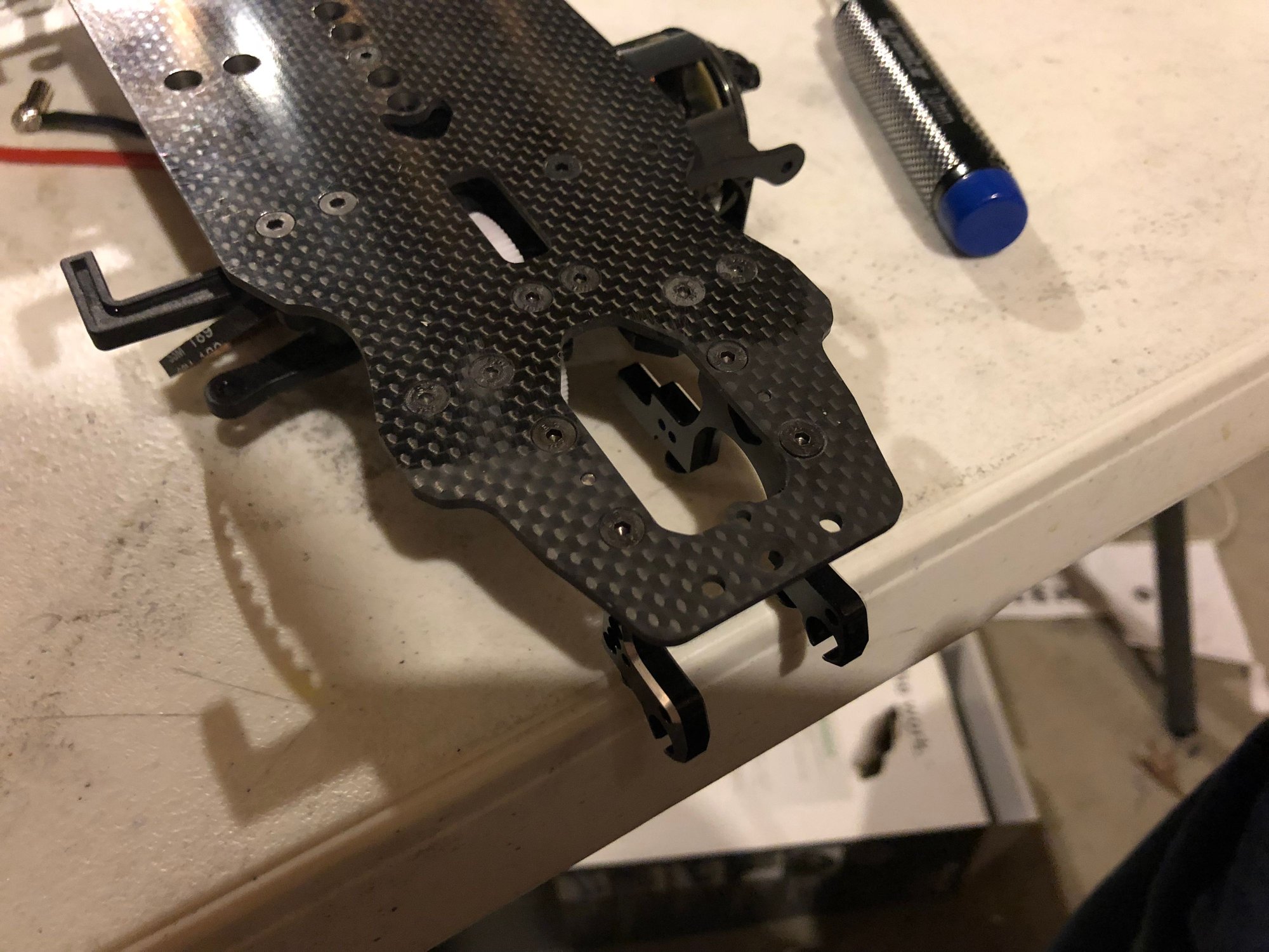

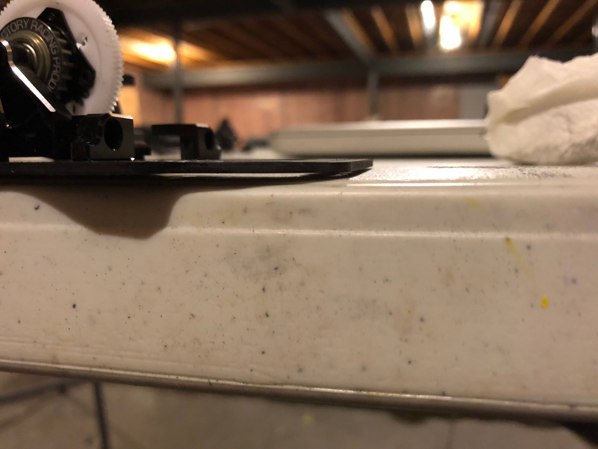

Chassis repair complete! This should get me racing this weekend while I await a replacement. Measured 1.97 mm at very rear and 2.16 elsewhere, meaning I lost .09mm from block sanding. Better put that on my setup sheet when I dominate and become a household name!
All joking aside, here are pics. Seems solid. Definitely solid enough to club a few weeks. Loctited the affected screw so I didn’t have to torque it much and risk cracking the repair, although I doubt it would have.
