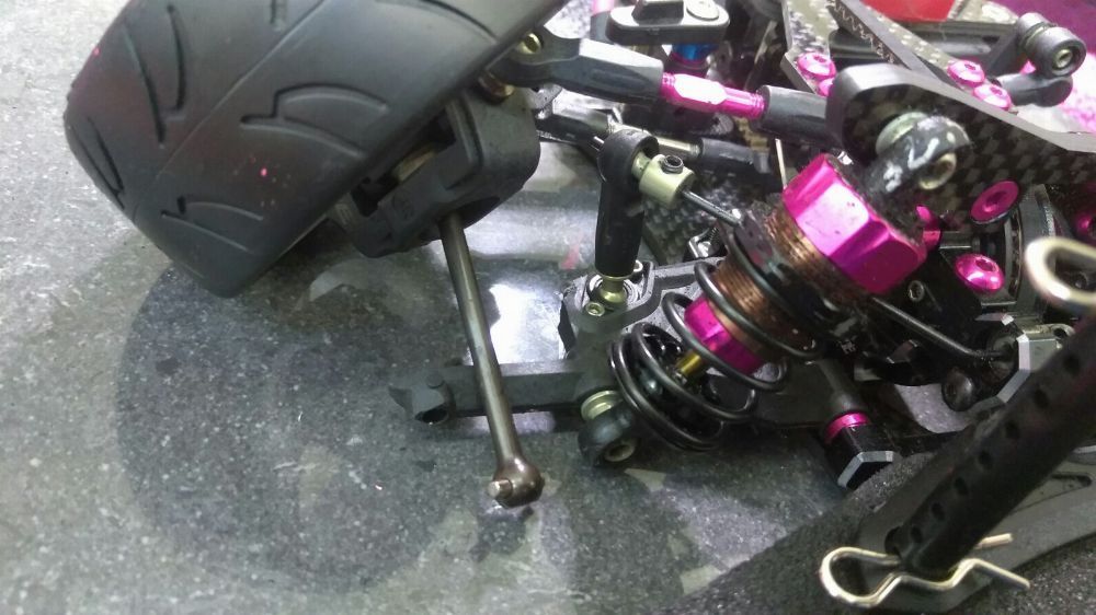

Ran my 2K18 all weekend at the super tight and technical 386 Raceway for FSEARA race #2, set it up for USGT, replaced my asphalt diff (1k) with a 7k diff, car was easy to drive and very consistent, a little under powered with the trackstar 21.5 motor but still fun, just getting it ready for the snowbirds 25.5tc class.

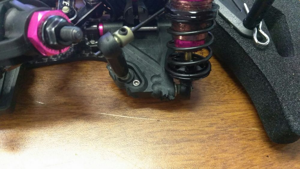

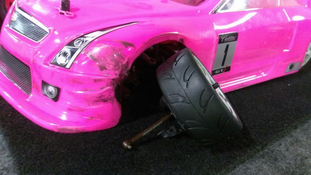

Ended up breaking both front arms, one on saturday practice and one in the first qualifier on sunday ... did take some hard hits so cant really complain but might switch to the older arms which have been proven very durable on carpet Ran the same car at 386 just a few weeks ago in 21.5tc with the same layout without any problems ... could be stress cracks over time, either way there are a lot of front arm options

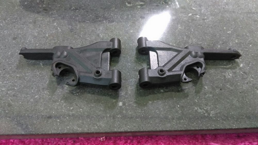

Looks like there's a weak spot around the ARB mount? Good job it's only $4.25 for a pair of front arms! Are the older arms a slightly different length?

The older arms are 0.5mm narrower, I did a arm comparison couple post ago, the older arms are available both graphite and regular while the 2k18 arms are only graphite at this time.

I have only broken the right front on mine, but it has happened several times. And the break in the exact way yours did. Seems like it may be a combination of design and material issues if they all break the same way.
theproffesor is offline

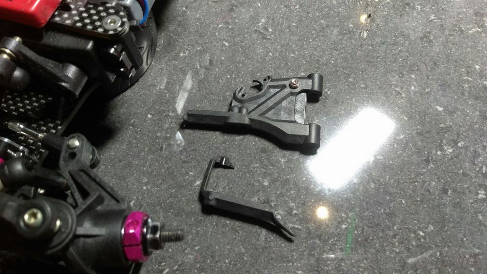

Ran the 2K18 last night at our local monday night club race @ Quaker, temps were in the high 40's, testing 26mm tires for our new RCGT class ... broke both front arms guessing the cold temps didn't help with the very stiff graphite arms, ended up installing SAK-U101 arms, just had to swap one of the shims from 2mm to 1mm
SAK-U101
SAK-U101
Those arms definitely have a design flaw. The pattern in the broken arms seen in this thread are all in the same weak points. 3Racing must come up with a reinforced and redesigned arm.
