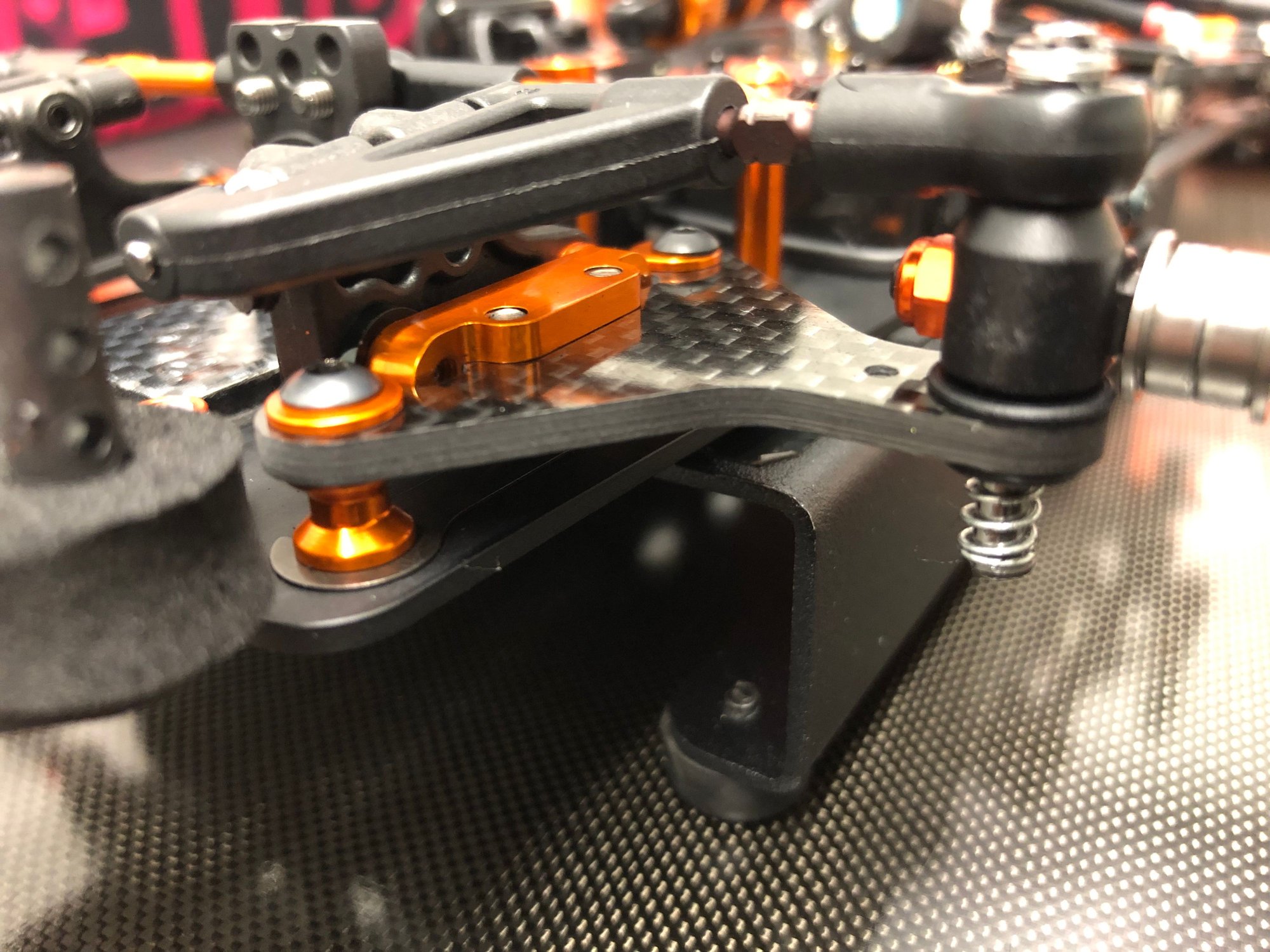

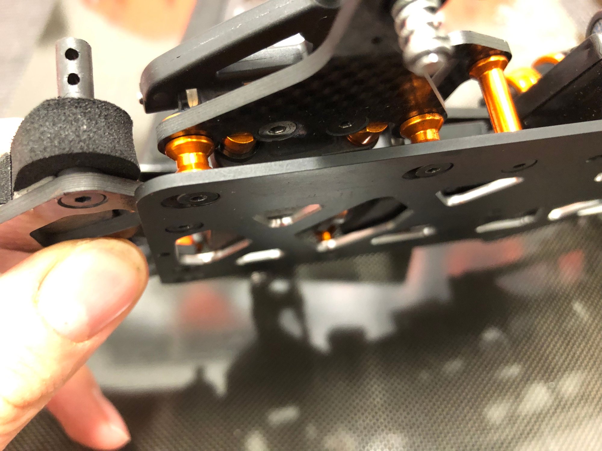

Here’s a shot of my arm setup. This pic will show how the upper arm mount is attached to the lower carbon arm, and how I have the lower arm attached to include arm sweep.
for the upper arm mount to work as shown, you should swap the carbon piece left to right so you can still use the countersink screws.

What was your caster? The steering blocks are so perpendicular to the arms. Mine are angled back, but I haven’t done the arm flip mod either.
I was running 3* then moved the arm .5mm more forward but didn't re-measure. I'd guess around 1-2*.
