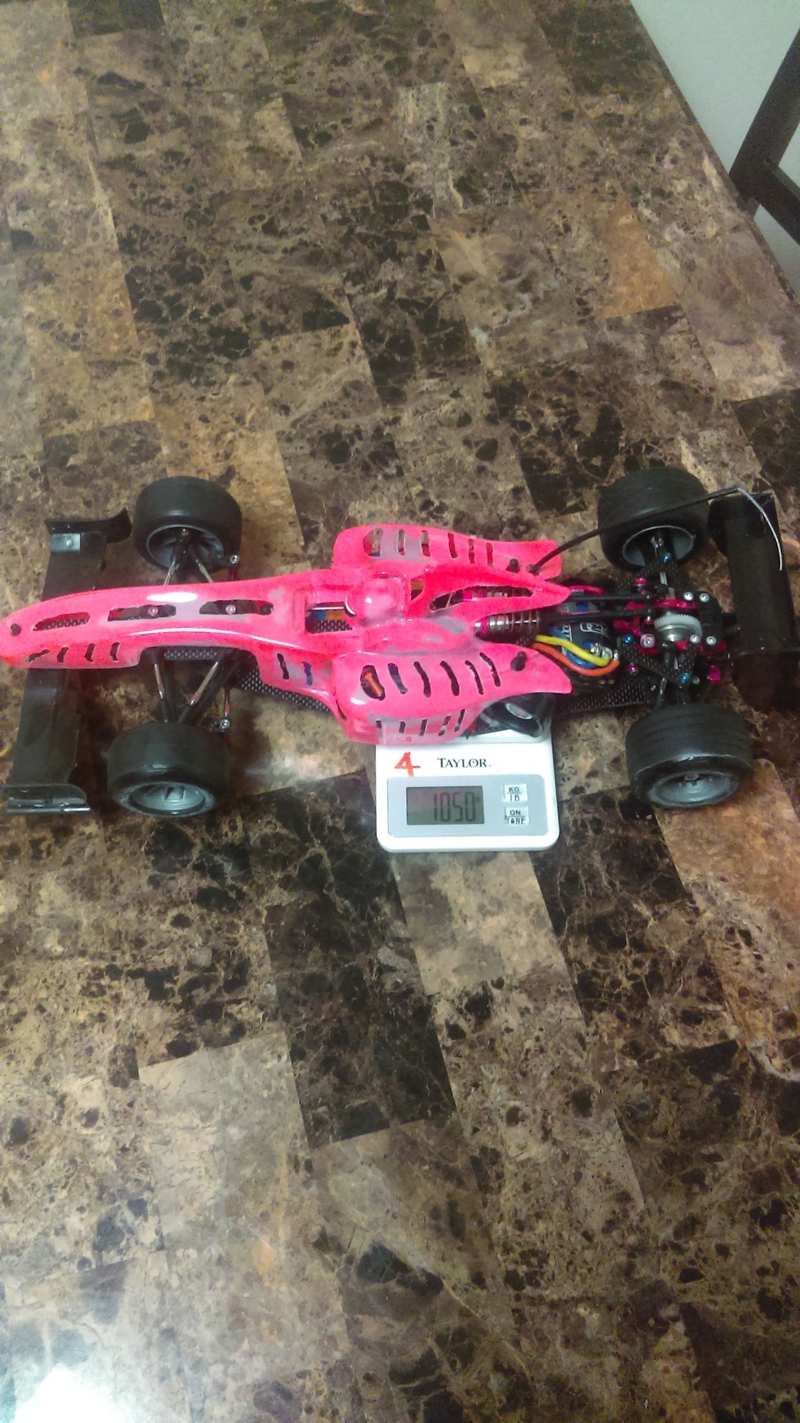

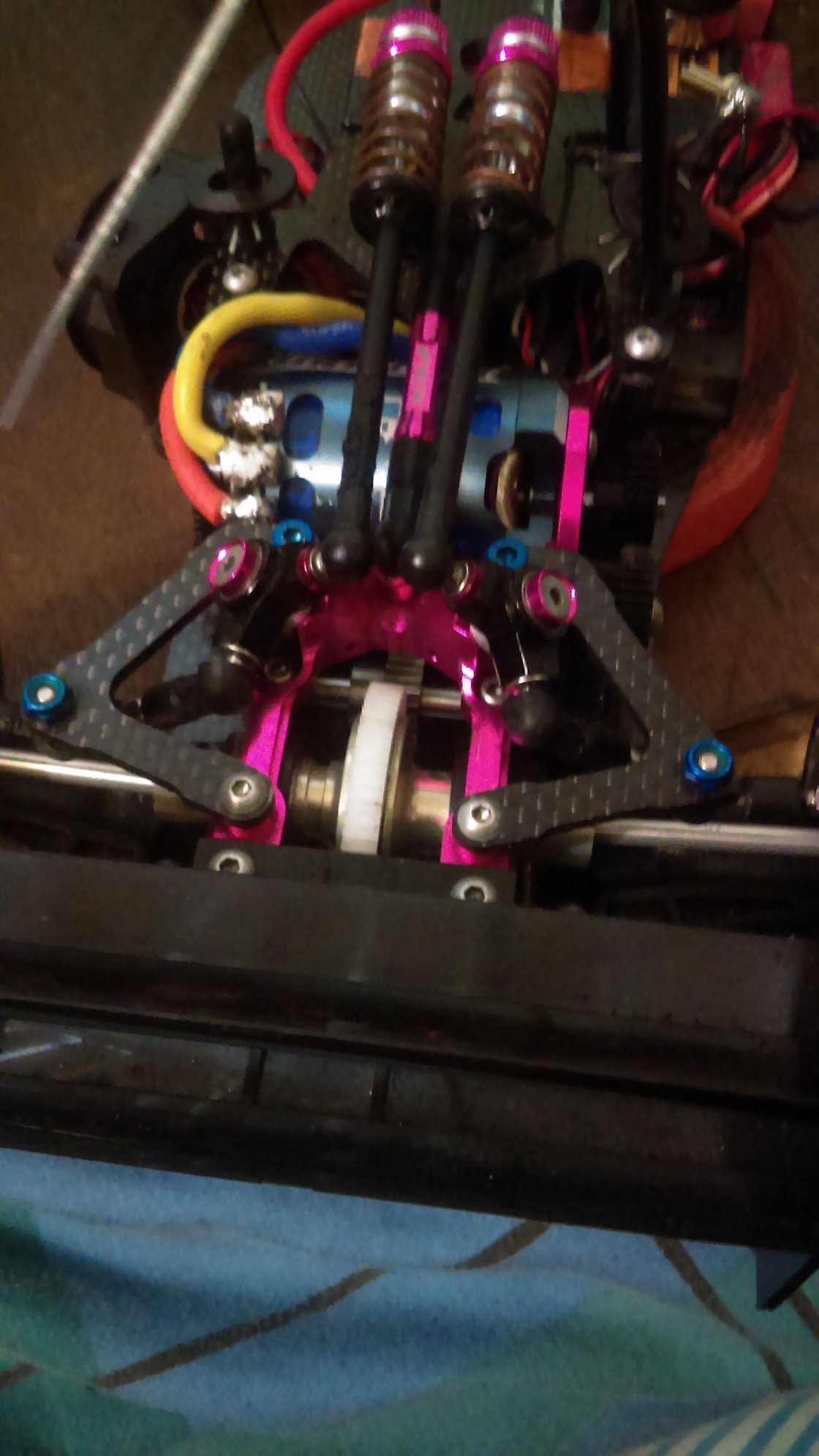

Well the best version is the Mckune with the Bert 48p gears and ball diff(60t/27t) mod:

lmao!!! love your F1 body mang

Lightest F1 tiger body(23grams) ever !!! LoL !!!

bertrandsv87 what front upper arms are you using?

I bought this FGX from another racer(howardcano), and I have no clue what front arms came with the car...He might be able to answer that question if you Pm him....All I know is that it works great, and reduces weight in addition to the lrp super shorty(2600mah) pack....

I have to ask what kind of run time are you getting with the super shorty? I recently got some of the ones hobbyking sells to play around with weight distribution on my drift cars so far i am liking them very much

The runtime was good for more than 6minutes, but I never tried to push it past that... My F1 car only used 1500mah on average, but that was before all the upgrades when it weighed around 1100grams with the original thick gears...I was also overgeared a bit with around 2.8fdr instead of the recommended 3.2+fdr for that fantom fr1 v2 25.5t: others have gone up to 3.53fdr with that motor in other direct drive F1 cars.... I guess I was pushing the battery hard, and it had no issues at all...I also ran a protek 6100mah(219grams) back to back to compare with the super shorty(139grams), but it just made the car too heavy, slowing down acceleration and traction rolling in corners: the lower voltage drop could not compensate for the weight difference....

thats not a 2.5t motor!!!

what kind of super vision do you have to see the battery? Or did I miss a better picture.

xray vision lol. Actually he posted the battery he runs on the post right above mine. This one, bottom part of it.
