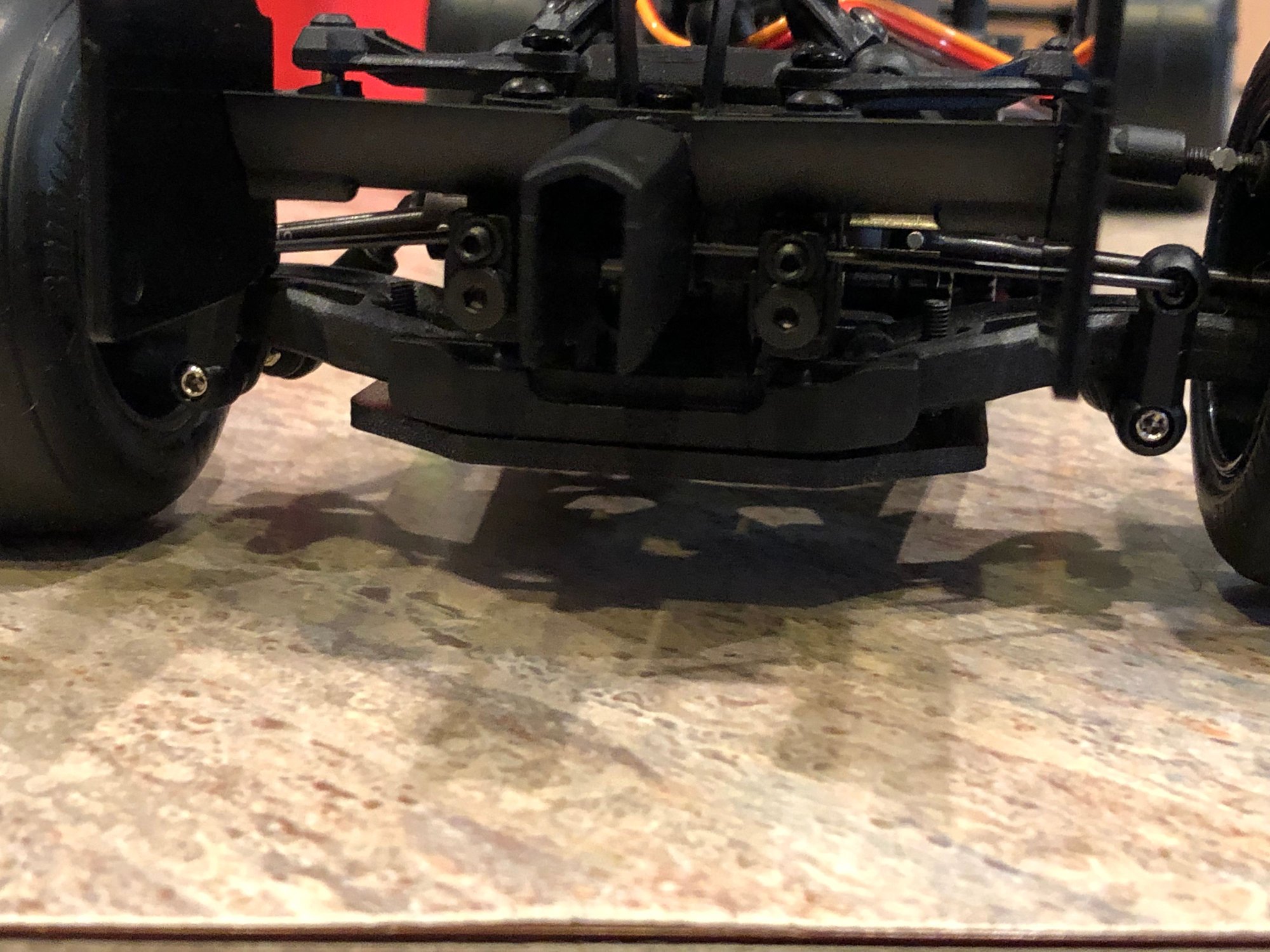

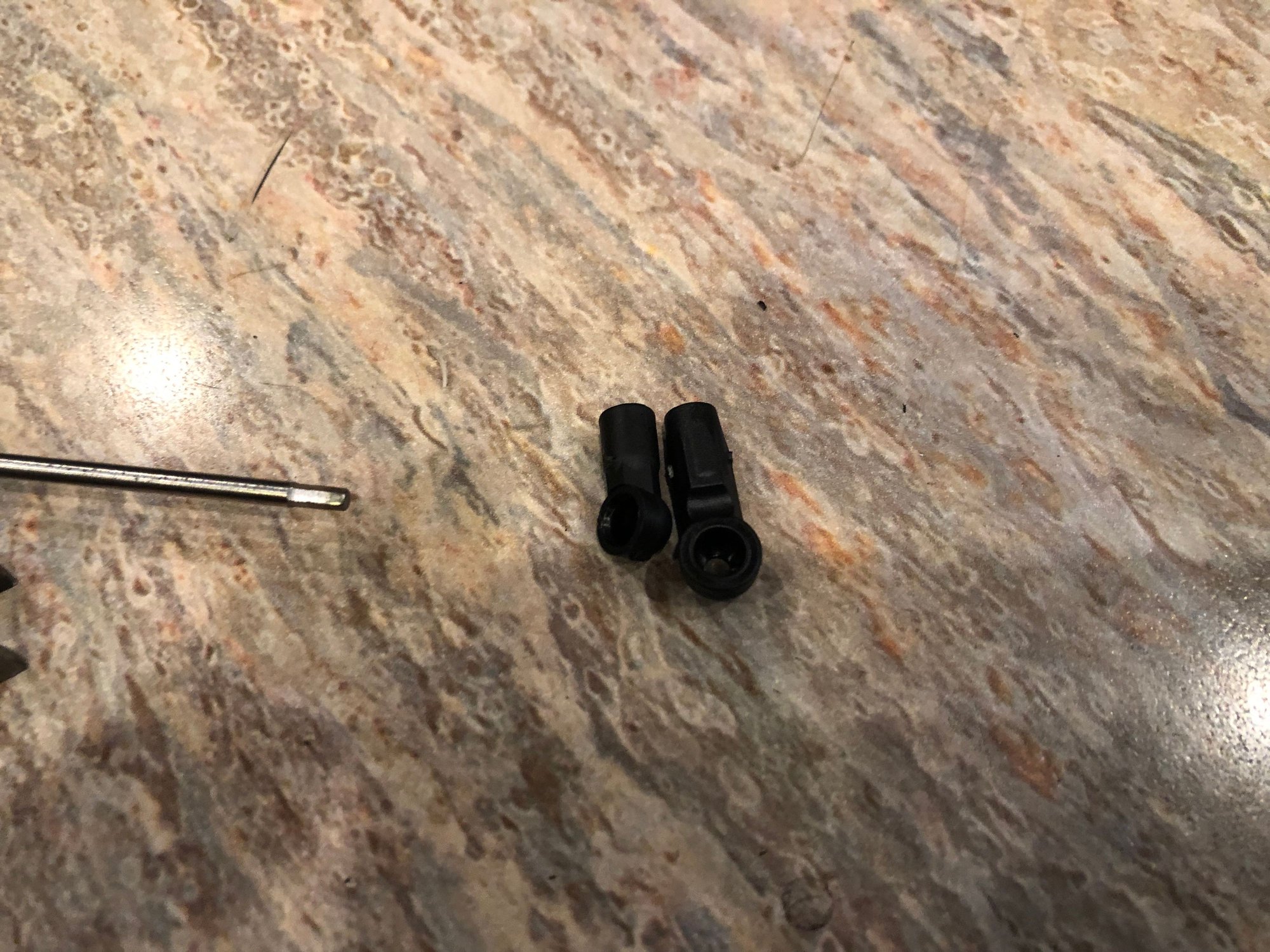

Yesterday put the tires on to get a look and discovered a mistake I’d made.
Used the wrong ball cups.
Now looks better. Still needs adjusting. Again I wish they had included a simple turnbuckle wrench. I show this mistake for those that are hesitant about trying kits. Don’t want to make mistakes. It happens
#170

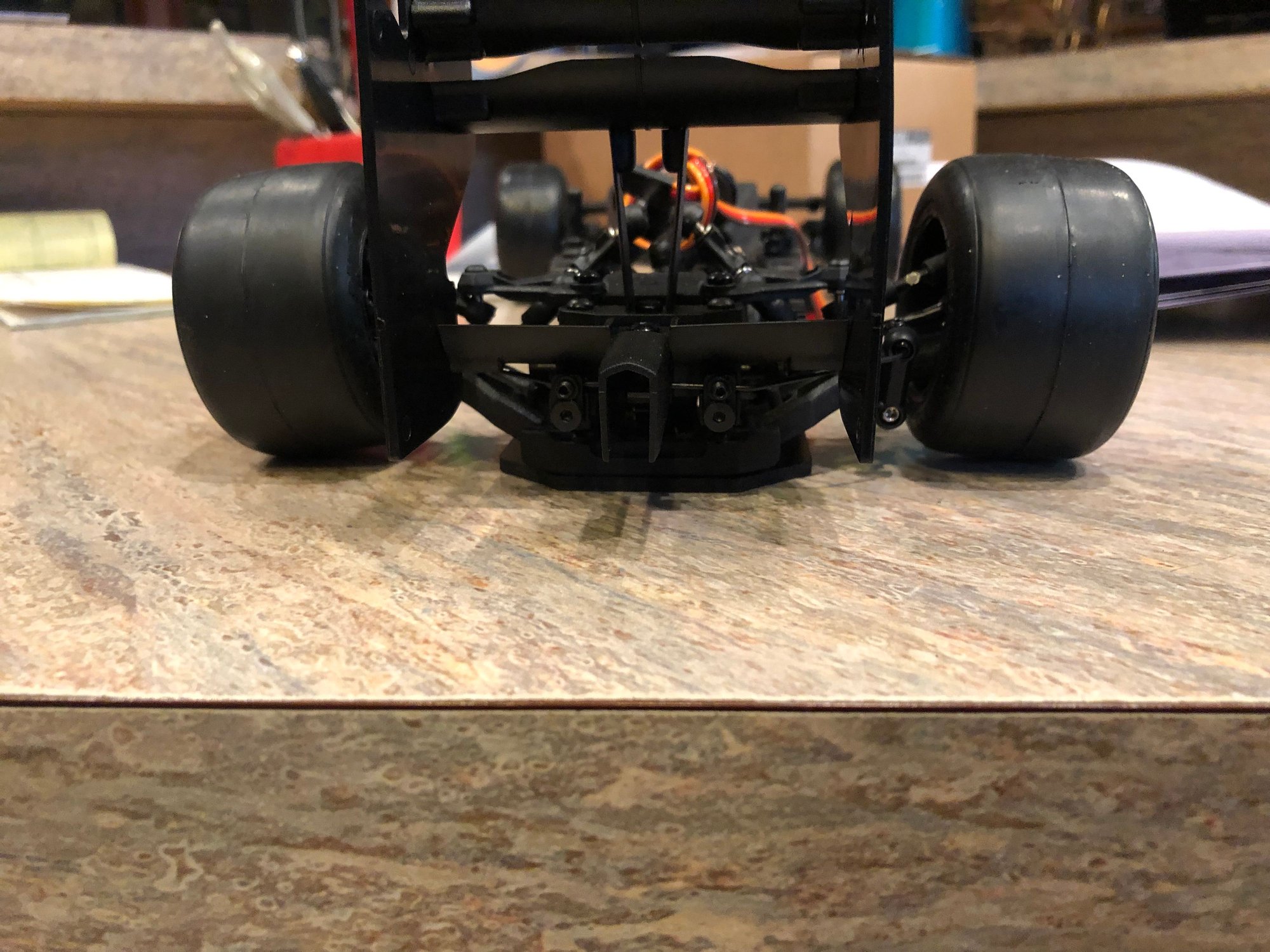

Is your's leaning a bit to one side there Billy?
I built mine very carefully and mine leans slightly at the back, which would seem something is out of align but I used set squares on the bulkhead when building, and a digital calipers to ensure shock lengths and turnbuckles were all equal....
So it makes no sense that it leans. Shocks were all built the same and with due care, same level of oil, same compression.
I did a bit of a ghetto fix for it by a combination of adjustments with droop screw, turnbuckle and shock length (rear) to make sure the adjustment was spread out rather than hiking a turnbuckle shorter by 5mm or something extreme.
Bit wierd, just seems like yours is doing that too in the photos or is it just the camera angle?

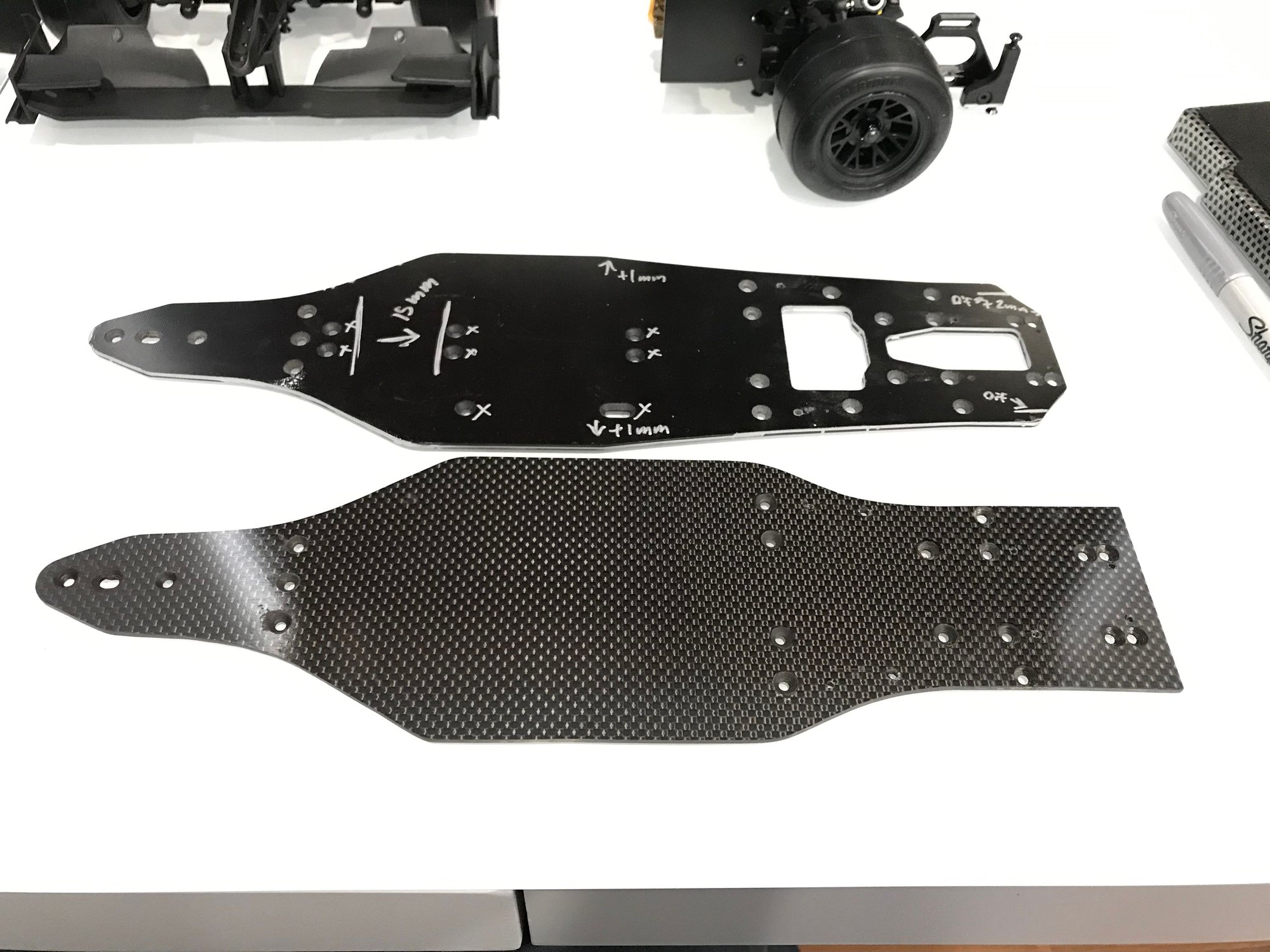

So update on my 270mm build
Due to the shorter wheelbase and center servo concept, I’m stuck with the transverse battery layout. Rear suspension is fully intergrated and using the servo as part of the top chassis structure
Up next will be to intergrate the front suspension with the car directly mounted to the other end of the servo. Looking to keep the suspension fairly stock while eliminating the main overweight tub chassis conposite pieces

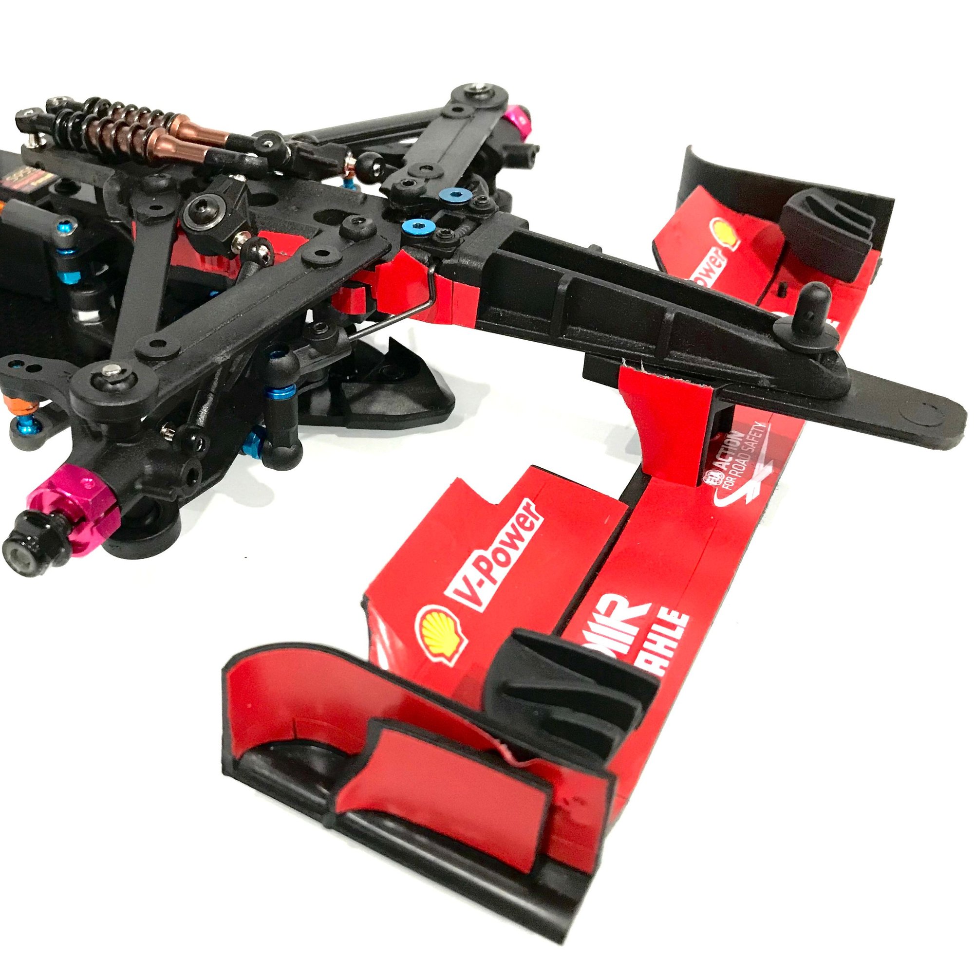

Little side project F1 is nearing close to hitting the track for testing. Just missing ESC and rear wing details
