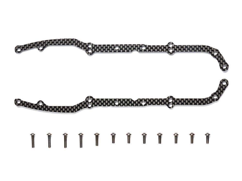

Tamiya #54805 - TB-05 Carbon Side Members

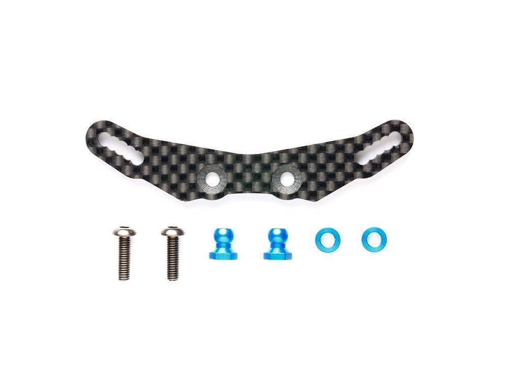

Tamiya #54804 - TB-05 Carbon Damper Stay (Rear)
Tamiya #54803 - TB-05 Carbon Damper Stay (Front)

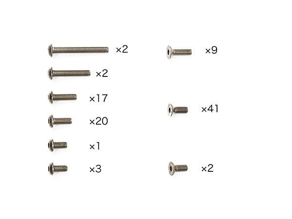

Tamiya #47377 - TB-05 PRO Titanium Screw Set

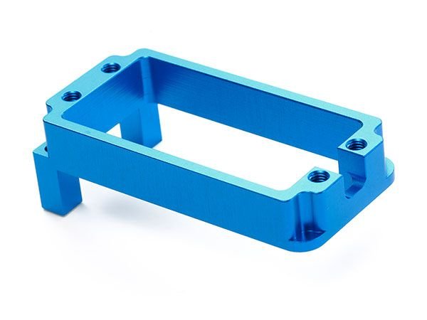

Tamiya #54800 - TB-05 Aluminum Servo Mount

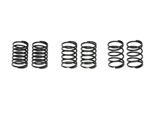

Tamiya #54797 - Touring Car Short Spring Set II

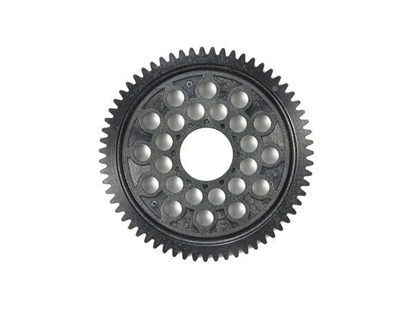

Tamiya #51609 - TB-05 06 Module Spur Gear (63T)

I like the look of the servo mount and the steering parts. Always good to get rid of flex in the steering system; it's too hard to predict the cumulative effect of having multiple flexible steering parts. If you want a little flex can just use a servo saver, or a flexible servo horn. I hear the XRAY servo saver is the best one available nowadays.
The carbon-fiber upper chassis braces might be worthwhile, but carbon-reinforced nylon should be fine. The carbon-fiber shock towers are pure bling, because they aren't as stiff against twisting as carbon-reinforced nylon is.
Titanium screws are always nice, but there's probably less expensive places to get them than from Tamiya.

Does a spur gear even count as an "option part"?
