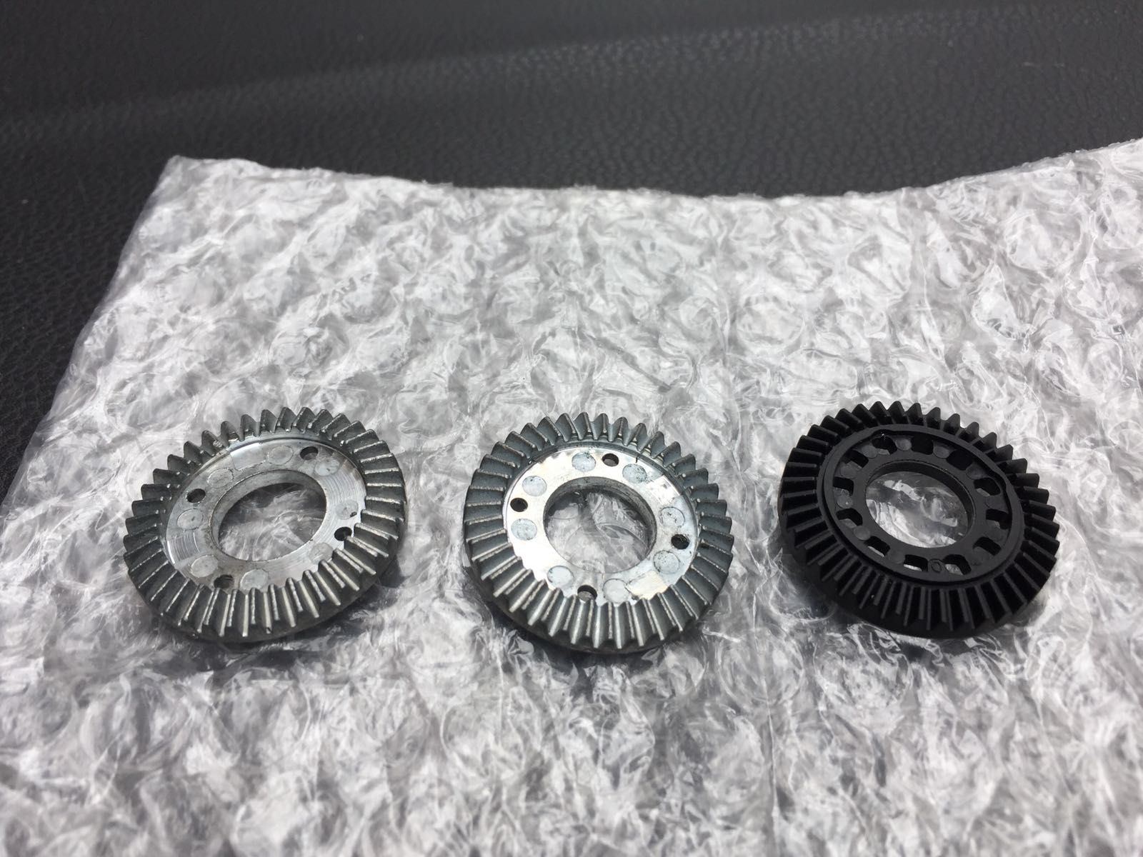

They look like the crown and pinion from a Nanda NRX12? If so ... yeah major mods needed

maybe give it a try the nanda nrx12... mine is not that car and I don't have any info on it... I am seeking some metal spiral gear too, it may be more durable.
