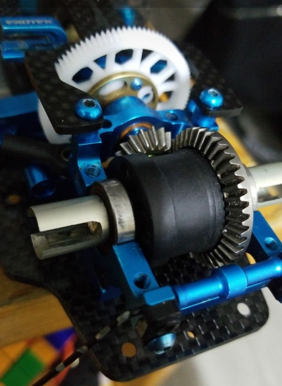

Steel gear is the key. I run Hobbywing Bandit 10.5T brushless still ok, will try 4.5T or 5.5T later...
Tom1977 likes this.

Posts: 542
May i ask, where you get those metal gears?
Is that a EVO5 gearbox with TB04 diff? Internal ratio?
I know that EVO4 had some metal gear as hop up. Never saw the propeller gear made out of metal until now...

Hi, correct,its my tb evo 5 modified chassis with tb04 gear diff.
all metal gear is unknown brand name and need to make some mods to suit the diff case. The front and rear propeller joints also need to mod and add shims too.Its still under testing and I will share or make some copy later.
