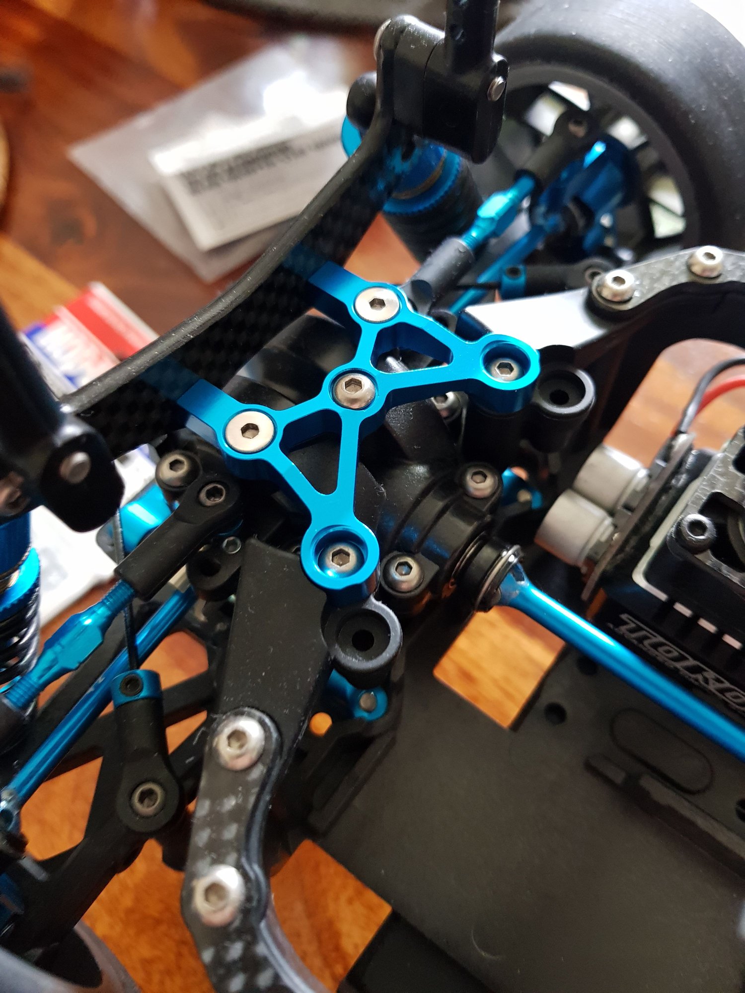

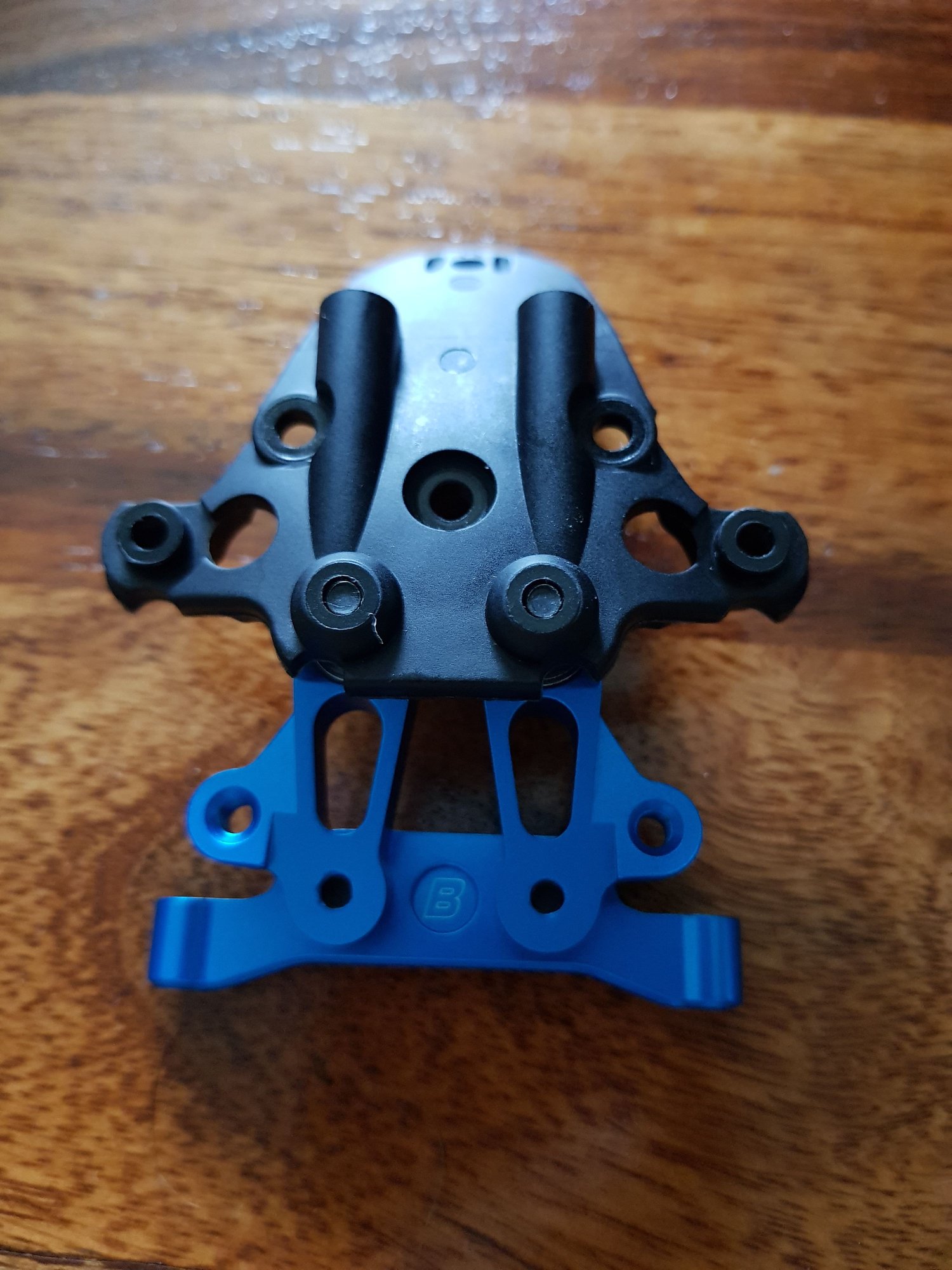

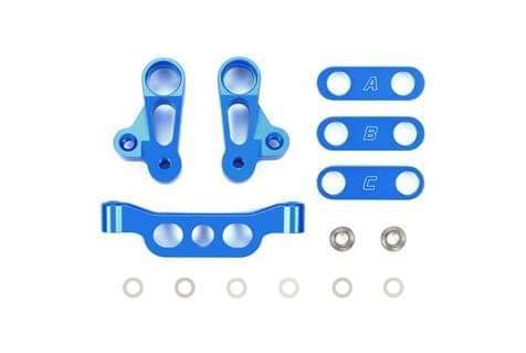

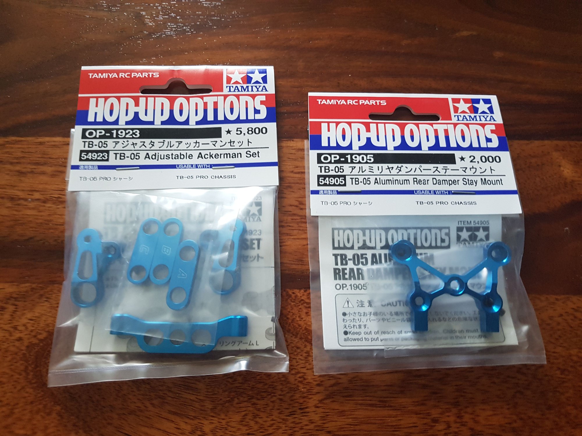

The newly announced hop ups arrived today.
#54905 Aluminium rear damper stay mount
#54923 Adjustabe ackermann set
Rear damper stay mount is more rigid than plastic part. But I'm missing same for front.

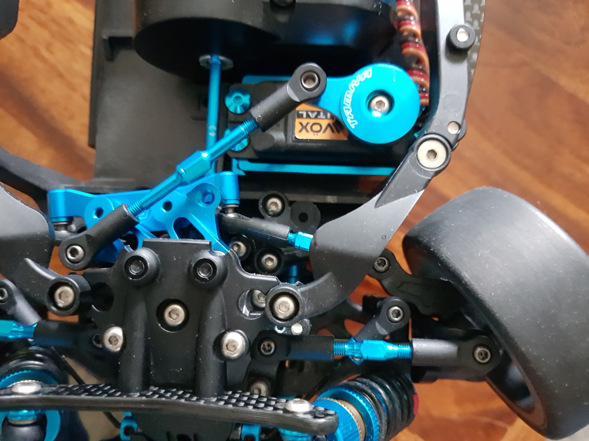

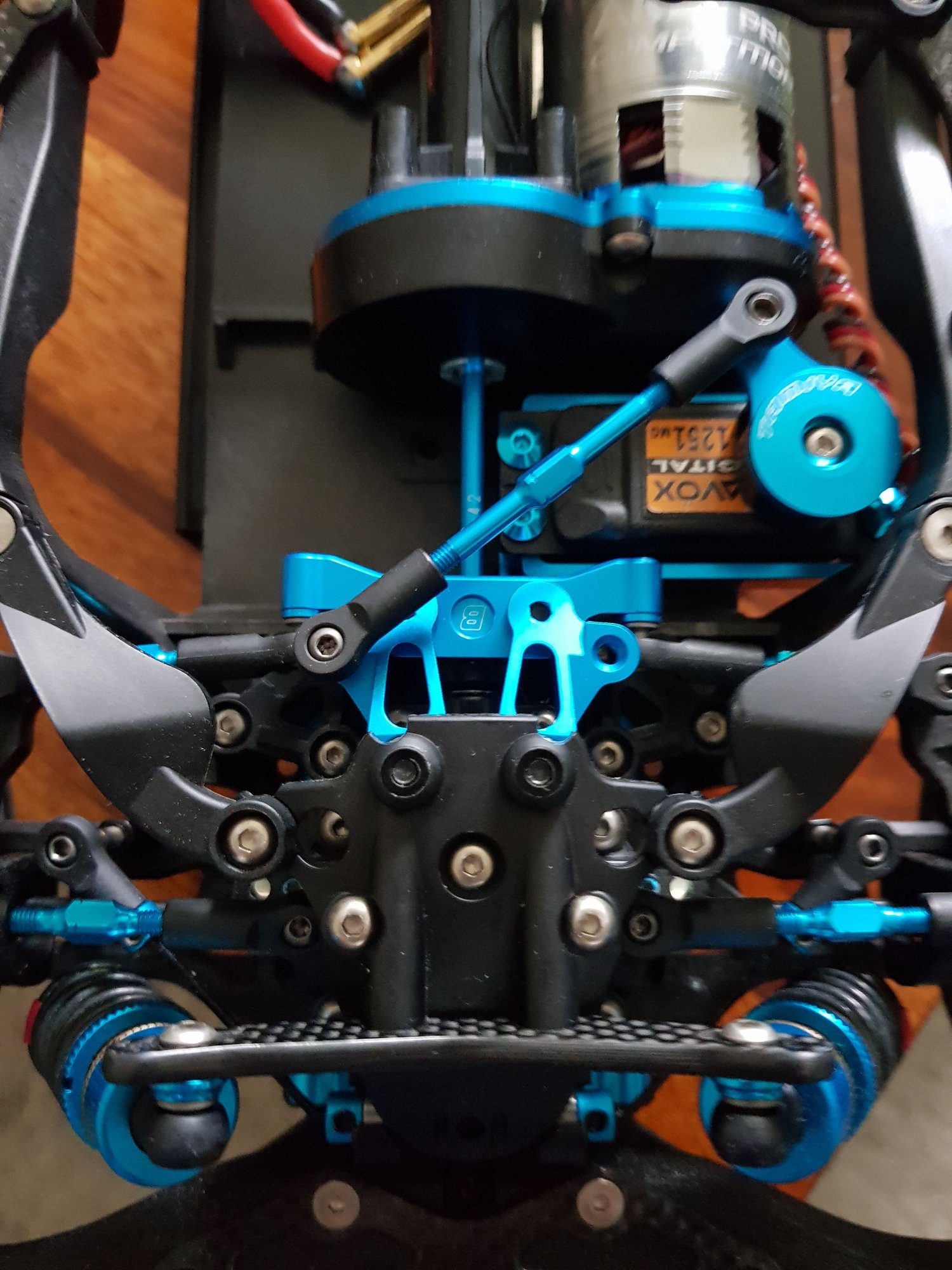

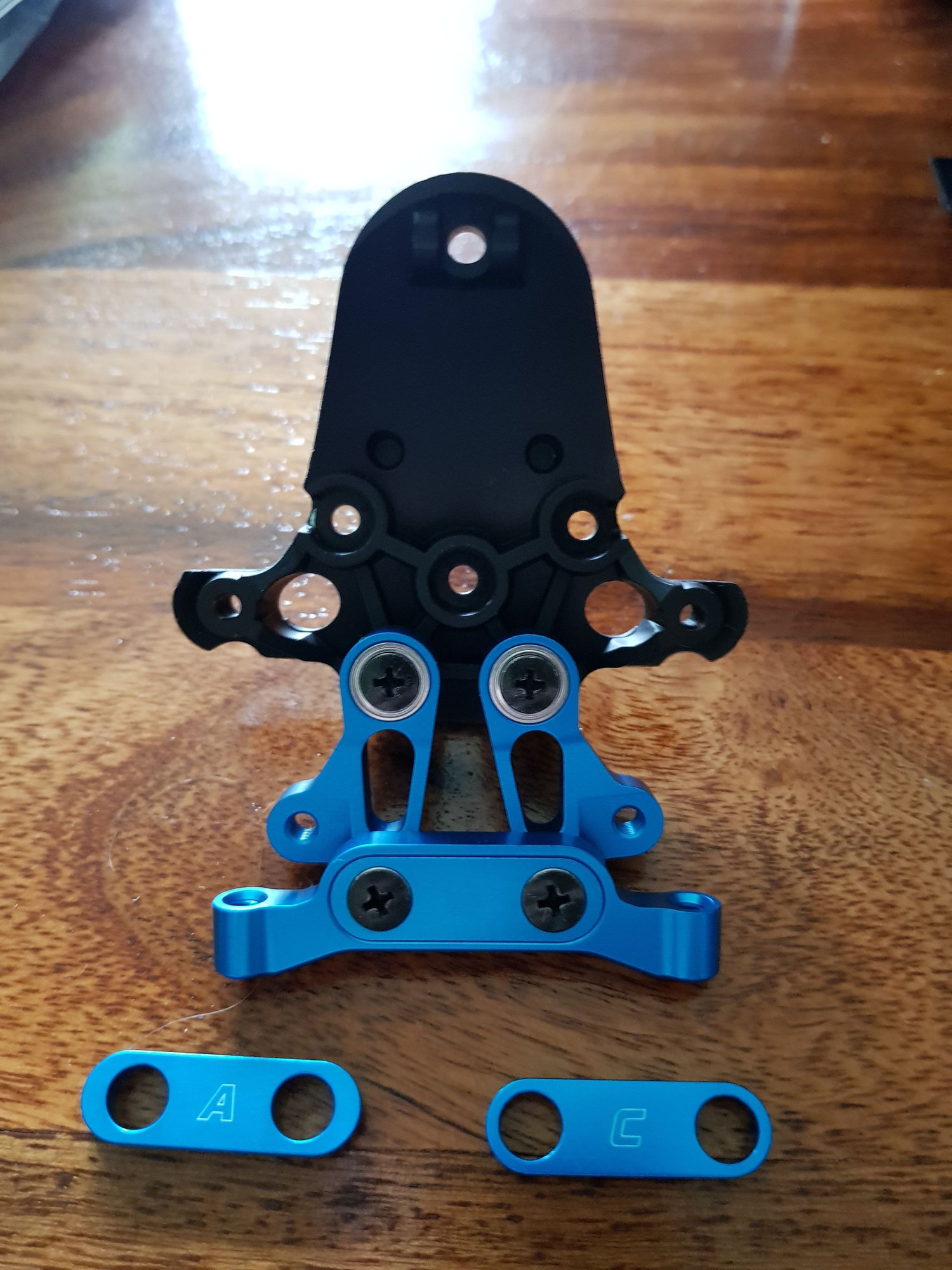

Ackermann steering set. I started with insert \"B". "A" is kit setting, "C" the most aggressive initial steering response. Surprisingly the new parts have better tolerances than the old aluminium steering set. Only shims between plastic part and bearings needed. In the steering bridge i used no shims.
Ackerman steering set with the inserts.
With insert \"B" now full steering angle available without touching/bending the main frame. Seems Tamiya heard the complaints.
After mounting the steering set the linkages have to be adjusted.
Tom1977 is offline

Originally Posted by Tom1977 View Post
Video shows two kind of slop. The slop in the outer steering arms is pretty normal. It's an addition of all tolerances in the complete steering unit down to servo. The second slop in the steering arm bridge is not normal. I've the same aluminium unit, but I have no such slop in it. But i shimmed everthing in this unit from beginning (bridge and arms).
Seems, something with the bearings is wrong. Maybe two countersunk screws in the bridge would help to center the bearings (kit are flatscrews).
Main problem with basically all Tamiya steering units is, that technically they are using the wrong bearings (ball bearings have slop with longitudinal forces). In a steering unit something like a thrust bearing or cone bearing would be better solution.
I agree that the slop is terrible and cased by the bearings. But, a 5MM shim under the bearing between the bearing and the steering arm and same for the bridge resulted in both smooth operation and slop-free build. I learned this while playing with the M-08 and it worked on the TB-05 as well. Give it a try. I think I used a 5mm x .1 mm shims in each bearing hole.
EBR
NCHPIboy likes this.
EB Racer is offline
EBR
The new ackermann steering unit doesn't need much shimming. The ackermann steering bridge has smaller bearings which have less slop.
rippen and EB Racer like this.
