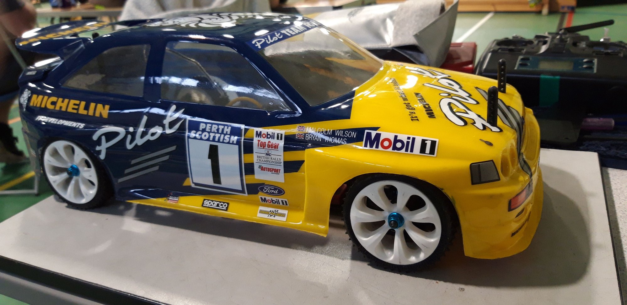

Ready to go!

Wow! Tamiya Ford Escort RS Cosworth...a very rare shell.

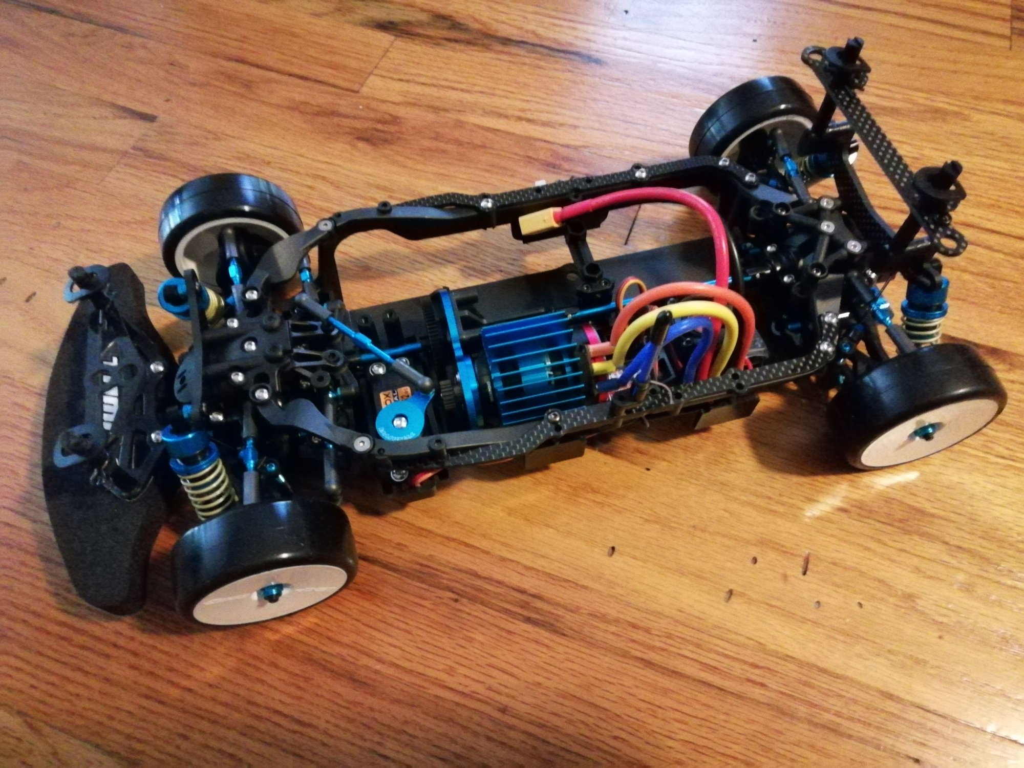

Default Finally able to post a picture. Running this for the first time next Saturday
TB-05 Pro

Looks good , but I would run a fan instead of the heat sink ....

No need for a fan. I'm adjusting the gearing with a temp gun.

Its not an original Tamiya shell so I dont feel bad about racing with it!
