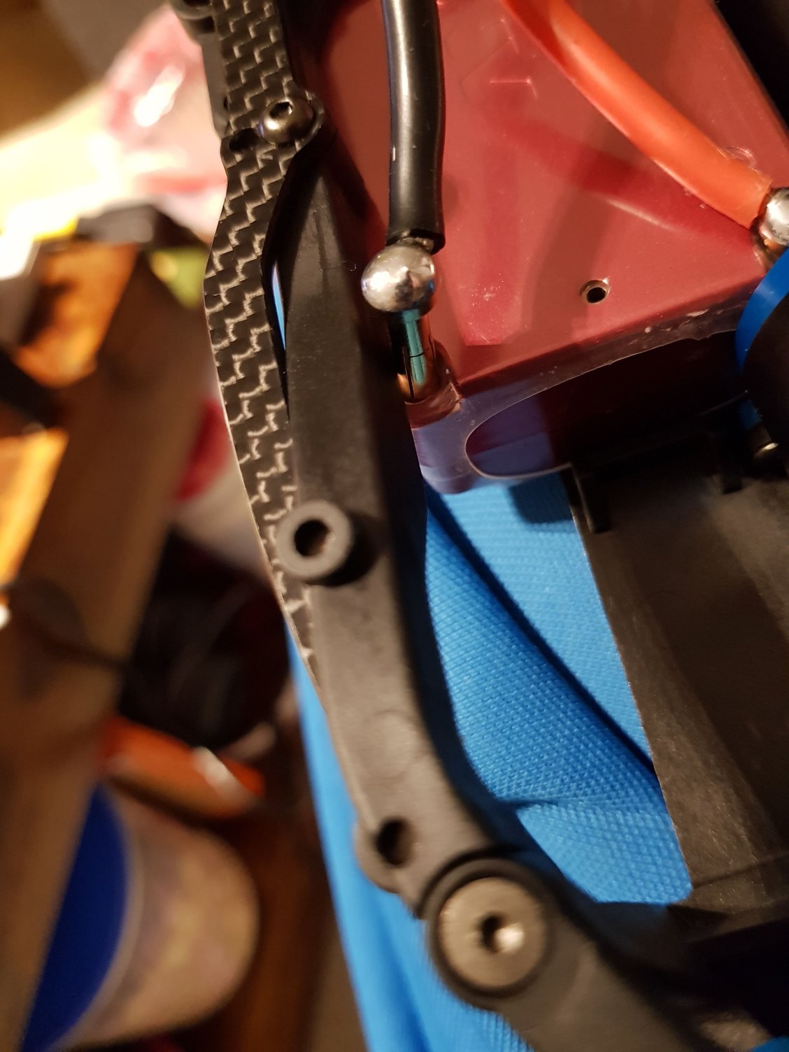

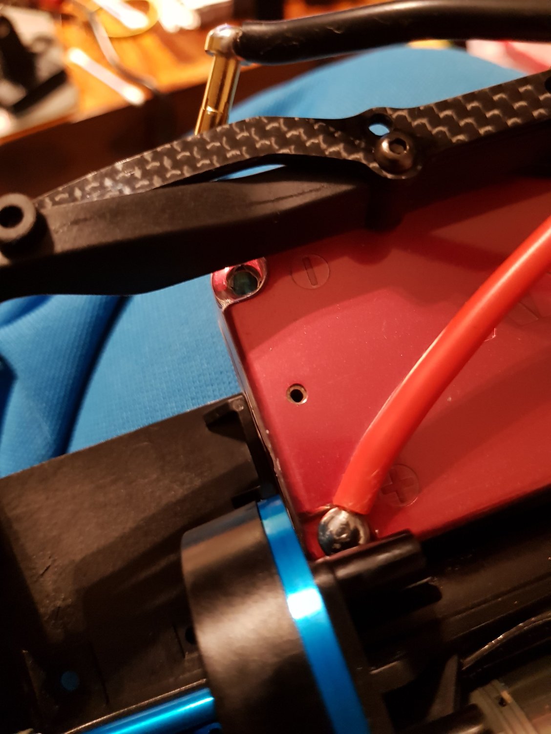

Posts: 569
Default Battery does not fit
How did you solve this problem???
Plug bends the frame, if I connect it...

Originally Posted by lagcisco View Post
Gotta use the NiCd batteries with those Tamiyas
Ehm...no!
Okay, what's the deal here? Missed something?
Never had issues with LiPo's in my Tamiya's.
Plugs orientated to the rear are more worse...
JatoTheRipper likes this.

Old 07-17-2018, 02:24 PM
  #161
cpal's Avatar
Join Date: Jun 2007
Location: Staten Island
Posts: 742
Trader Rating: 12 (100%+)
I have no issues except with my 8200’s a little tight. Batt in pic is 6000
Tom1977 likes this.
cpal is offline
It seems you have the same problem. But your connector is more flat soldered. But this does not solve my problem.
I guess, sanding the chassis in this area would not be the best solution for TCS...
Tom1977 is offline
