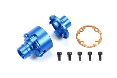

Default New parts announced
Full aluminium diff housing - Tamiya #42324
Also good for TB04Pro/Pro V2/R, TB EVO 6 (MS), TB EVO 7.
Source: Facebook - Mokei Kagaku

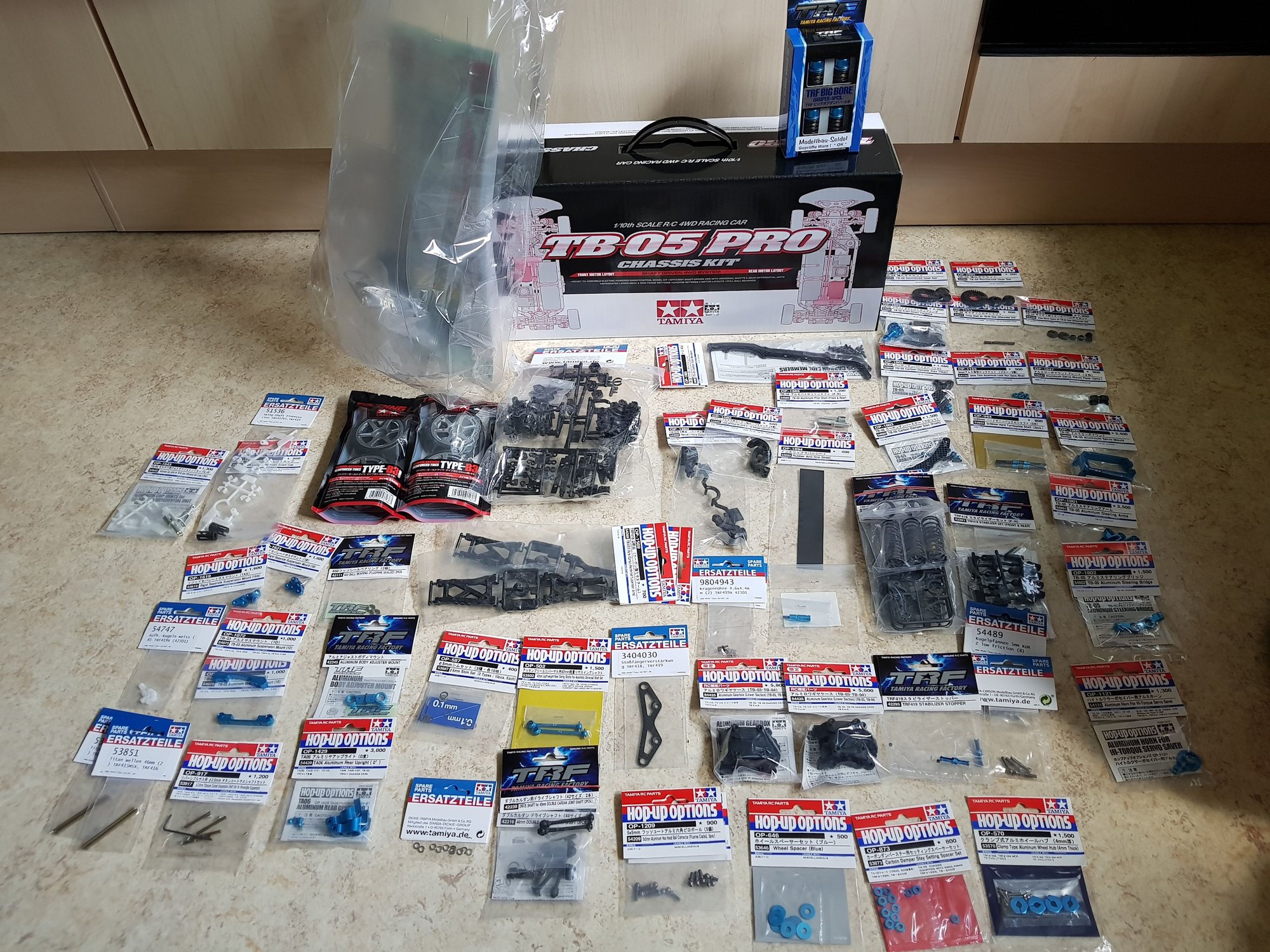

Default How you recognize that you are a Tamiya addict...
Finally released in Germany.
Sorry, but I couldn't withstand!
Chassis will be a full-op with some cross carrying parts...
Buildt review later on...

Where did you find those alum gearboxes from??? Or are they from your own private stash??

Private stash. I originally bought them in a RC shop in Poland, when i saw them. I think, they are one of the last one's in Europe.
Tamiya #84425

What's the point of buying a TB05 and an infinite quantity of options instead of buy an Evo7 directly?

I have already an Evo 7...
And I did not bought every hop up. I've a huge Tamiya spare parts inventory, which I use partially now for this chassis.

Tom is an ultra fan of Tamiya. That is a beautiful picture man!

When you make good money some people collect nice things lol!
