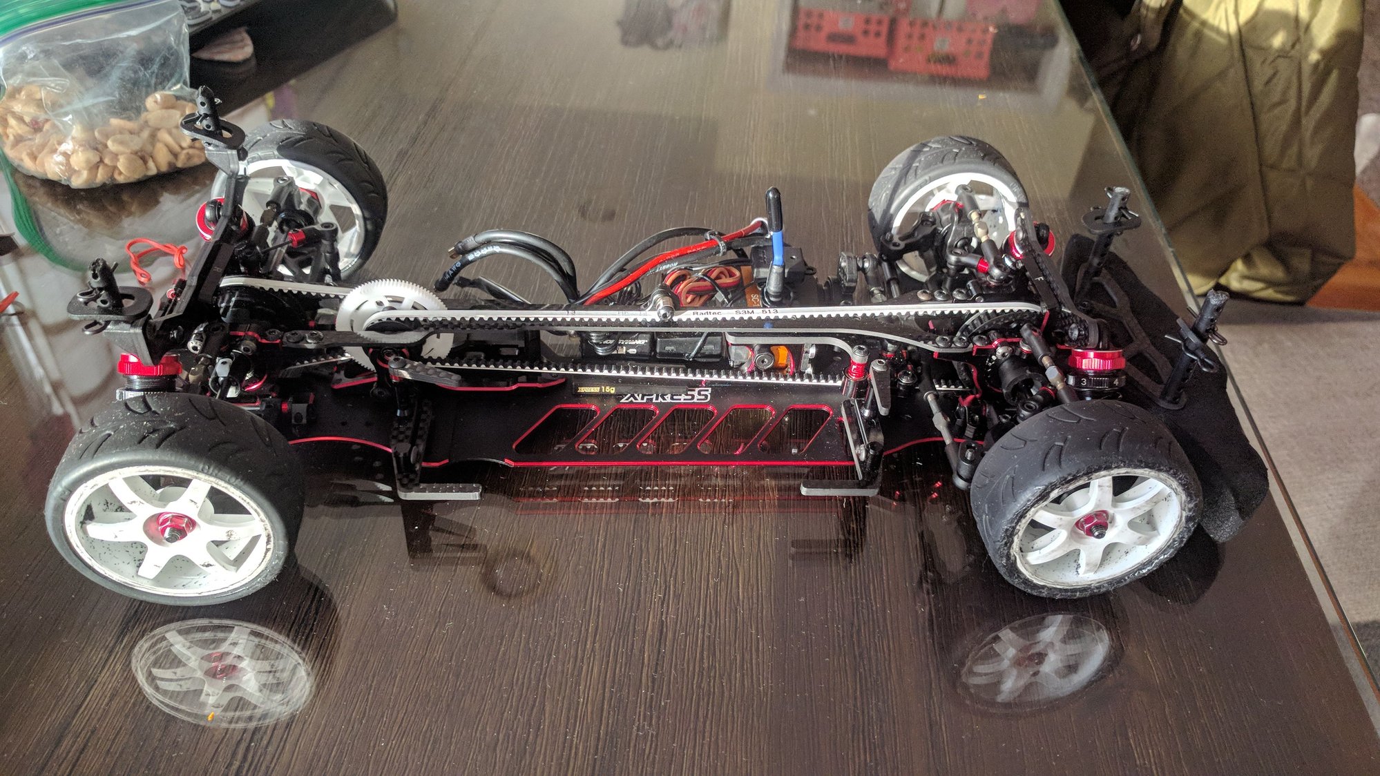

Hi, this is my Xq1s from Singapore.
Is that a single belt conversion?
s14_tat is offline
Old 03-23-2019, 10:34 AM
  #506
Hua
Join Date: May 2007
Location: Singapore
Posts: 489
Yes, custom
Hua is offline
Old 03-23-2019, 10:43 AM
  #507
Join Date: Sep 2018
Posts: 145
Yes, custom
What are the advantages? I know in theory it is suppose to more efficient but there are so many tight bends in the belt.
s14_tat is offline
