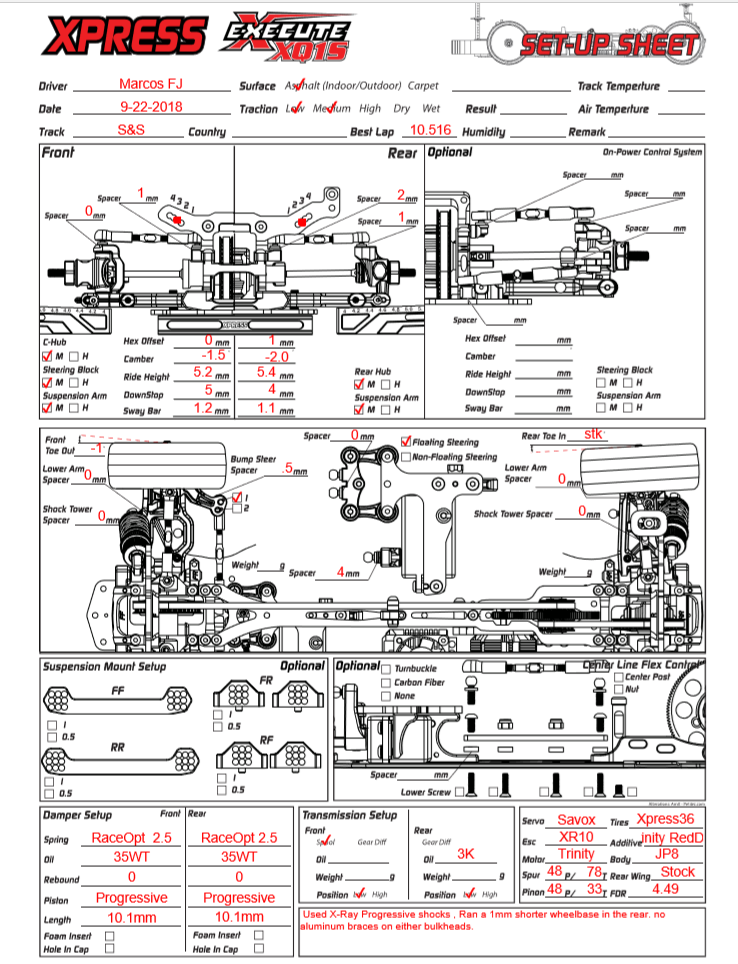

Here is what a got so far running the car for the First time , little mishap in the Main due to the lack of marshals but the car was very good. I shaved a little bit off the front rear arm mounts to be able to run a shorter wheelbase and helped tremendously in the tight "S" section of the track. Used Progressive Xray shocks with RaceOpt 2.5's springs , the stock shocks are good these just felt better for me. I was able to click the fastest laps today in qualifying and in the Main. Great car for the money. Thanks Bartolo for the kit .
File Type: pdf

car looked great
