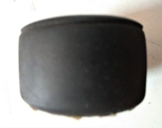

Old 05-14-2018, 05:21 PM
  #355

Originally Posted by Holmestead View Post
Can you please elaborate on what the ring of death is? Cheers!
Ring of Death is the ring that forms from the tire folding over on itself while cornering. It appears either on the inside or outside edge of the surface of the tire getting deeper and deeper until it finally breaks through to the foam insert. In my experience, this only happens on the rears.
The ring appearing at the inner tire edge of the rears as they wear out. The below picture shows a tire which is almost done (can run probably another 10 min practice depending on the asphalt roughness and track temp)
