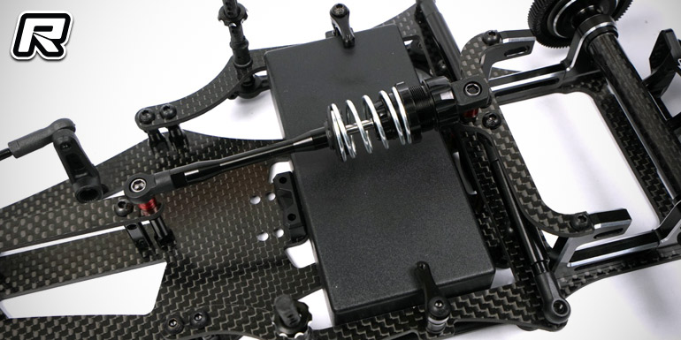

The front end design of VBC is obsolete - has not been improve for the last 3 generations. I have the FX18 and while there are some good ideas the overall design is not streamlined. For example - how someone could suggest to have the front pivots for the side links fastened at the upper end just by the plastic body stand??? I know, acctually noone does it the suggested way, but just suggesting this is king of fishy.

I like my F1 chassis like I like my women, slim and not dragging their sides
In all seriousness, the side links are attached to the upper link to avoid dragging them on the carpet I assume. Roche does something similar with their side links on their F1 Evo. They don't attach it to the upper link but they do raise it with their unique system which allows a slimmer chassis. On black carpet, when cornering hard the sides seem to dig in more with my previous F1s (FX, FMX from VBC). I don't seem to have that issue with the new FX18. Just my 2 cents

Attaching the links from above is legitimate and welcome improvement. I have all my f1 cars like that. The fishy think is fastening the the link studs to the carbon frame with just the plastic body stands as a nut.

The front end works great! Very easy caster and camber changes--don't see that "change" is necessarily improvement. As far as the link mount--yeah--we move our body posts to the battery hold down spot and then use an O ring to hold the batteries and that allows a solid bolt with loctite on the side link. A VERY simple upgrade.
The car works great--- and it's certainly priced right. I was able to pick up the kit for $220 shipped to my house. Good quality parts--the chassis is solid and braced well for flex. Great car. And Eevul's post is correct--the car is nice and narrow and has NO drag issues in the corners. Looking forward to really racing this baby!!
