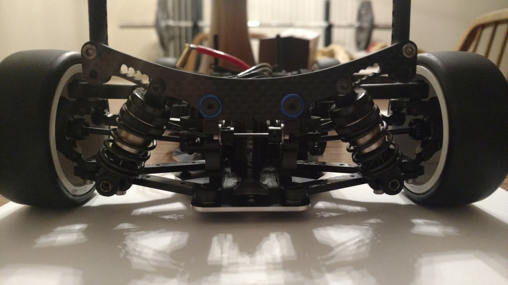

Originally Posted by CristianTabush View Post
ULP are xray, and they are an aftermarket option.
Like thecaptain said, it would be best if you post some pictures of the car and the shocks and towers. I want to be able to see what we are looking at, to give you the correct route to remediate this.
Thanks!
The car has 5.5mm of ride height with the short xray springs threaded all the way up, inside hole on the tower and a middle setting on the arm. It had over 7mm with the kit springs.
It's worth noting that in the front the eyelets of the shocks sit higher, and require some preload on the collars to have proper ride height.
Your lower shock mounts are mounted wrong.
You need to have the round side facing the outside. Here you will mount the shock mount in the second widest setting on the arm and then you will use the outside hole on the shock mount.
try doing this and see if you can get the ride height you are trying to achieve.
Also, you do not have ULP shocks. Those are SLP length with is the kit shocks on all Gizmos now.
i swapped it around and now its okay, i guess the shock mount was more in-board on the arm than it was meant to be in the kit.
