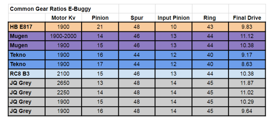

additions and subtractions made to chart
