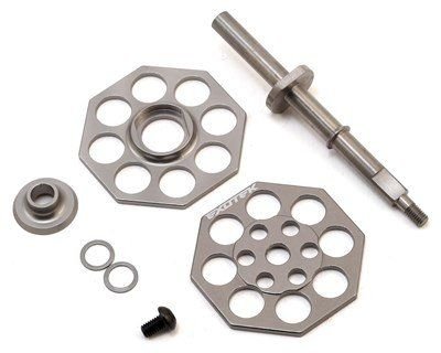

I believe the more modern buggies have the space to run some kind of combination slipper and differential. The crown gear on the diff can be eliminated and replaced by a backing plate which also serves as the slipper plate. Then slipper pad, spur, slipper pad, slipper plate, spring, thrust bearing and nut. One of the outdrives is gonna have to be super long and threaded along part of its length for the nut. And the spur will have to ride on the outdrive. Possibly a third diff carrier and bearing may be needed.
Sir 51D3WAYS is offline
That is how the RC-Monster.com "Slipperential" works -- or worked. It was a fearsomely complex piece of kit to assemble just-right, and it apparently didn't sell well enough to justify continuing to manufacture it after the initial production run. Slippers and diffs are just too complicated to assemble into a single unit, and it's more practical to have them as separate transmission stages, when space allows.
Horatio and Sir 51D3WAYS like this.

RC Monster made a "slipperential".
Sir 51D3WAYS likes this.
