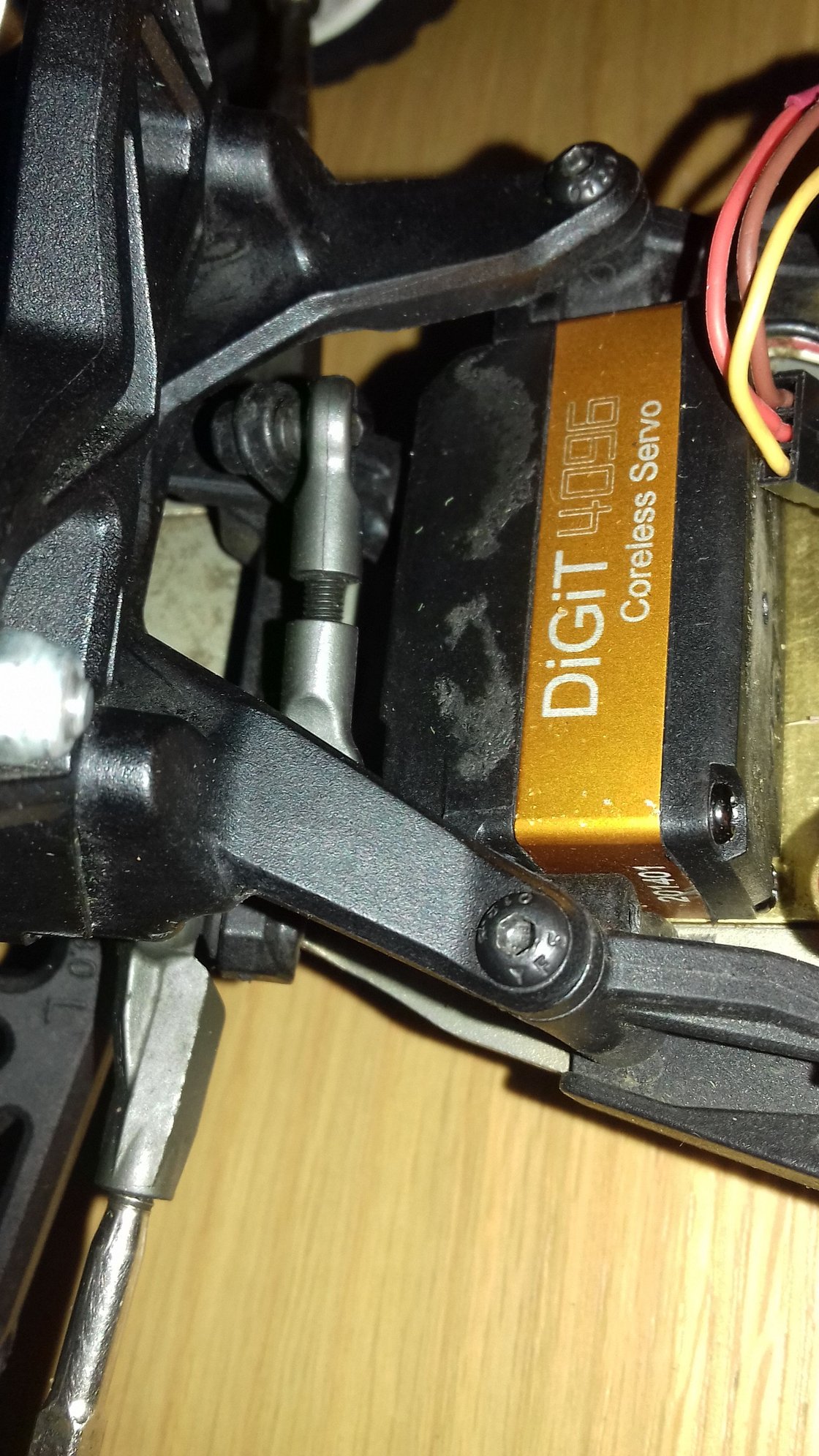

I purchased Tekins 180 lopro servo and was told to use a TLR 25t aluminum servo horn, found one on Amazon and it doesn't fit. Obviously the Tekin servo horn fits their servo so I'm thinking of just running that, only question is will it fit in the car? It's straight, with no bend like TLRs horn and is one hole longer so my initial thought is no, but can anyone verify?
Try it but you might struggle as the tlr needs to go on the servo side of the horn rather than the front
Thanks! I guess I should've prefaced that the car isn't together yet, and this is the first build I've done in years so it's a slow go. That picture helps out a lot though, thanks. I'm wondering if I would be able to flip the ball stud and make it work. The two servo horns seem to match up in that regard. I guess I'll try and see and report back what I find, unless someone who's already done this chimes in!
