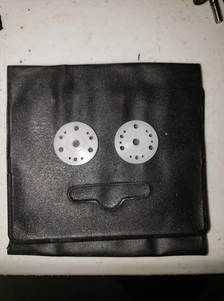

A short update: didn't have time to play with shock holes but I discovered that for some reason the punch / acceleration on the ESC was on the highest setting... Yeah, toning it down did the trick, I can get out of turns without spinning out !!!
:facepalm:
:facepalm:
That should solve ur issue now. Highest I can go is 4 on HW xr8 combo. Usually it is on 3.
It was on 9 on a scale from 1 to 9 lol. 3 is perfect.
