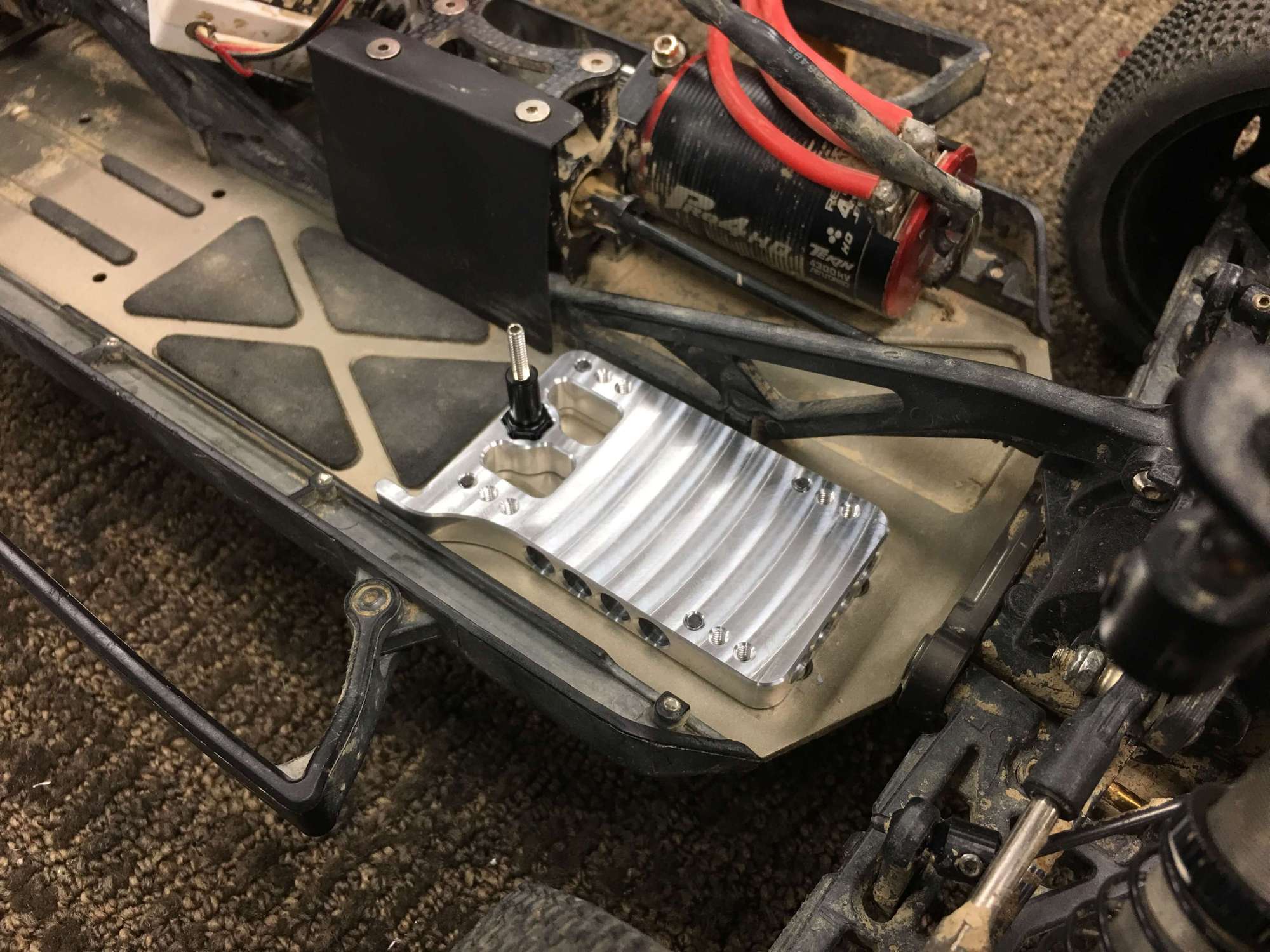

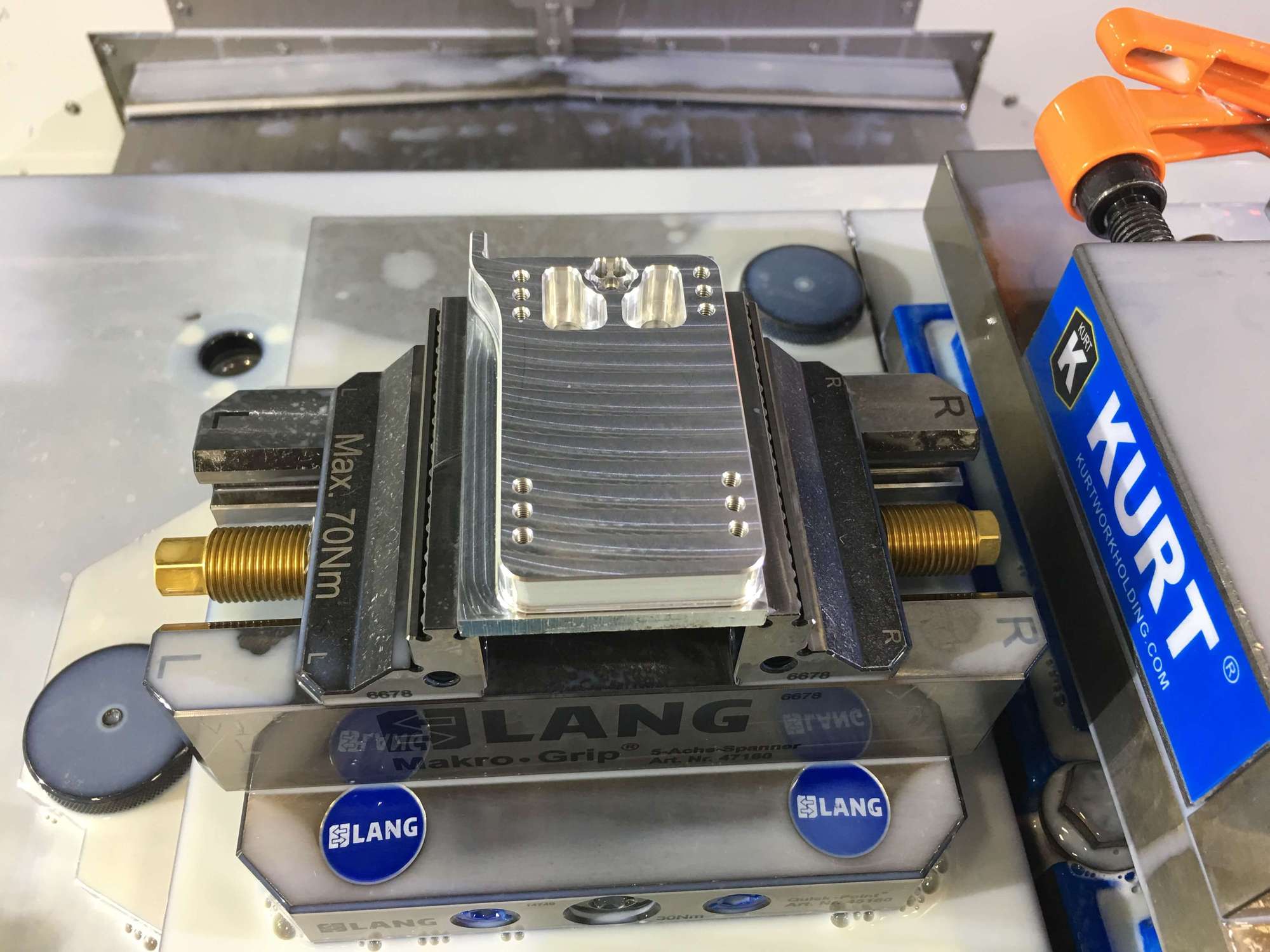

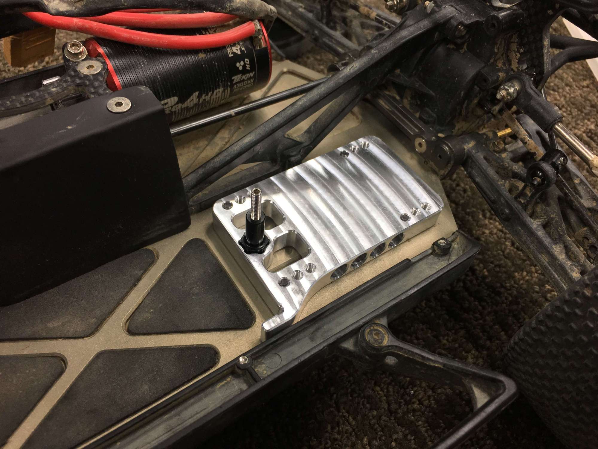

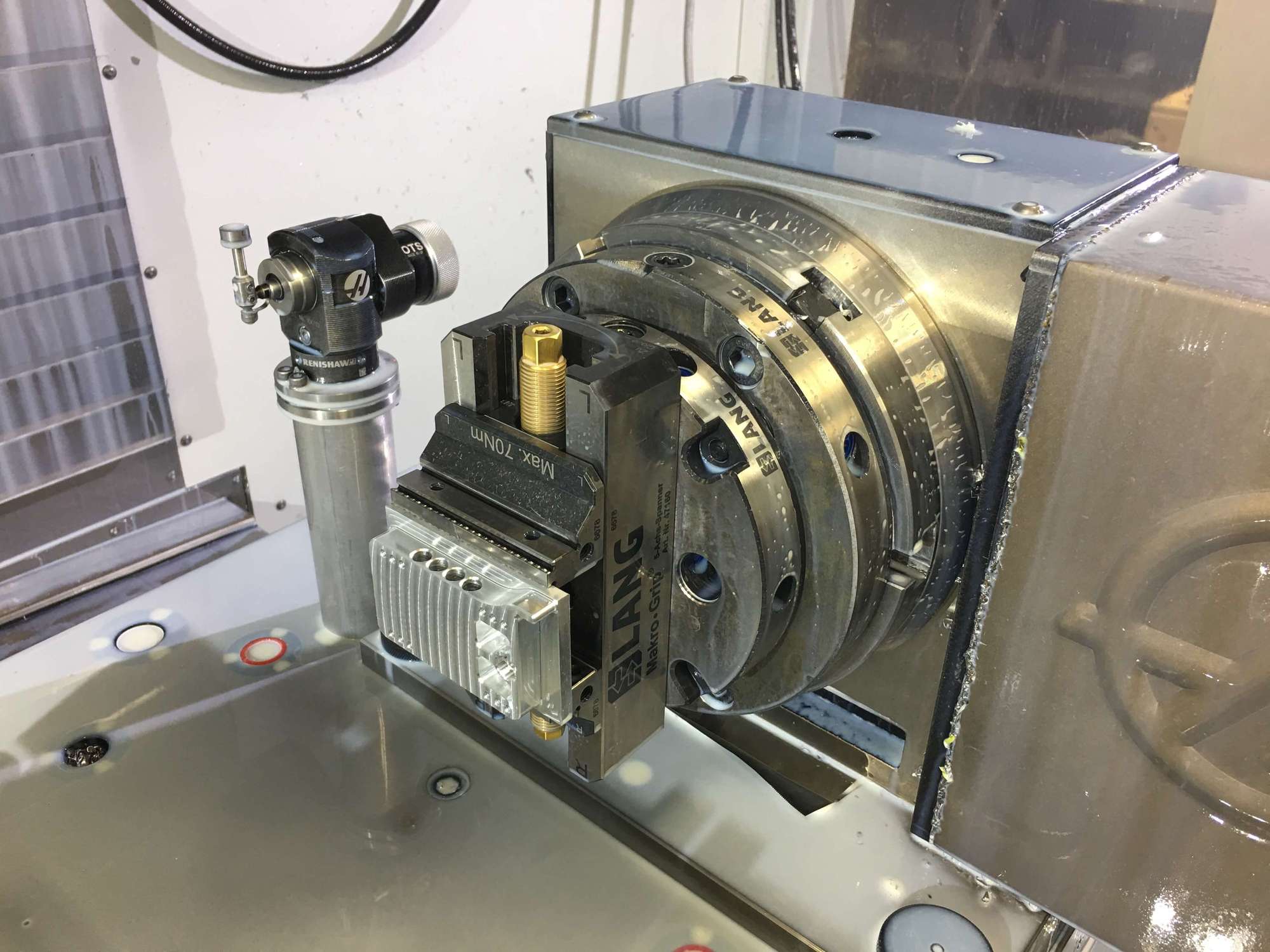

Default CNC Made Battery Block/ESC Mount
My Tekin RX8 Gen 2 fan was squealing, so I went to remove it. Then I noticed with the way I had it mounted with the battery in the front, ESC in the rear that I could not pull the fan out with out pulling the ESC out. This was because the motor and battery wires were on one side and the Center/Rear chassis brace was on the other. So now I have to get out the flathead screwdriver and pry up the esc from the newish double sided clear gel adhesive...
So I figured screw it, I will make a new ESC mount that is removable for easy cleaning and maintenance, but also serves as a battery block. So I made this on our Haas VF-4SS. I hollowed out the inside to make it as light as possible and it was surprisingly light weight. It can be used face up or down, so you can use it to mount the ESC up front or in the rear. It works the same way. In addition to increased ease of maintenance, it also allows you to also mount your ESC in 360 degrees which gives you more mounting flexibility.
Lastly, since it is flat on the top and bottom, your ESC tape should adhere better than having the chassis pockets offering interrupted contact with the ESC. Check it out!!

beautiful work!!! you should sell them!
