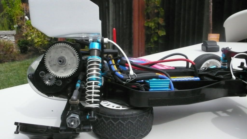

Hello guys, I have 2 DT-02s, well, my kids have them, (see my old posthttp://www.rctech.net/forum/electric...-year-old.html) and i got a 3rd chassis for me to play with them.
I was looking at the gears myself, and i started to think of replacing the spur gear and shaft, but found this gem!
" Fig7: A counter-gear consists of three parts. TA05's aluminum spur gear holder, stainless 16T gear and TRF415MS's shaft."
http://www.tamiyaclub.com/showroom_m...d=60259&id=418

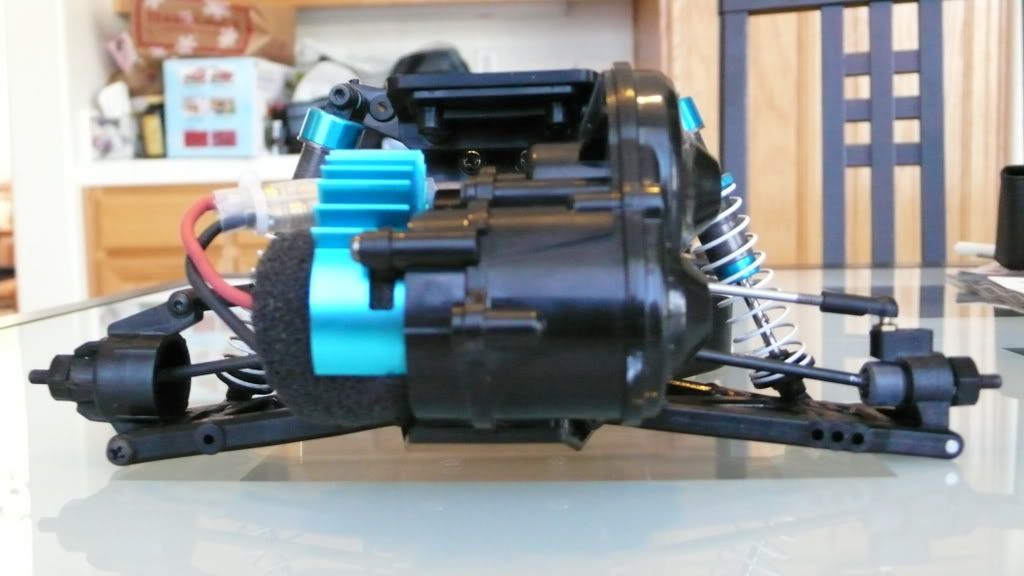

I have more modifications coming for my DT-02
The rear suspension arms, and hubs from the DF-03 will be installed, to replace the brittle DT-02 parts, and to extend the suspension arm geometry.
I found these pics
I am looking for a shaft that will work with the gearbox so i can install a Spur gear to play with the ratios. I have the lightweight DT-03 gear shafts that are 5x45, and hollow, but is there a 5mm outside diameter, and 3 mm inside diameter bearing?
Also planning on extending the wheelbase by 10mm with carbon fiber parts on the front of the car.
If anyone is asking why bother, well, why not? lol
