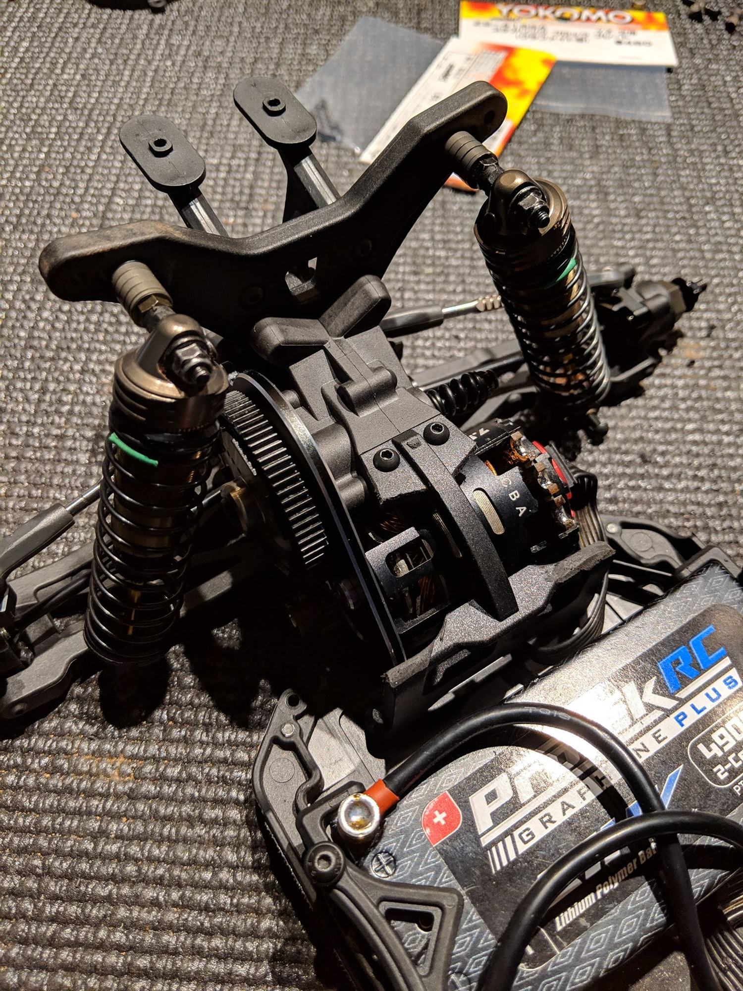

for those of you who run outside on a lower grip track, this is the mod that Lee Martin used in Reims at the Euros in 2018
More pics as well as part list and details here: https://www.facebook.com/groups/yoko...4996070624736/

Since I had to order the yz2T front shock and the new LCG trans from overseas, I ran a club race with the new lower shock towers only. Buggie was not much better just a little on certain parts of the track like the whoops. When I got all the parts in, the car came alive. so much faster in the turns. I ran personal best lap times and qualified directly into the A main. I could not be more than happy with this new setup.

So I pulled the trigger and ordered all these parts to do this conversion. I have been disappointed lately with the way my car has been handling at the track. I strictly race on High grip Astro Turf. I have noticed some good feedback from this conversion. Last night at a club race I had the opportunity to try this conversion out. I didn't know what to expect just that I hoped it would make the car a little better. I just haft to say that I am extremely happy with this conversion. It totally changed the handling for the better. I set personal best times and was able to hang with the fast guys at the track. More corner speed and handles so much better. I couldn't have been more happier. I cant wait for next race day.
For all current YZ-2 Series vehicles, these parts are needed to do the conversion:
Z2- 302TLC-LC Transmission Case
Z2-302CT-Gear Box Cap / Diff Height Adapter for YZ-2T
Z2-304T-Aluminum Motor mount for YZ-2T
Z2-300RFT-Aluminum Rear Suspension Mount (Front) for YZ-2T
-2mm front and rear shock towers.
Front shocks from YZ2T used in the rear.
YZ2T battery conversion
Z2-118T-Battery holder / Radio Tray for YZ-2T
