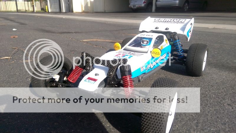

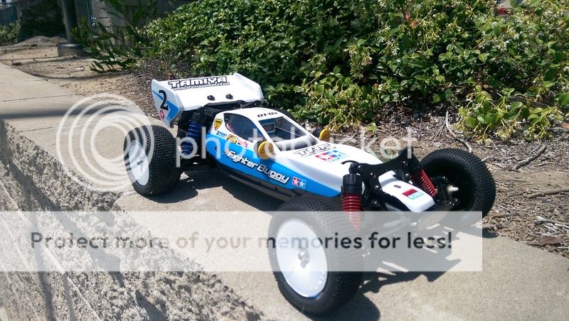

Default i got a dt03!
just bought from CTRJ
[IMG][/IMG]just bought from CTRJ
http://s390.photobucket.com/user/hbc...G1410.jpg.html
