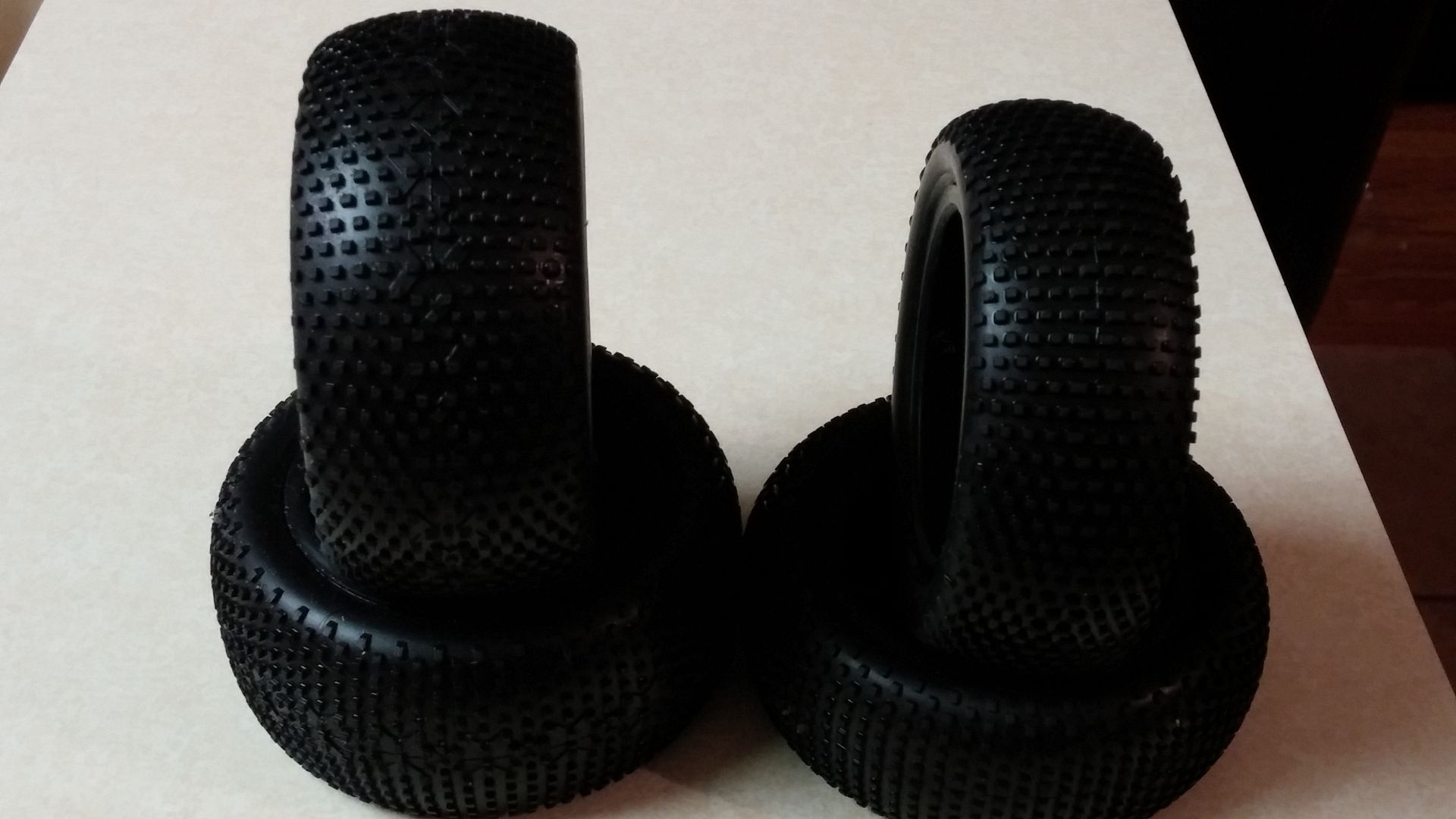

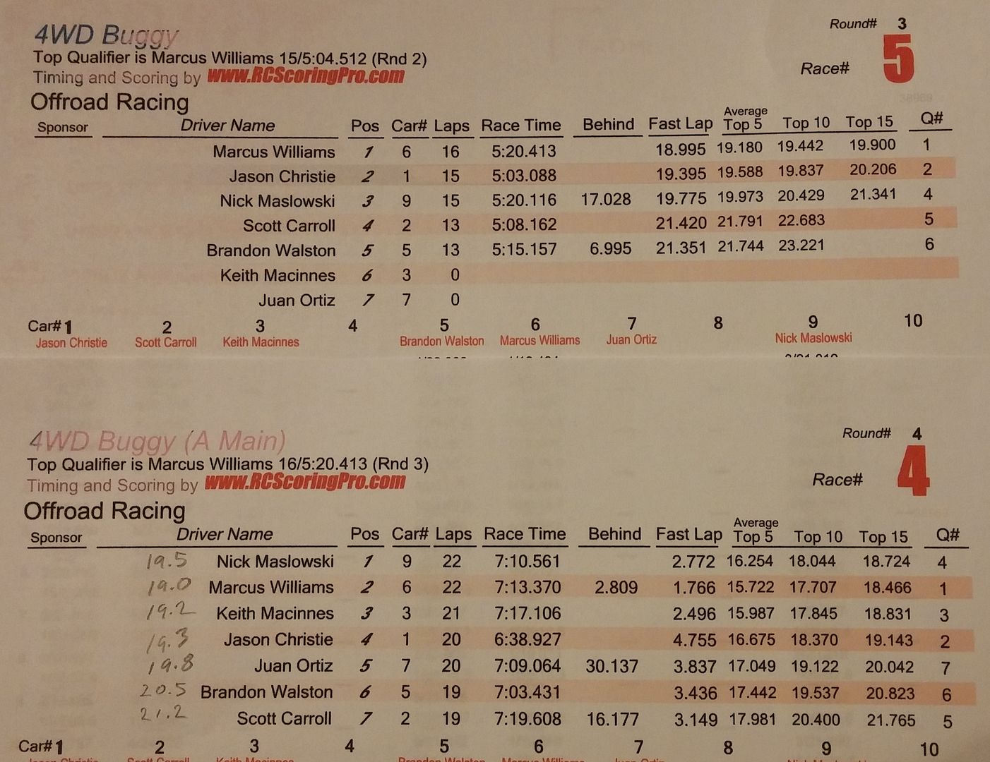

We had a grand opening on a new track yesterday. it is a 1/10 only track and has great grip. TM4 dominated qualifying with the only car to run in the 18's as well as 16 total laps! I even ran the TeamC tires which were killer but right before the main it started to drizzle which made the dirt stick to the tires, i managed to pull off a second place finish and would have been first but got caught up in lap traffic while battling with the leader! I ended up raising front roll center all the way and lowering rear roll center all the way. doing this dropped 3 tenths off of my lap times. I am starting to think the car needs some flex in the chassis and will make some new upper decks to see how it feels next time out.

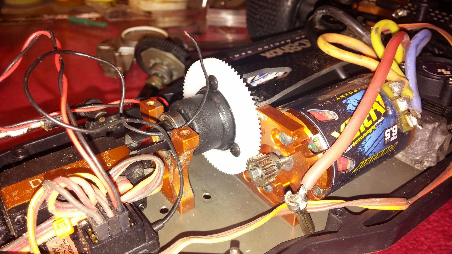

So i am sitting here drawing up some upper flex decks and then it dawned on me that the CVD lengths needed for the center dif are standard lengths off of different teamC vehicles! so i found a 105 and 63mm. Since i am going to make upper decks anyway i think i can convert my TS4 center dif to fit on the TM4!! the only tricky part is the actual spur gear but i can machine that too, i may have a temporary center dif by this afternoon!!

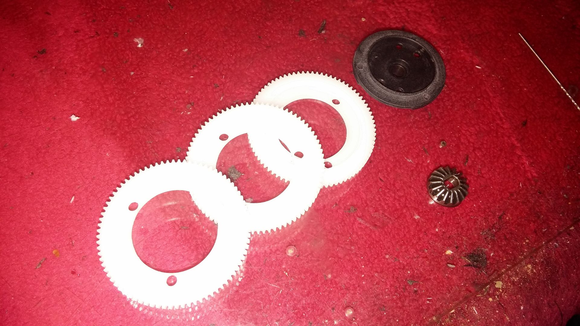

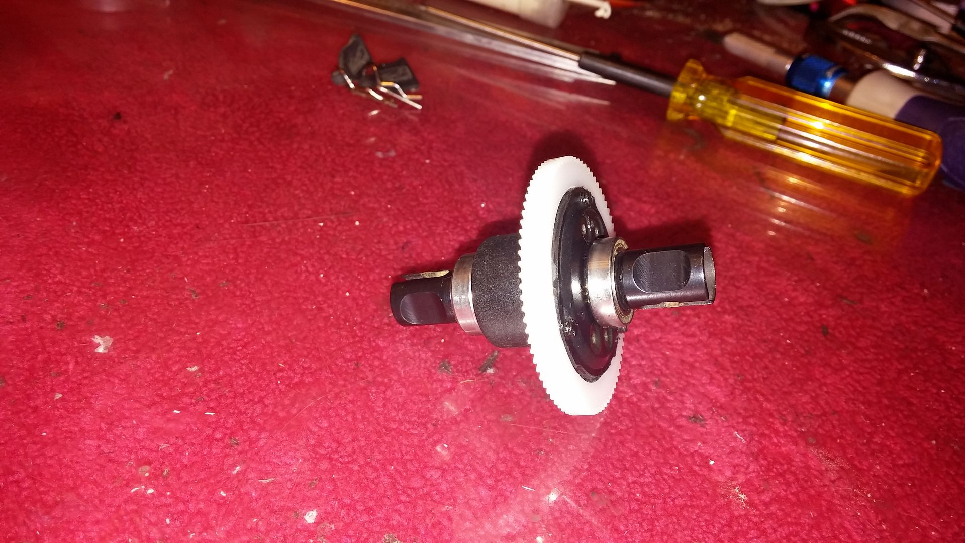

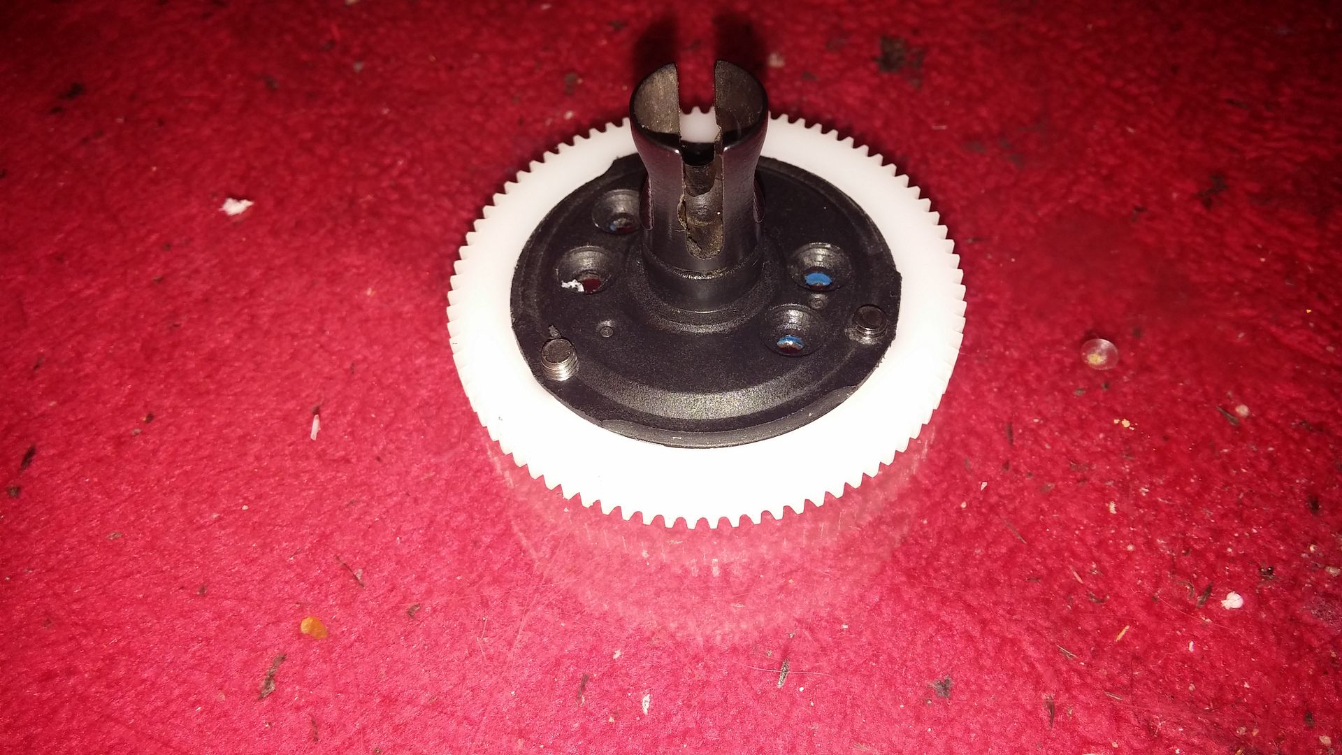

Well good news is that i got most of it done except for the upper deck but bad news is that the 74mm front shaft will not be available until next month (which is probably the same time the dif will be released). I thought it was supposed to be 63mm but thats too short. I took the TS4 spur gear machined it down and then designed some cool looking billet delrin 48p gears. the 2 pc design is cool because if you manage to strip a gear you can replace it without taking the dif apart. Not sure how the factory unit is going to be designed, maybe its the same way. I am not selling any of this stuff, 4w mod is getting serious around here and i need to lay the smack down!! Not sure how I am going to figure out the front shaft issue yet , may have to do some TIG welding on a shaft!!
