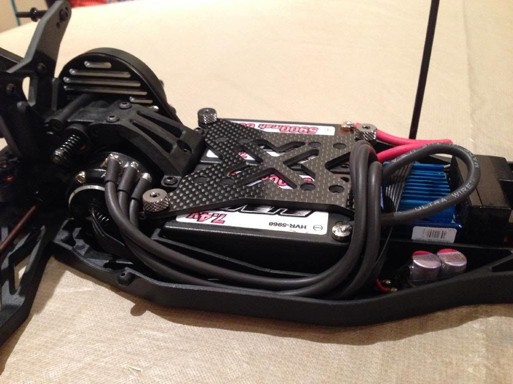

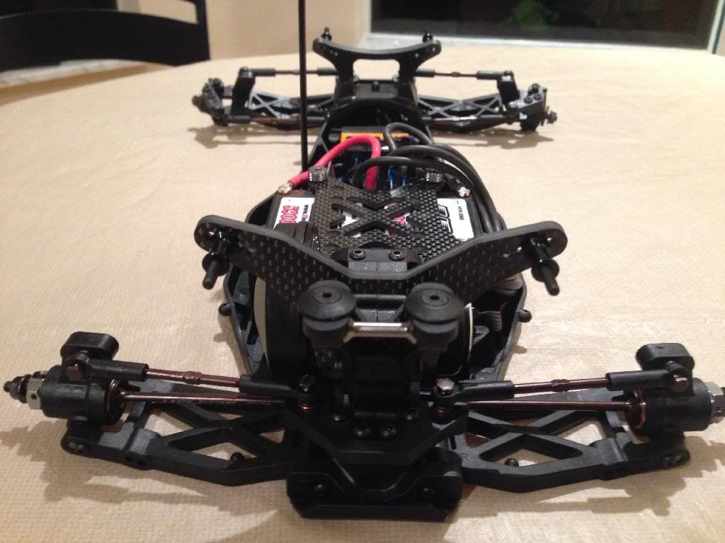

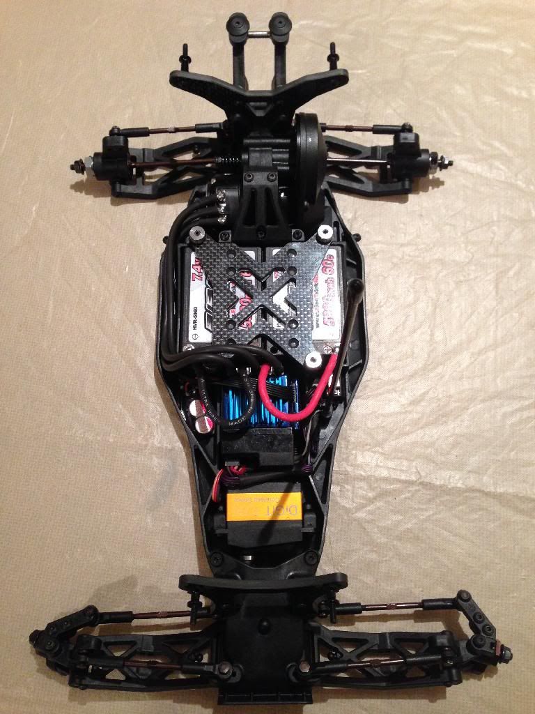

Just need to finalize the wiring, build the shocks and paint the shell. Save that for tomorrow
MORE PICS HERE
