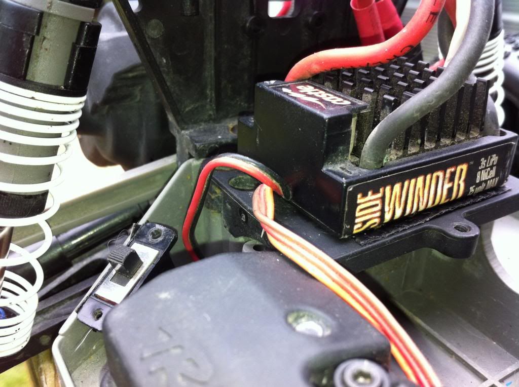

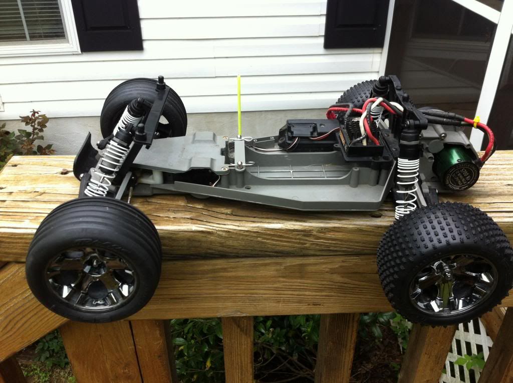

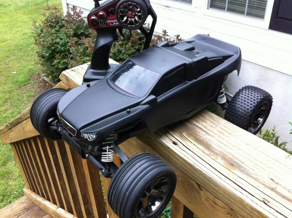

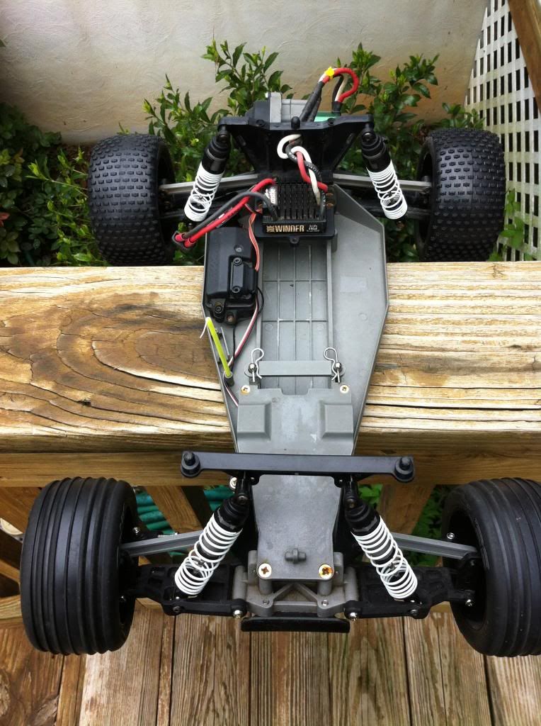

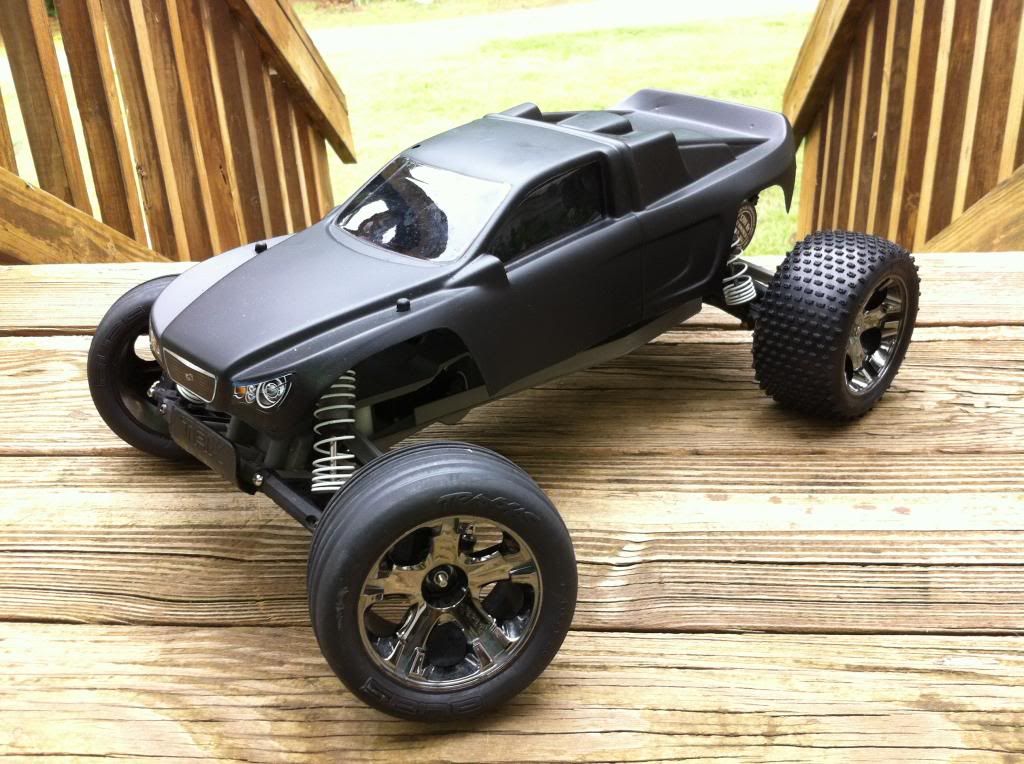

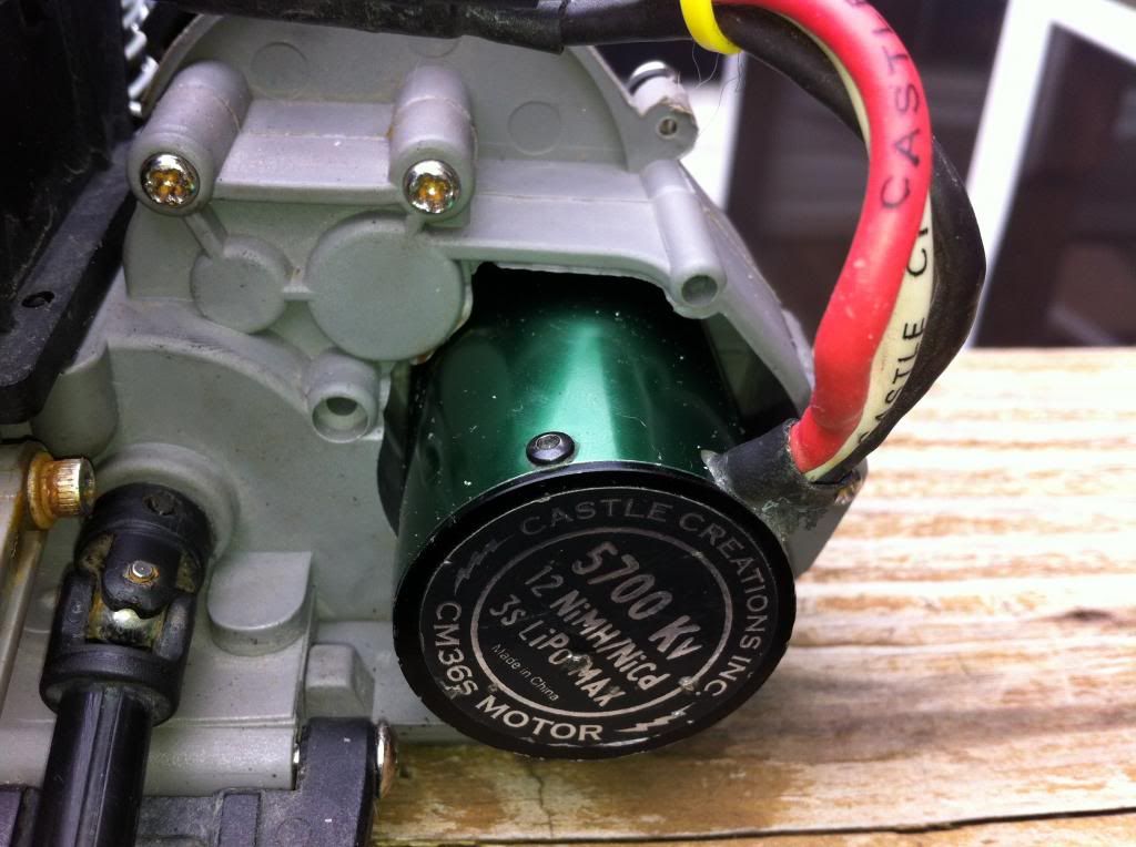

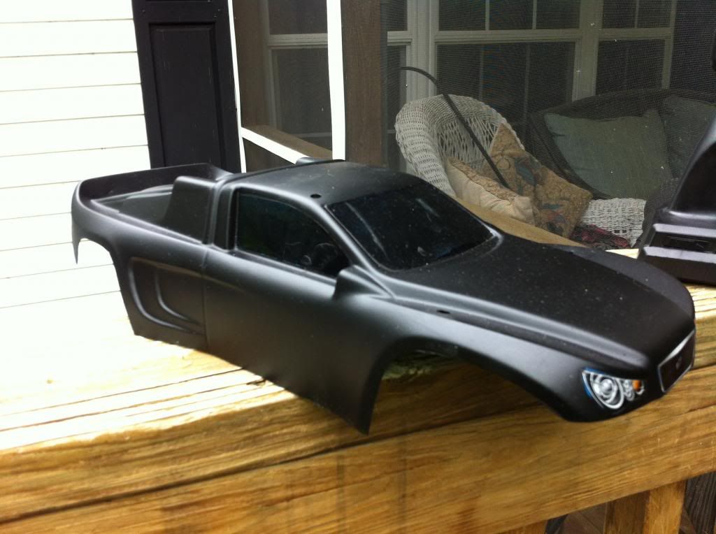

I picked up the roller at a swap meet for 20 bucks, My cousin gave me a used set of wheels and tires for it along with the RX TX so no money spent there, I wet to the LHS and got the wheel hexes and nuts to hold the wheels on, about 12 bucks there, I had the Motor and ESC laying around from a car that has been long gone so I threw it in. The body belonged to a friend that had gotten a new body. The body wasn't in bad shape but the paint on the inside was flaking off really bad so I taped off the windows and the headlights and grill and gave it a good sanding on the outside of the body and laid down a hotrod matte black pait job. After everything I think I have spent a total of maybe on the 40 to 50 dollar range to get it up and running. It aint pretty but what do you want for going from nothing to a RTR car in 3 days. lol I hope I get the pics to work. Let me know what you think.

Running that motor in it u are gonna loose the idler gear(if it isn't metal) and those drive shafts are going to spin off as well, so u might wanna look into some metal outdrives and some steel shafts
And a very nice body for a cheap paint job haha
