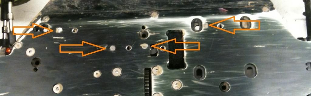

Elite RC D8 motor mount With the Elite RC motor mount, make sure you use the D812 kit supplied 1mm washers placed under the diff assembly to prevent the spur gear from sticking out of the chassis bottom. See attached photo, Red ovals are the washers need, and blue lines indicates to dremel flat the side tabs on the washer to fit under the Elite RC motor mount.

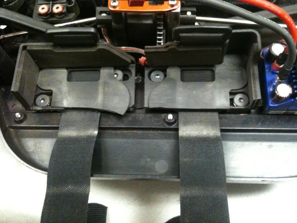

RC monster D8 battery tray

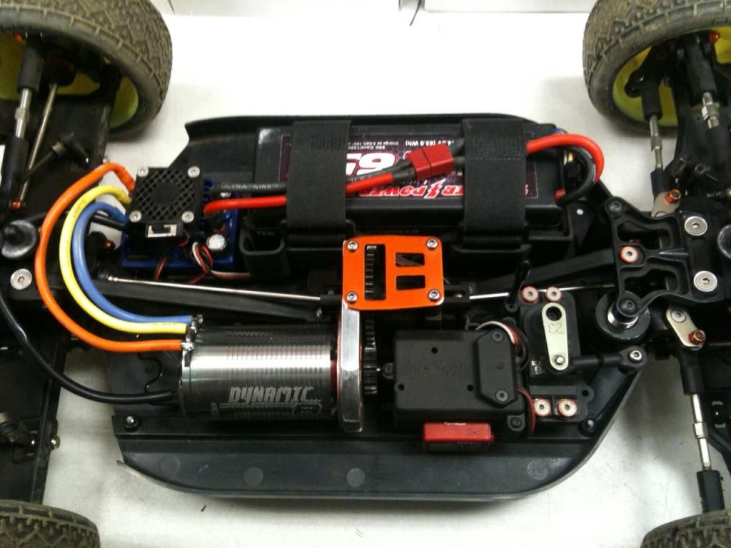

All done!! well I decided to try mechanical brakes so we will see if it will drive like the nitro. Also need a extension wire for the servo, longer motor wires and the ofna servo horn to match the front.

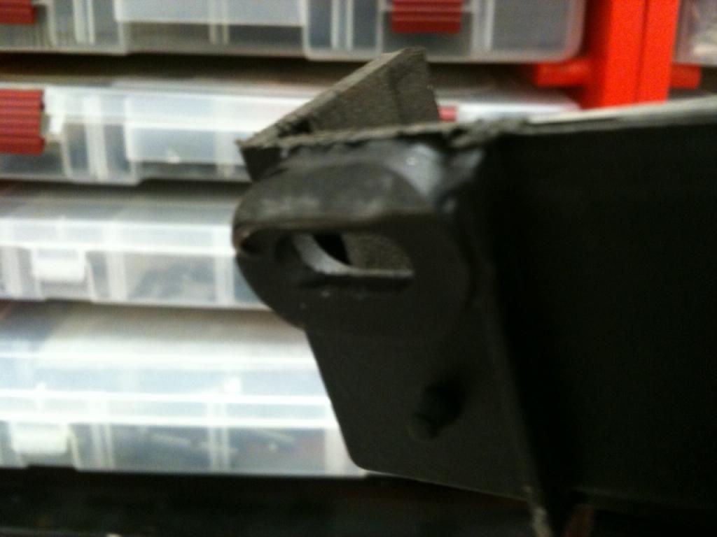

Rear of the chassis notch at the very end and removal of droop ear.
Front needs very little, may have to remove some of the droop ear but I chose to leave it because if I cut it off at all there will be no place or way to put the droop screw on the chassis so Im happy the way it is for now.

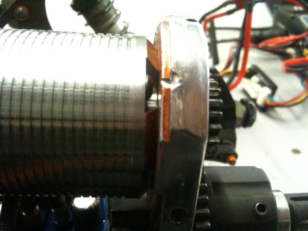

Motor Mount:
The motor mount from the Trophy Flux Series will bolt right up to the diff mounting holes in the chassis. The only mod you will need to do is cut at the lower curved section towards the stone guards as this get in the way of the screw that secures it. I went ahead and shaved off most of the excess sections of the mount that are not needed to try and make it lighter. Also the little wire hold down tab was removed to not interfere with the battery box, and keep things more center lined. You will also need to use the bottom diff spacer from the original diff, this will prevent the spur from poking out of the chassis. If you use a 46 or lower spur you should be good to not use them.

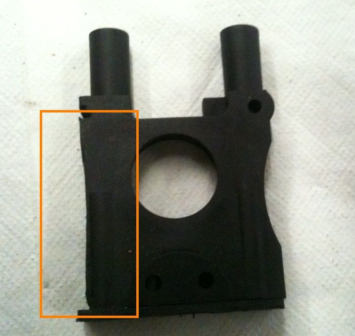

Center Diff Housing:
In order for the front plastic diff housing to fit with the RX box, the section that has a taper needed to be removed.
Battery Holder:
This is probably the hard part as you will need to drill and tap the chassis for this to fit. Drill used was a 4.2, and for the Tap I used a M5x0.8. If you can’t get a 4.2 drill bit you can also use a #19 drill bit. Place the tray in the desired position on the chassis. I went as far forward as possible to have better steering. You can place it in any position on this side of the chassis. But keep in mind that you will need to leave room in the rear for your ESC. Once you line up the holes on the chassis, check the bottom of the mounting holes on the chassis vs. the raised sections in the chassis. You might need to dremel off some material in the sections that are interfering with having the battery tray sit flush on the chassis. Once you have your final position, mark where the holes are going to be. Drill and tap the holes for the M5 Screws to go into the tray and into the chassis, just like how the Vorza has its setup. You might have to add several washers to each screw in order to not have them sticking out of the bottom of the chassis. ESC is mounted using double amount of servo tape. 3M double sided tape from Home Depot works great.
Also cut battery holder in half to keep it more centerline, and not interfere with the stone guard.

Motor Mount:

Finally done. Here's the electric conversion. Wiring was actually not too difficult at all.
